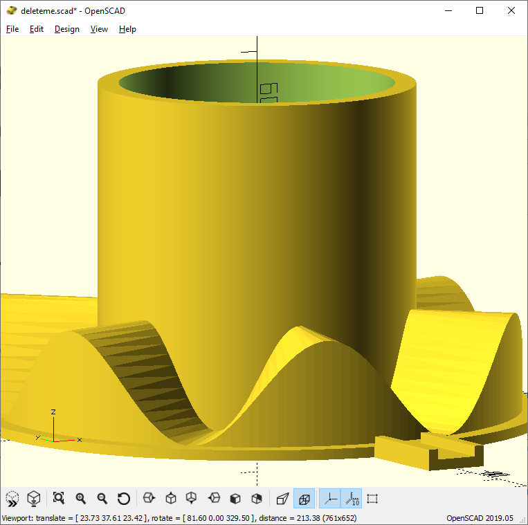

The difference operation seems to require a lot of computations sometimes so
I've created both parts involved as two different .stl files and made the
difference in a separate program.
However here is a typical code which takes ages to be rendered. If you see
any possible improvement let me know. The shape to be rendered is displayed
below.

Use 2D as much as possible to avoid 3D difference(). E.g. don't subtract
cylinders, linear extrude a difference of two circles.
Similarly for the two channels, linear extrude the difference of two
squares.
Don't set $fn if you are 3D printing. Set $fa and $fs. I use $fa = 6 and
$fs = 0.25. Sometimes I lower $fa to 1 to when milling.

Setting $fn to 360 is an obvious culprit, but it's not the real problem.
There's another segment that seems to be doing too much work. (And is
also harder to understand than it needs to be.)
On 6/15/2020 4:09 AM, amundsen wrote:
degres = 360;
for ( i = [0:1/3:degres * 9]) {
a = [sin(i/3) * (enclosure_radius-global_thickness), cos(i/3) *
(enclosure_radius-global_thickness)];
d = [sin((i+1)/3) * (enclosure_radius-global_thickness), cos((i+1)/3) *
This steps around the circle three times.  The second and third times
are identical to the first and can be eliminated.
It would then be stepping from 0 to 3*360 by 1/3.  The multiply-by-3 is
cancelled by the divide-by-3s in the body, making the whole thing
unnecessarily complex.  The effect is to step around the circle by 1/9
degree increments; it could do that directly, eliminating all of the
divides.
Net, this is building 9720 linear-extruded blocks 2/3 of which are
redundant.
After eliminating the redundant blocks, you'll still have 3240 of them.
That's a lot.
I'd have to figure out how big the stair steps involved really are to
know if you need that much resolution.  But assuming for the moment that
you do, you still probably don't need it all the time.  You could do
much of your work at much lower resolution, and only render at full
resolution when you're ready to print.

A more advanced answer might be to stop using linear_extruded blocks -
which have flat tops - and instead use polyhedra.  With a polyhedron you
could have a top that slopes, which will more naturally fit the sine
wave that you're trying to generate.  You could probably get away with
many fewer steps that way.  It looks like 1-degree or 2-degree steps
might well be fine
Here's a variation that renders in ~90 seconds for me, versus >10
minutes for even a simplified version of the original.  And the fidelity
is pretty good, maybe even better than the original.  I had to guess at
a value for enclosure_radius; the original didn't provide one.  Dropping
precision to 60 takes it down to 42.  Setting step to 5 and precision to
60 makes it render in 25 seconds.  The fidelity there is probably not
good enough for production, but is probably good enough for
pre-production work.
Somebody should check my polyhedra.  My 3D geometry isn't quite good
enough for me to be sure that the "top" isn't really a quadrilateral,
that it really does need to be split into two triangles.

            [0,1,3,2],
            [4,5,1,0],
            [0,2,6,4],
            [5,7,3,1],
            [2,3,7,6],
            [7,5,4],
            [4,6,7]
        ], convexity=10);
        cylinder(h = base_thickness, r = enclosure_radius + wall_thickness, $fn =
precision);
cylinder(h = 64, r = enclosure_radius -20, $fn = precision);
translate([0,0,1]) {
cube([wall_thickness * 2 + 4, enclosure_radius * 2 + 2 * wall_thickness
  • 40, 2], center = true);
    translate([5, enclosure_radius+14, 3]) {
    cube([2,20,2], center = true);
    translate([-5, enclosure_radius+14, 3]) {
    translate([5, -enclosure_radius-14, 3]) {
    translate([-5, -enclosure_radius-14, 3]) {
    cylinder(h = 64, r = enclosure_radius - 24, $fn = precision);
A still more advanced answer would construct the entire outer ring as a
single polyhedron, but that exceeds what I want to do today.  (But it
would probably be faster still.)
Setting $fn to 360 is an obvious culprit, but it's not the real problem. There's another segment that seems to be doing too much work. (And is also harder to understand than it needs to be.) On 6/15/2020 4:09 AM, amundsen wrote: > degres = 360; > [...] > for ( i = [0:1/3:degres * 9]) { > a = [sin(i/3) * (enclosure_radius-global_thickness), cos(i/3) * > (enclosure_radius-global_thickness)]; > d = [sin((i+1)/3) * (enclosure_radius-global_thickness), cos((i+1)/3) * > (enclosure_radius-global_thickness)]; This steps around the circle three times.  The second and third times are identical to the first and can be eliminated. It would then be stepping from 0 to 3*360 by 1/3.  The multiply-by-3 is cancelled by the divide-by-3s in the body, making the whole thing unnecessarily complex.  The effect is to step around the circle by 1/9 degree increments; it could do that directly, eliminating all of the divides. Net, this is building 9720 linear-extruded blocks 2/3 of which are redundant. After eliminating the redundant blocks, you'll still have 3240 of them.  That's a lot. I'd have to figure out how big the stair steps involved really are to know if you need that much resolution.  But assuming for the moment that you do, you still probably don't need it *all the time*.  You could do much of your work at much lower resolution, and only render at full resolution when you're ready to print. Something like: step = 1/9; [...] for ( i = [0:step:degres]) { a = [sin(i) * (enclosure_radius-global_thickness), cos(i) * (enclosure_radius-global_thickness)]; d = [sin(i+step) * (enclosure_radius-global_thickness), cos(i+step) * (enclosure_radius-global_thickness)]; f = [sin(i) * enclosure_radius, cos(i) * enclosure_radius]; g = [sin(i+step) * enclosure_radius, cos(i+step) * enclosure_radius]; reference = [0,0]; translate([0,0,base_thickness]) { translate([0,0,0]) { linear_extrude(height = (sin(i * nombre_vagues) * 10)+10, center = false, convexity = 10) { polygon(points = [a,f,g,d], convexity = 100); } } } } and then set "step" to different values depending on what you're doing. Note:  Your blocks were 1/3 degree wide and stepped in 1/9 degree intervals; mine are "step" wide, with "step" intervals. A more advanced answer might be to stop using linear_extruded blocks - which have flat tops - and instead use polyhedra.  With a polyhedron you could have a top that slopes, which will more naturally fit the sine wave that you're trying to generate.  You could probably get away with *many* fewer steps that way.  It looks like 1-degree or 2-degree steps might well be fine Here's a variation that renders in ~90 seconds for me, versus >10 minutes for even a simplified version of the original.  And the fidelity is pretty good, maybe even better than the original.  I had to guess at a value for enclosure_radius; the original didn't provide one.  Dropping precision to 60 takes it down to 42.  Setting step to 5 and precision to 60 makes it render in 25 seconds.  The fidelity there is probably not good enough for production, but is probably good enough for pre-production work. Somebody should check my polyhedra.  My 3D geometry isn't quite good enough for me to be sure that the "top" isn't really a quadrilateral, that it really does need to be split into two triangles. enclosure_radius=50; global_thickness = 20; nombre_vagues = 6; degres = 360; base_thickness = 2; wall_thickness = 4; precision = 360; step = 2; union() { for ( i = [0:step:degres]) { abot = [sin(i) * (enclosure_radius-global_thickness), cos(i) * (enclosure_radius-global_thickness), 0]; dbot = [sin(i+step) * (enclosure_radius-global_thickness), cos(i+step) * (enclosure_radius-global_thickness), 0]; fbot = [sin(i) * enclosure_radius, cos(i) * enclosure_radius, 0]; gbot = [sin(i+step) * enclosure_radius, cos(i+step) * enclosure_radius, 0]; h1 = (sin(i * nombre_vagues) * 10)+10; h2 = (sin((i+step) * nombre_vagues) * 10)+10; atop = abot + [0,0,h1]; dtop = dbot + [0,0,h2]; ftop = fbot + [0,0,h1]; gtop = gbot + [0,0,h2]; reference = [0,0]; translate([0,0,base_thickness]) { polyhedron(points=[abot, dbot, fbot, gbot, atop, dtop, ftop, gtop], faces=[ [0,1,3,2], [4,5,1,0], [0,2,6,4], [5,7,3,1], [2,3,7,6], [7,5,4], [4,6,7] ], convexity=10); } } difference() { union() { cylinder(h = base_thickness, r = enclosure_radius + wall_thickness, $fn = precision); cylinder(h = 64, r = enclosure_radius -20, $fn = precision); translate([0,0,1]) { cube([wall_thickness * 2 + 4, enclosure_radius * 2 + 2 * wall_thickness + 40, 2], center = true); } translate([5, enclosure_radius+14, 3]) { cube([2,20,2], center = true); } translate([-5, enclosure_radius+14, 3]) { cube([2,20,2], center = true); } translate([5, -enclosure_radius-14, 3]) { cube([2,20,2], center = true); } translate([-5, -enclosure_radius-14, 3]) { cube([2,20,2], center = true); } } cylinder(h = 64, r = enclosure_radius - 24, $fn = precision); } } A still more advanced answer would construct the entire outer ring as a single polyhedron, but that exceeds what I want to do today.  (But it would probably be faster still.)
amundsen
Tue, Jun 16, 2020 6:53 AM
Thanks a lot @JordanBrown!
The first version without polyhedron is still quite slow but it might be in
part because I have an integrated GPU only.
The second version is indeed much faster. I need to analyze the code!
