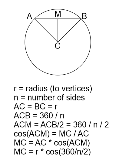

Tue, Jun 16, 2020 4:15 PM
Caution:  depending on the exact parameters, I'm sometimes getting
UI-WARNING: Object may not be a valid 2-manifold and may need repair!
I assume that what's happening is that the inside edges of the
individual blocks are interacting badly with the cylinder and sometimes
causing the two to share an edge.  For geometrical/computational reasons
that IMO don't make much sense in reality, that's a big no-no.  But it
often happens when you position things using math.
The best solution is probably to move the inside of the blocks inward
just a little, so that they cleanly overlap with the cylinder no matter
exactly how many sides the cylinder has.
That is, something like
nudge = 1;
abot = [sin(i) * (enclosure_radius-global_thickness-nudge),
    cos(i) * (enclosure_radius-global_thickness-nudge), 0];
My math says that for a 60-sided cylinder the radius to the center of an
edge is 99.86% of the radius to the vertices.  In theory, a correction
of 0.2% of the radius should be enough to make them overlap.  However,
since the cylinder is 20 units thick, we don't need precision -
adjusting it inward 1 unit is fine.
Here's the math, if anybody is interested.
Note:  this drawing is a bit poor in that I used 45 degree angles and so
it happens that ACM and CAM are both 45 degrees and AM = CM.  In the
general case they won't be equal like that.
Caution:  depending on the exact parameters, I'm sometimes getting UI-WARNING: Object may not be a valid 2-manifold and may need repair! I assume that what's happening is that the inside edges of the individual blocks are interacting badly with the cylinder and sometimes causing the two to share an edge.  For geometrical/computational reasons that IMO don't make much sense in reality, that's a big no-no.  But it often happens when you position things using math. The best solution is probably to move the inside of the blocks inward just a little, so that they cleanly overlap with the cylinder no matter exactly how many sides the cylinder has. That is, something like nudge = 1; abot = [sin(i) * (enclosure_radius-global_thickness-nudge), cos(i) * (enclosure_radius-global_thickness-nudge), 0]; My math says that for a 60-sided cylinder the radius to the center of an edge is 99.86% of the radius to the vertices.  In theory, a correction of 0.2% of the radius should be enough to make them overlap.  However, since the cylinder is 20 units thick, we don't need precision - adjusting it inward 1 unit is fine. Here's the math, if anybody is interested. Note:  this drawing is a bit poor in that I used 45 degree angles and so it happens that ACM and CAM are both 45 degrees and AM = CM.  In the general case they won't be equal like that.
amundsen
Wed, Jun 17, 2020 7:43 PM
Thanks a lot @JordanBrown for the explanation on how to deal with the
"non-manifold" issue. I've never had such a warning in Openscad but it
happened in my slicer and now I understand where it came from!
Good to know the GPU doesn't play a role when rendering too!

Wed, Jun 17, 2020 9:15 PM
The simplest example is two cubes positioned corner to corner:
cube(1);
translate([1,1,0]) cube(1);
but you can encounter it in any number of circumstances.  In this
particular case, I believe the vertical edges of the central cylinder
(which is really an extruded polygon) were periodically lining up with
the vertical edges of the inner sides of the blocks that form the sine wave.
That's not really a surprise, because:
  • The cylinder probably has a number of sides that is an exact
    multiple of one degree, and
  • The outer blocks are spaced exact multiples of one degree, and
  • The inner edges of the blocks are positioned exactly at the radius
    of the cylinder and so exactly at the radius of the cylinder's
    vertical edges.
