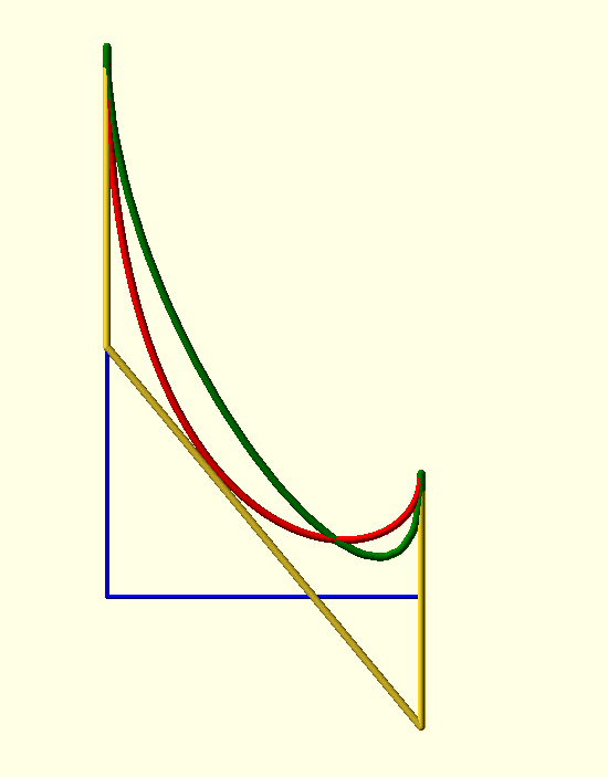

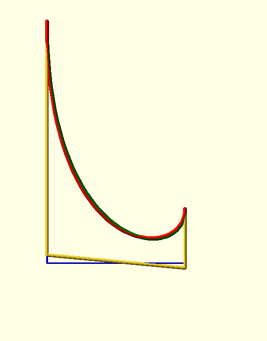

With that function your curve is nearly the same as mine and the energy is
only 0.5% lower.
On 26 December 2017 at 16:47, Ronaldo Persiano rcmpersiano@gmail.com
You are right. The energy function was wrong. At some point, I have made
some change in it.
The correct (I hope) energy function should be:
function BzEnergy(b, n=8) =
let( bs = subdivBezier3(b, n) )
[for(i=[0:3:len(bs)-1]) pow(curvature(bs,i),2)]
*[for(i=[0:3:len(bs)-1]) 1]/pow(2,n-1);
With this function, the plot of the cubic energy as a function of the
balance s has a sharper minimum what is more reasonable.
I will try your data and compare.
2017-12-26 14:21 GMT-02:00 nop head nop.head@gmail.com:
The starting point is:
bzcp=[[0, 0, 0], [0, 0, -125.85], [0, 79.721, -125.85], [0, 79.721,
-108.35]];
length=180;
After I adjust the control points for length I get  [[0, 0, 0], [0, 0,
-139.685], [0, 79.721, -139.685], [0, 79.721, -108.35]]

Here is my curve in red and its control points in blue alongside yours
with my actual geometry. Your BzEnergy function returns 12 times the energy
for mine which is hard to believe because mine has a more distributed
curvature. A strip held against the screen follows mine, not yours, so I
think there must be a bug in your energy function.
On 26 December 2017 at 14:17, nop head nop.head@gmail.com wrote:
Interesting. I will have to combine with my code and put them side by
side. If I put my length and dimension into your code the result looks a
lot tighter and doesn't match what my real strip does.

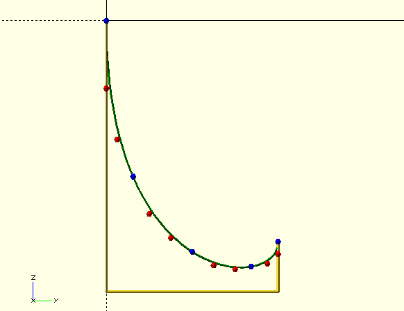

In the experiments I have done with the code, the plot of the cubic
energy against the balance parameter s has the shape of an U with an almost
horizontal bottom. This shows that the effect of medium-sized changes of
the optimal balance does not produce significant changes of the cubic
energy. In special, in your case of a strip going down from a fixed pole to
a moving table clamped point, the optimal balance will change slowly from
0.5 (when the two end points are level) to 1 (when the strip is fully
stretched). That means the balance of the cubic endpoint derivatives in the
optimal solution is slightly favorable to the fixed point if the strip is
never fully stretched. So, your assumption that "keeping the two inner
control points level" would do the trick is not confirmed by my results.

Yes. However the two inner Bezier points are not level when the table
travels up.

The length of the strip is only 9mm longer compared to the version
with the control points equidistant below the end points.
Yes. However the two inner Bezier points are not level when the table travels up. 2017-12-26 14:51 GMT-02:00 nop head <nop.head@gmail.com>: > With that function your curve is nearly the same as mine and the energy is > only 0.5% lower. > > > ​ > > On 26 December 2017 at 16:47, Ronaldo Persiano <rcmpersiano@gmail.com> > wrote: > >> You are right. The energy function was wrong. At some point, I have made >> some change in it. >> >> The correct (I hope) energy function should be: >> >> function BzEnergy(b, n=8) = >> let( bs = subdivBezier3(b, n) ) >> [for(i=[0:3:len(bs)-1]) pow(curvature(bs,i),2)] >> *[for(i=[0:3:len(bs)-1]) 1]/pow(2,n-1); >> >> >> With this function, the plot of the cubic energy as a function of the >> balance s has a sharper minimum what is more reasonable. >> >> I will try your data and compare. >> >> >> 2017-12-26 14:21 GMT-02:00 nop head <nop.head@gmail.com>: >> >>> The starting point is: >>> >>> bzcp=[[0, 0, 0], [0, 0, -125.85], [0, 79.721, -125.85], [0, 79.721, >>> -108.35]]; >>> length=180; >>> >>> After I adjust the control points for length I get [[0, 0, 0], [0, 0, >>> -139.685], [0, 79.721, -139.685], [0, 79.721, -108.35]] >>> >>> On 26 December 2017 at 16:15, Ronaldo Persiano <rcmpersiano@gmail.com> >>> wrote: >>> >>>> Would you mind to provide me the geometric data (endpoint coordinates >>>> and strip length) of this case? >>>> >>>> 2017-12-26 13:32 GMT-02:00 nop head <nop.head@gmail.com>: >>>> >>>>> Whoops >>>>> >>>>> >>>>> ​ >>>>> >>>>> On 26 December 2017 at 15:31, nop head <nop.head@gmail.com> wrote: >>>>> >>>>>> Here is my curve in red and its control points in blue alongside >>>>>> yours with my actual geometry. Your BzEnergy function returns 12 times the >>>>>> energy for mine which is hard to believe because mine has a more >>>>>> distributed curvature. A strip held against the screen follows mine, not >>>>>> yours, so I think there must be a bug in your energy function. >>>>>> >>>>>> On 26 December 2017 at 14:17, nop head <nop.head@gmail.com> wrote: >>>>>> >>>>>>> Interesting. I will have to combine with my code and put them side >>>>>>> by side. If I put my length and dimension into your code the result looks a >>>>>>> lot tighter and doesn't match what my real strip does. >>>>>>> >>>>>>> On 25 December 2017 at 17:31, Ronaldo Persiano < >>>>>>> rcmpersiano@gmail.com> wrote: >>>>>>> >>>>>>>> Here is the code of my atempts to find the cubic with minimum >>>>>>>> energy. >>>>>>>> >>>>>>>> First note that AdjustBezier() finds the cubic with the desired >>>>>>>> length keeping the balance between the norms of the cubic endpoint >>>>>>>> derivatives. The strategy I used in the code was to change this balance in >>>>>>>> order to reduce the cubic energy. >>>>>>>> >>>>>>>> // for any cubic bz, it holds bz == balance(bz, 0.5) >>>>>>>> function balance(bz,s) = >>>>>>>> [ bz[0], >>>>>>>> bz[0] + 2*s*(bz[1]-bz[0]), >>>>>>>> bz[3] + 2*(1-s)*(bz[2]-bz[3]), >>>>>>>> bz[3] ]; >>>>>>>> >>>>>>>> >>>>>>>> For each balance, the cubic is adjusted to the target length by >>>>>>>> AdjustBezier() and its energy is calculated. >>>>>>>> >>>>>>>> function BalancedEnergy(bz, s, l, eps) = >>>>>>>> BzEnergy(AdjustBezier(balance(bz,s), l, eps)); >>>>>>>> >>>>>>>> >>>>>>>> To find the balance that leads to the minimum energy is objective >>>>>>>> of an iterative search. The search for the cubic with minimum energy is >>>>>>>> done iteratively narrowing an interval (s1,s2) of balances that contains >>>>>>>> the best balance. >>>>>>>> >>>>>>>> // Minimum energy Bezier arc with a given length l >>>>>>>> // and given tangent directions at its ends >>>>>>>> function BestBz(bz, l, eps=1e-3) = >>>>>>>> let( bz2 = [ bz[0], // normalize end derivatives >>>>>>>> bz[0]+unit(bz[1]-bz[0]), >>>>>>>> bz[3]+unit(bz[2]-bz[3]), >>>>>>>> bz[3] ], >>>>>>>> s1 = eps, >>>>>>>> en1 = BalancedEnergy(bz, s1, l, eps), >>>>>>>> en2 = BalancedEnergy(bz, 1-s1, l, eps), >>>>>>>> s = _bestS(bz2, l, s1, 1-s1, en1, en2, eps) ) >>>>>>>> echo(smin=s) >>>>>>>> AdjustBezier(balance(bz2,s), l); >>>>>>>> >>>>>>>> function _bestS(bz, l, s1, s2, e1, e2, eps=1e-3, n=15) = >>>>>>>> let( s12 = (s1+s2)/2, >>>>>>>> e12 = BalancedEnergy(bz, s12, l, eps)) >>>>>>>> //echo("in",s1=s1,s2=s2,s12=s12,e1=e1,e2=e2,e12=e12) >>>>>>>> abs(e12-(e1+e2)/2)/e12< eps ? >>>>>>>> e1<e2 ? s1 : s2 >>>>>>>> : >>>>>>>> let( s3 = max(min(parabMin(s1,s12,s2,e1,e12,e2),1-eps),eps) ) >>>>>>>> //echo(s1=s1,s3=s3,s2=s2,e1=e1,e12=e12,e2=e2,n=n) >>>>>>>> abs(s3-s1)<eps || abs(s3-s2)<eps || n==0 ? >>>>>>>> s3 >>>>>>>> : >>>>>>>> let( e3 = BalancedEnergy(bz, s3, l, eps) ) >>>>>>>> //echo(e3=e3) >>>>>>>> abs(e3-e12)/e12<eps ? >>>>>>>> s3 : >>>>>>>> e3<e12 ? >>>>>>>> s3<s12 ? >>>>>>>> _bestS(bz,l,s1,s12,e1,e12,eps,n-1) >>>>>>>> : >>>>>>>> _bestS(bz,l,s12,s2,e12,e2,eps,n-1) >>>>>>>> : >>>>>>>> s3<s12 ? >>>>>>>> _bestS(bz,l,s3,s2,e3,e2,eps,n-1) >>>>>>>> : >>>>>>>> _bestS(bz,l,s1,s3,e1,e3,eps,n-1); >>>>>>>> >>>>>>>> >>>>>>>> The full code is annexed. >>>>>>>> >>>>>>>> In the experiments I have done with the code, the plot of the cubic >>>>>>>> energy against the balance parameter s has the shape of an U with an almost >>>>>>>> horizontal bottom. This shows that the effect of medium-sized changes of >>>>>>>> the optimal balance does not produce significant changes of the cubic >>>>>>>> energy. In special, in your case of a strip going down from a fixed pole to >>>>>>>> a moving table clamped point, the optimal balance will change slowly from >>>>>>>> 0.5 (when the two end points are level) to 1 (when the strip is fully >>>>>>>> stretched). That means the balance of the cubic endpoint derivatives in the >>>>>>>> optimal solution is slightly favorable to the fixed point if the strip is >>>>>>>> never fully stretched. So, your assumption that "keeping the two inner >>>>>>>> control points level" would do the trick is not confirmed by my results. >>>>>>>> >>>>>>>> 2017-12-23 10:44 GMT-02:00 nop head <nop.head@gmail.com>: >>>>>>>> >>>>>>>>> I don't know if this has a mathematical validity but simple >>>>>>>>> keeping the two inner control points level with each other seems to produce >>>>>>>>> a curve that matches a strip held against the screen fairly well. >>>>>>>>> ​ >>>>>>>>> The length of the strip is only 9mm longer compared to the version >>>>>>>>> with the control points equidistant below the end points. >>>>>>>>> >>>>>>>>> >>>>>>>> _______________________________________________ >>>>>>>> OpenSCAD mailing list >>>>>>>> Discuss@lists.openscad.org >>>>>>>> http://lists.openscad.org/mailman/listinfo/discuss_lists.ope >>>>>>>> nscad.org >>>>>>>> >>>>>>>> >>>>>>> >>>>>> >>>>> >>>>> _______________________________________________ >>>>> OpenSCAD mailing list >>>>> Discuss@lists.openscad.org >>>>> http://lists.openscad.org/mailman/listinfo/discuss_lists.openscad.org >>>>> >>>>> >>>> >>>> _______________________________________________ >>>> OpenSCAD mailing list >>>> Discuss@lists.openscad.org >>>> http://lists.openscad.org/mailman/listinfo/discuss_lists.openscad.org >>>> >>>> >>> >>> _______________________________________________ >>> OpenSCAD mailing list >>> Discuss@lists.openscad.org >>> http://lists.openscad.org/mailman/listinfo/discuss_lists.openscad.org >>> >>> >> >> _______________________________________________ >> OpenSCAD mailing list >> Discuss@lists.openscad.org >> http://lists.openscad.org/mailman/listinfo/discuss_lists.openscad.org >> >> > > _______________________________________________ > OpenSCAD mailing list > Discuss@lists.openscad.org > http://lists.openscad.org/mailman/listinfo/discuss_lists.openscad.org > >
Tue, Dec 26, 2017 5:06 PM
How far is my solution from the shape of the real strip?

How far is my solution from the shape of the real strip? Em 26 de dez de 2017 14:57, "Ronaldo Persiano" <rcmpersiano@gmail.com> escreveu: > Yes. However the two inner Bezier points are not level when the table > travels up. > > 2017-12-26 14:51 GMT-02:00 nop head <nop.head@gmail.com>: > >> With that function your curve is nearly the same as mine and the energy >> is only 0.5% lower. >> >> >> ​ >> >> On 26 December 2017 at 16:47, Ronaldo Persiano <rcmpersiano@gmail.com> >> wrote: >> >>> You are right. The energy function was wrong. At some point, I have made >>> some change in it. >>> >>> The correct (I hope) energy function should be: >>> >>> function BzEnergy(b, n=8) = >>> let( bs = subdivBezier3(b, n) ) >>> [for(i=[0:3:len(bs)-1]) pow(curvature(bs,i),2)] >>> *[for(i=[0:3:len(bs)-1]) 1]/pow(2,n-1); >>> >>> >>> With this function, the plot of the cubic energy as a function of the >>> balance s has a sharper minimum what is more reasonable. >>> >>> I will try your data and compare. >>> >>> >>> 2017-12-26 14:21 GMT-02:00 nop head <nop.head@gmail.com>: >>> >>>> The starting point is: >>>> >>>> bzcp=[[0, 0, 0], [0, 0, -125.85], [0, 79.721, -125.85], [0, 79.721, >>>> -108.35]]; >>>> length=180; >>>> >>>> After I adjust the control points for length I get [[0, 0, 0], [0, 0, >>>> -139.685], [0, 79.721, -139.685], [0, 79.721, -108.35]] >>>> >>>> On 26 December 2017 at 16:15, Ronaldo Persiano <rcmpersiano@gmail.com> >>>> wrote: >>>> >>>>> Would you mind to provide me the geometric data (endpoint coordinates >>>>> and strip length) of this case? >>>>> >>>>> 2017-12-26 13:32 GMT-02:00 nop head <nop.head@gmail.com>: >>>>> >>>>>> Whoops >>>>>> >>>>>> >>>>>> ​ >>>>>> >>>>>> On 26 December 2017 at 15:31, nop head <nop.head@gmail.com> wrote: >>>>>> >>>>>>> Here is my curve in red and its control points in blue alongside >>>>>>> yours with my actual geometry. Your BzEnergy function returns 12 times the >>>>>>> energy for mine which is hard to believe because mine has a more >>>>>>> distributed curvature. A strip held against the screen follows mine, not >>>>>>> yours, so I think there must be a bug in your energy function. >>>>>>> >>>>>>> On 26 December 2017 at 14:17, nop head <nop.head@gmail.com> wrote: >>>>>>> >>>>>>>> Interesting. I will have to combine with my code and put them side >>>>>>>> by side. If I put my length and dimension into your code the result looks a >>>>>>>> lot tighter and doesn't match what my real strip does. >>>>>>>> >>>>>>>> On 25 December 2017 at 17:31, Ronaldo Persiano < >>>>>>>> rcmpersiano@gmail.com> wrote: >>>>>>>> >>>>>>>>> Here is the code of my atempts to find the cubic with minimum >>>>>>>>> energy. >>>>>>>>> >>>>>>>>> First note that AdjustBezier() finds the cubic with the desired >>>>>>>>> length keeping the balance between the norms of the cubic endpoint >>>>>>>>> derivatives. The strategy I used in the code was to change this balance in >>>>>>>>> order to reduce the cubic energy. >>>>>>>>> >>>>>>>>> // for any cubic bz, it holds bz == balance(bz, 0.5) >>>>>>>>> function balance(bz,s) = >>>>>>>>> [ bz[0], >>>>>>>>> bz[0] + 2*s*(bz[1]-bz[0]), >>>>>>>>> bz[3] + 2*(1-s)*(bz[2]-bz[3]), >>>>>>>>> bz[3] ]; >>>>>>>>> >>>>>>>>> >>>>>>>>> For each balance, the cubic is adjusted to the target length by >>>>>>>>> AdjustBezier() and its energy is calculated. >>>>>>>>> >>>>>>>>> function BalancedEnergy(bz, s, l, eps) = >>>>>>>>> BzEnergy(AdjustBezier(balance(bz,s), l, eps)); >>>>>>>>> >>>>>>>>> >>>>>>>>> To find the balance that leads to the minimum energy is objective >>>>>>>>> of an iterative search. The search for the cubic with minimum energy is >>>>>>>>> done iteratively narrowing an interval (s1,s2) of balances that contains >>>>>>>>> the best balance. >>>>>>>>> >>>>>>>>> // Minimum energy Bezier arc with a given length l >>>>>>>>> // and given tangent directions at its ends >>>>>>>>> function BestBz(bz, l, eps=1e-3) = >>>>>>>>> let( bz2 = [ bz[0], // normalize end derivatives >>>>>>>>> bz[0]+unit(bz[1]-bz[0]), >>>>>>>>> bz[3]+unit(bz[2]-bz[3]), >>>>>>>>> bz[3] ], >>>>>>>>> s1 = eps, >>>>>>>>> en1 = BalancedEnergy(bz, s1, l, eps), >>>>>>>>> en2 = BalancedEnergy(bz, 1-s1, l, eps), >>>>>>>>> s = _bestS(bz2, l, s1, 1-s1, en1, en2, eps) ) >>>>>>>>> echo(smin=s) >>>>>>>>> AdjustBezier(balance(bz2,s), l); >>>>>>>>> >>>>>>>>> function _bestS(bz, l, s1, s2, e1, e2, eps=1e-3, n=15) = >>>>>>>>> let( s12 = (s1+s2)/2, >>>>>>>>> e12 = BalancedEnergy(bz, s12, l, eps)) >>>>>>>>> //echo("in",s1=s1,s2=s2,s12=s12,e1=e1,e2=e2,e12=e12) >>>>>>>>> abs(e12-(e1+e2)/2)/e12< eps ? >>>>>>>>> e1<e2 ? s1 : s2 >>>>>>>>> : >>>>>>>>> let( s3 = max(min(parabMin(s1,s12,s2,e1,e12,e2),1-eps),eps) ) >>>>>>>>> //echo(s1=s1,s3=s3,s2=s2,e1=e1,e12=e12,e2=e2,n=n) >>>>>>>>> abs(s3-s1)<eps || abs(s3-s2)<eps || n==0 ? >>>>>>>>> s3 >>>>>>>>> : >>>>>>>>> let( e3 = BalancedEnergy(bz, s3, l, eps) ) >>>>>>>>> //echo(e3=e3) >>>>>>>>> abs(e3-e12)/e12<eps ? >>>>>>>>> s3 : >>>>>>>>> e3<e12 ? >>>>>>>>> s3<s12 ? >>>>>>>>> _bestS(bz,l,s1,s12,e1,e12,eps,n-1) >>>>>>>>> : >>>>>>>>> _bestS(bz,l,s12,s2,e12,e2,eps,n-1) >>>>>>>>> : >>>>>>>>> s3<s12 ? >>>>>>>>> _bestS(bz,l,s3,s2,e3,e2,eps,n-1) >>>>>>>>> : >>>>>>>>> _bestS(bz,l,s1,s3,e1,e3,eps,n-1); >>>>>>>>> >>>>>>>>> >>>>>>>>> The full code is annexed. >>>>>>>>> >>>>>>>>> In the experiments I have done with the code, the plot of the >>>>>>>>> cubic energy against the balance parameter s has the shape of an U with an >>>>>>>>> almost horizontal bottom. This shows that the effect of medium-sized >>>>>>>>> changes of the optimal balance does not produce significant changes of the >>>>>>>>> cubic energy. In special, in your case of a strip going down from a fixed >>>>>>>>> pole to a moving table clamped point, the optimal balance will change >>>>>>>>> slowly from 0.5 (when the two end points are level) to 1 (when the strip is >>>>>>>>> fully stretched). That means the balance of the cubic endpoint derivatives >>>>>>>>> in the optimal solution is slightly favorable to the fixed point if the >>>>>>>>> strip is never fully stretched. So, your assumption that "keeping the two >>>>>>>>> inner control points level" would do the trick is not confirmed by my >>>>>>>>> results. >>>>>>>>> >>>>>>>>> 2017-12-23 10:44 GMT-02:00 nop head <nop.head@gmail.com>: >>>>>>>>> >>>>>>>>>> I don't know if this has a mathematical validity but simple >>>>>>>>>> keeping the two inner control points level with each other seems to produce >>>>>>>>>> a curve that matches a strip held against the screen fairly well. >>>>>>>>>> ​ >>>>>>>>>> The length of the strip is only 9mm longer compared to the >>>>>>>>>> version with the control points equidistant below the end points. >>>>>>>>>> >>>>>>>>>> >>>>>>>>> _______________________________________________ >>>>>>>>> OpenSCAD mailing list >>>>>>>>> Discuss@lists.openscad.org >>>>>>>>> http://lists.openscad.org/mailman/listinfo/discuss_lists.ope >>>>>>>>> nscad.org >>>>>>>>> >>>>>>>>> >>>>>>>> >>>>>>> >>>>>> >>>>>> _______________________________________________ >>>>>> OpenSCAD mailing list >>>>>> Discuss@lists.openscad.org >>>>>> http://lists.openscad.org/mailman/listinfo/discuss_lists.openscad.org >>>>>> >>>>>> >>>>> >>>>> _______________________________________________ >>>>> OpenSCAD mailing list >>>>> Discuss@lists.openscad.org >>>>> http://lists.openscad.org/mailman/listinfo/discuss_lists.openscad.org >>>>> >>>>> >>>> >>>> _______________________________________________ >>>> OpenSCAD mailing list >>>> Discuss@lists.openscad.org >>>> http://lists.openscad.org/mailman/listinfo/discuss_lists.openscad.org >>>> >>>> >>> >>> _______________________________________________ >>> OpenSCAD mailing list >>> Discuss@lists.openscad.org >>> http://lists.openscad.org/mailman/listinfo/discuss_lists.openscad.org >>> >>> >> >> _______________________________________________ >> OpenSCAD mailing list >> Discuss@lists.openscad.org >> http://lists.openscad.org/mailman/listinfo/discuss_lists.openscad.org >> >> >
Tue, Dec 26, 2017 5:33 PM
With the new function they are so close it is hard to tell. They match
exactly when the ends are level, drift out about 3.5% on energy half way up
and then get close again at the top. If I was to call it I think yours is
the most accurate to the strip but mine is accurate enough at the end
points, which is only case that needs to be accurate for the BOM.
Particularly as the critical prediction is the length to get the correct
minimum Z. The minimum z is only 0.2mm different.
It is very odd that they converge exactly just before my end point and then
diverge rapidly again.
With this
h= 108*$t;
bzcp=[[0,0,0],[0,0,-50],[78,0,-50-h],[78,0,-h]];
bzcp=[[0, 0, 0], [0, 0, -125.85], [0, 79.721, -125.85], [0, 79.721, h]];
They converge around about t = 0.945. Very odd.

With the new function they are so close it is hard to tell. They match exactly when the ends are level, drift out about 3.5% on energy half way up and then get close again at the top. If I was to call it I think yours is the most accurate to the strip but mine is accurate enough at the end points, which is only case that needs to be accurate for the BOM. Particularly as the critical prediction is the length to get the correct minimum Z. The minimum z is only 0.2mm different. It is very odd that they converge exactly just before my end point and then diverge rapidly again. With this h= 108*$t; bzcp=[[0,0,0],[0,0,-50],[78,0,-50-h],[78,0,-h]]; bzcp=[[0, 0, 0], [0, 0, -125.85], [0, 79.721, -125.85], [0, 79.721, h]]; They converge around about t = 0.945. Very odd. On 26 December 2017 at 17:06, Ronaldo Persiano <rcmpersiano@gmail.com> wrote: > How far is my solution from the shape of the real strip? > > Em 26 de dez de 2017 14:57, "Ronaldo Persiano" <rcmpersiano@gmail.com> > escreveu: > >> Yes. However the two inner Bezier points are not level when the table >> travels up. >> >> 2017-12-26 14:51 GMT-02:00 nop head <nop.head@gmail.com>: >> >>> With that function your curve is nearly the same as mine and the energy >>> is only 0.5% lower. >>> >>> >>> ​ >>> >>> On 26 December 2017 at 16:47, Ronaldo Persiano <rcmpersiano@gmail.com> >>> wrote: >>> >>>> You are right. The energy function was wrong. At some point, I have >>>> made some change in it. >>>> >>>> The correct (I hope) energy function should be: >>>> >>>> function BzEnergy(b, n=8) = >>>> let( bs = subdivBezier3(b, n) ) >>>> [for(i=[0:3:len(bs)-1]) pow(curvature(bs,i),2)] >>>> *[for(i=[0:3:len(bs)-1]) 1]/pow(2,n-1); >>>> >>>> >>>> With this function, the plot of the cubic energy as a function of the >>>> balance s has a sharper minimum what is more reasonable. >>>> >>>> I will try your data and compare. >>>> >>>> >>>> 2017-12-26 14:21 GMT-02:00 nop head <nop.head@gmail.com>: >>>> >>>>> The starting point is: >>>>> >>>>> bzcp=[[0, 0, 0], [0, 0, -125.85], [0, 79.721, -125.85], [0, 79.721, >>>>> -108.35]]; >>>>> length=180; >>>>> >>>>> After I adjust the control points for length I get [[0, 0, 0], [0, 0, >>>>> -139.685], [0, 79.721, -139.685], [0, 79.721, -108.35]] >>>>> >>>>> On 26 December 2017 at 16:15, Ronaldo Persiano <rcmpersiano@gmail.com> >>>>> wrote: >>>>> >>>>>> Would you mind to provide me the geometric data (endpoint coordinates >>>>>> and strip length) of this case? >>>>>> >>>>>> 2017-12-26 13:32 GMT-02:00 nop head <nop.head@gmail.com>: >>>>>> >>>>>>> Whoops >>>>>>> >>>>>>> >>>>>>> ​ >>>>>>> >>>>>>> On 26 December 2017 at 15:31, nop head <nop.head@gmail.com> wrote: >>>>>>> >>>>>>>> Here is my curve in red and its control points in blue alongside >>>>>>>> yours with my actual geometry. Your BzEnergy function returns 12 times the >>>>>>>> energy for mine which is hard to believe because mine has a more >>>>>>>> distributed curvature. A strip held against the screen follows mine, not >>>>>>>> yours, so I think there must be a bug in your energy function. >>>>>>>> >>>>>>>> On 26 December 2017 at 14:17, nop head <nop.head@gmail.com> wrote: >>>>>>>> >>>>>>>>> Interesting. I will have to combine with my code and put them side >>>>>>>>> by side. If I put my length and dimension into your code the result looks a >>>>>>>>> lot tighter and doesn't match what my real strip does. >>>>>>>>> >>>>>>>>> On 25 December 2017 at 17:31, Ronaldo Persiano < >>>>>>>>> rcmpersiano@gmail.com> wrote: >>>>>>>>> >>>>>>>>>> Here is the code of my atempts to find the cubic with minimum >>>>>>>>>> energy. >>>>>>>>>> >>>>>>>>>> First note that AdjustBezier() finds the cubic with the desired >>>>>>>>>> length keeping the balance between the norms of the cubic endpoint >>>>>>>>>> derivatives. The strategy I used in the code was to change this balance in >>>>>>>>>> order to reduce the cubic energy. >>>>>>>>>> >>>>>>>>>> // for any cubic bz, it holds bz == balance(bz, 0.5) >>>>>>>>>> function balance(bz,s) = >>>>>>>>>> [ bz[0], >>>>>>>>>> bz[0] + 2*s*(bz[1]-bz[0]), >>>>>>>>>> bz[3] + 2*(1-s)*(bz[2]-bz[3]), >>>>>>>>>> bz[3] ]; >>>>>>>>>> >>>>>>>>>> >>>>>>>>>> For each balance, the cubic is adjusted to the target length by >>>>>>>>>> AdjustBezier() and its energy is calculated. >>>>>>>>>> >>>>>>>>>> function BalancedEnergy(bz, s, l, eps) = >>>>>>>>>> BzEnergy(AdjustBezier(balance(bz,s), l, eps)); >>>>>>>>>> >>>>>>>>>> >>>>>>>>>> To find the balance that leads to the minimum energy is objective >>>>>>>>>> of an iterative search. The search for the cubic with minimum energy is >>>>>>>>>> done iteratively narrowing an interval (s1,s2) of balances that contains >>>>>>>>>> the best balance. >>>>>>>>>> >>>>>>>>>> // Minimum energy Bezier arc with a given length l >>>>>>>>>> // and given tangent directions at its ends >>>>>>>>>> function BestBz(bz, l, eps=1e-3) = >>>>>>>>>> let( bz2 = [ bz[0], // normalize end derivatives >>>>>>>>>> bz[0]+unit(bz[1]-bz[0]), >>>>>>>>>> bz[3]+unit(bz[2]-bz[3]), >>>>>>>>>> bz[3] ], >>>>>>>>>> s1 = eps, >>>>>>>>>> en1 = BalancedEnergy(bz, s1, l, eps), >>>>>>>>>> en2 = BalancedEnergy(bz, 1-s1, l, eps), >>>>>>>>>> s = _bestS(bz2, l, s1, 1-s1, en1, en2, eps) ) >>>>>>>>>> echo(smin=s) >>>>>>>>>> AdjustBezier(balance(bz2,s), l); >>>>>>>>>> >>>>>>>>>> function _bestS(bz, l, s1, s2, e1, e2, eps=1e-3, n=15) = >>>>>>>>>> let( s12 = (s1+s2)/2, >>>>>>>>>> e12 = BalancedEnergy(bz, s12, l, eps)) >>>>>>>>>> //echo("in",s1=s1,s2=s2,s12=s12,e1=e1,e2=e2,e12=e12) >>>>>>>>>> abs(e12-(e1+e2)/2)/e12< eps ? >>>>>>>>>> e1<e2 ? s1 : s2 >>>>>>>>>> : >>>>>>>>>> let( s3 = max(min(parabMin(s1,s12,s2,e1,e12,e2),1-eps),eps) ) >>>>>>>>>> //echo(s1=s1,s3=s3,s2=s2,e1=e1,e12=e12,e2=e2,n=n) >>>>>>>>>> abs(s3-s1)<eps || abs(s3-s2)<eps || n==0 ? >>>>>>>>>> s3 >>>>>>>>>> : >>>>>>>>>> let( e3 = BalancedEnergy(bz, s3, l, eps) ) >>>>>>>>>> //echo(e3=e3) >>>>>>>>>> abs(e3-e12)/e12<eps ? >>>>>>>>>> s3 : >>>>>>>>>> e3<e12 ? >>>>>>>>>> s3<s12 ? >>>>>>>>>> _bestS(bz,l,s1,s12,e1,e12,eps,n-1) >>>>>>>>>> : >>>>>>>>>> _bestS(bz,l,s12,s2,e12,e2,eps,n-1) >>>>>>>>>> : >>>>>>>>>> s3<s12 ? >>>>>>>>>> _bestS(bz,l,s3,s2,e3,e2,eps,n-1) >>>>>>>>>> : >>>>>>>>>> _bestS(bz,l,s1,s3,e1,e3,eps,n-1); >>>>>>>>>> >>>>>>>>>> >>>>>>>>>> The full code is annexed. >>>>>>>>>> >>>>>>>>>> In the experiments I have done with the code, the plot of the >>>>>>>>>> cubic energy against the balance parameter s has the shape of an U with an >>>>>>>>>> almost horizontal bottom. This shows that the effect of medium-sized >>>>>>>>>> changes of the optimal balance does not produce significant changes of the >>>>>>>>>> cubic energy. In special, in your case of a strip going down from a fixed >>>>>>>>>> pole to a moving table clamped point, the optimal balance will change >>>>>>>>>> slowly from 0.5 (when the two end points are level) to 1 (when the strip is >>>>>>>>>> fully stretched). That means the balance of the cubic endpoint derivatives >>>>>>>>>> in the optimal solution is slightly favorable to the fixed point if the >>>>>>>>>> strip is never fully stretched. So, your assumption that "keeping the two >>>>>>>>>> inner control points level" would do the trick is not confirmed by my >>>>>>>>>> results. >>>>>>>>>> >>>>>>>>>> 2017-12-23 10:44 GMT-02:00 nop head <nop.head@gmail.com>: >>>>>>>>>> >>>>>>>>>>> I don't know if this has a mathematical validity but simple >>>>>>>>>>> keeping the two inner control points level with each other seems to produce >>>>>>>>>>> a curve that matches a strip held against the screen fairly well. >>>>>>>>>>> ​ >>>>>>>>>>> The length of the strip is only 9mm longer compared to the >>>>>>>>>>> version with the control points equidistant below the end points. >>>>>>>>>>> >>>>>>>>>>> >>>>>>>>>> _______________________________________________ >>>>>>>>>> OpenSCAD mailing list >>>>>>>>>> Discuss@lists.openscad.org >>>>>>>>>> http://lists.openscad.org/mailman/listinfo/discuss_lists.ope >>>>>>>>>> nscad.org >>>>>>>>>> >>>>>>>>>> >>>>>>>>> >>>>>>>> >>>>>>> >>>>>>> _______________________________________________ >>>>>>> OpenSCAD mailing list >>>>>>> Discuss@lists.openscad.org >>>>>>> http://lists.openscad.org/mailman/listinfo/discuss_lists.ope >>>>>>> nscad.org >>>>>>> >>>>>>> >>>>>> >>>>>> _______________________________________________ >>>>>> OpenSCAD mailing list >>>>>> Discuss@lists.openscad.org >>>>>> http://lists.openscad.org/mailman/listinfo/discuss_lists.openscad.org >>>>>> >>>>>> >>>>> >>>>> _______________________________________________ >>>>> OpenSCAD mailing list >>>>> Discuss@lists.openscad.org >>>>> http://lists.openscad.org/mailman/listinfo/discuss_lists.openscad.org >>>>> >>>>> >>>> >>>> _______________________________________________ >>>> OpenSCAD mailing list >>>> Discuss@lists.openscad.org >>>> http://lists.openscad.org/mailman/listinfo/discuss_lists.openscad.org >>>> >>>> >>> >>> _______________________________________________ >>> OpenSCAD mailing list >>> Discuss@lists.openscad.org >>> http://lists.openscad.org/mailman/listinfo/discuss_lists.openscad.org >>> >>> >> > _______________________________________________ > OpenSCAD mailing list > Discuss@lists.openscad.org > http://lists.openscad.org/mailman/listinfo/discuss_lists.openscad.org > >
Tue, Dec 26, 2017 5:59 PM
It is not odd to me. It was a coincidence that you get an almost level
inner control points at the table lower position with the given length you
have chosen. The factor that changes the bending energy for a given length
is the balance between the two endpoint derivative and not the inner point
positions. Along the table path from top to bottom the balance goes from
0.5 to 0.798 and that is what maters.
With this
h= 108*$t;
With this
h= 108*$t;
side by side. If I put my length and dimension into your code the result
looks a lot tighter and doesn't match what my real strip does.

color("green")
ShowBezier(bzcp,t=0.5);
ShowPolygonal(bzcp,t=0.7);
sbz = subdivBezier3(bzcp,n=2);
for(i=[0:len(sbz)-1])
translate(sbz[i])
if(i%3) color("red") sphere(1.5);
else color("blue")  sphere(1.5);
​The dots are the points of the sequence generated by ​
subdivBezier3(). The four dots between (and including) two subsequent blue
dots are the control points of the arc going from one to the other. The
curvature at each blue dot may be computed either by considering the two
subsequent red dots or the two previous ones. If you take a blue dot, one
before and one after, a zero curvature would result because those three
points are always colinear. I don't see any bug there.
The numerical instability may be in the _bestS() code, the method of
finding the energy minimizing curve. I am looking for a bug there.

color("green")
translate(sbz[i])
blue dots are the control points of the arc going from one to the other.
The curvature at each blue dot may be computed either by considering the
two subsequent red dots or the two previous ones. If you take a blue dot,
one before and one after, a zero curvature would result because those three
2017-12-27 8:34 GMT-02:00 nop head nop.head@gmail.com:
