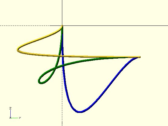

2017-12-27 19:45 GMT-02:00 Ronaldo Persiano rcmpersiano@gmail.com:
I can't assure this method is foolproof; it may go wild when the tangent
directions and endpoints induce a loop or inflexions to the arc.
​That is really true. I found a case where the energy curve as a function
​of the balance s has 3 local minima.
bzcp=[[0, 0, 0], [0, 0, -125.85], [0, 9.721, 32,14], [0, 79.721, 32,14]];
length=180;
For each minimum there is a stable cubic solution as shown bellow.
The blue curve has the smallest energy for a balance s=0.78. The yellow one
has the greatest energy for a balance s=0.04. The green curve was the one
found by my code with a balance s=0.39 and a total energy 10 times of the
blue curve and 74% of the yellow one. All three curves are local minima of
the energy function and I doubt that any of them is a good approximation of
an elastica.
