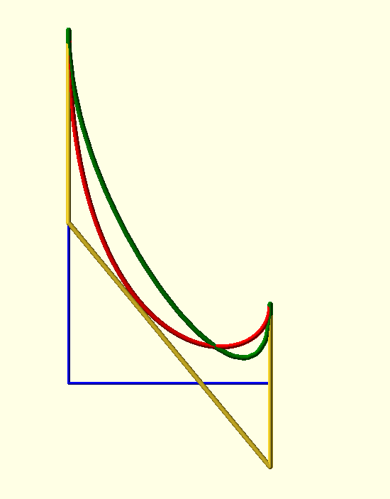

Here is the code of my atempts to find the cubic with minimum energy.
First note that AdjustBezier() finds the cubic with the desired length
keeping the balance between the norms of the cubic endpoint derivatives.
The strategy I used in the code was to change this balance in order to
reduce the cubic energy.
// for any cubic bz, it holds bz == balance(bz, 0.5)
function balance(bz,s) =
[ bz[0],
bz[0] + 2s(bz[1]-bz[0]),
bz[3] + 2*(1-s)*(bz[2]-bz[3]),
bz[3] ];
For each balance, the cubic is adjusted to the target length by
AdjustBezier() and its energy is calculated.
function BalancedEnergy(bz, s, l, eps) =
BzEnergy(AdjustBezier(balance(bz,s), l, eps));
To find the balance that leads to the minimum energy is objective of an
iterative search. The search for the cubic with minimum energy is done
iteratively narrowing an interval (s1,s2) of balances that contains the
best balance.
// Minimum energy Bezier arc with a given length l
// and given tangent directions at its ends
function BestBz(bz, l, eps=1e-3) =
let( bz2 = [  bz[0], // normalize end derivatives
bz[0]+unit(bz[1]-bz[0]),
bz[3]+unit(bz[2]-bz[3]),
bz[3] ],
s1  = eps,
en1 = BalancedEnergy(bz, s1, l, eps),
en2 = BalancedEnergy(bz, 1-s1, l, eps),
s  = _bestS(bz2, l, s1, 1-s1, en1, en2, eps) )
echo(smin=s)
AdjustBezier(balance(bz2,s), l);
function _bestS(bz, l, s1, s2, e1, e2, eps=1e-3, n=15) =
let( s12 = (s1+s2)/2,
e12 = BalancedEnergy(bz, s12, l, eps))
//echo("in",s1=s1,s2=s2,s12=s12,e1=e1,e2=e2,e12=e12)
abs(e12-(e1+e2)/2)/e12< eps ?
e1<e2 ? s1 : s2
let( s3  = max(min(parabMin(s1,s12,s2,e1,e12,e2),1-eps),eps) )
//echo(s1=s1,s3=s3,s2=s2,e1=e1,e12=e12,e2=e2,n=n)
abs(s3-s1)<eps || abs(s3-s2)<eps || n==0 ?
s3
let( e3 = BalancedEnergy(bz, s3, l, eps) )
//echo(e3=e3)
abs(e3-e12)/e12<eps ?
s3 :
e3<e12 ?
s3<s12 ?
_bestS(bz,l,s1,s12,e1,e12,eps,n-1)
_bestS(bz,l,s12,s2,e12,e2,eps,n-1)
s3<s12 ?
_bestS(bz,l,s3,s2,e3,e2,eps,n-1)
_bestS(bz,l,s1,s3,e1,e3,eps,n-1);
The full code is annexed.
In the experiments I have done with the code, the plot of the cubic energy
against the balance parameter s has the shape of an U with an almost
horizontal bottom. This shows that the effect of medium-sized changes of
the optimal balance does not produce significant changes of the cubic
energy. In special, in your case of a strip going down from a fixed pole to
a moving table clamped point, the optimal balance will change slowly from
0.5 (when the two end points are level) to 1 (when the strip is fully
stretched). That means the balance of the cubic endpoint derivatives in the
optimal solution is slightly favorable to the fixed point if the strip is
never fully stretched. So, your assumption that "keeping the two inner
control points level" would do the trick is not confirmed by my results.

Tue, Dec 26, 2017 2:17 PM
Interesting. I will have to combine with my code and put them side by side.
If I put my length and dimension into your code the result looks a lot
tighter and doesn't match what my real strip does.

Here is my curve in red and its control points in blue alongside yours with my actual geometry. Your BzEnergy function returns 12 times the energy for mine which is hard to believe because mine has a more distributed curvature. A strip held against the screen follows mine, not yours, so I think there must be a bug in your energy function. On 26 December 2017 at 14:17, nop head <nop.head@gmail.com> wrote: > Interesting. I will have to combine with my code and put them side by > side. If I put my length and dimension into your code the result looks a > lot tighter and doesn't match what my real strip does. > > On 25 December 2017 at 17:31, Ronaldo Persiano <rcmpersiano@gmail.com> > wrote: > >> Here is the code of my atempts to find the cubic with minimum energy. >> >> First note that AdjustBezier() finds the cubic with the desired length >> keeping the balance between the norms of the cubic endpoint derivatives. >> The strategy I used in the code was to change this balance in order to >> reduce the cubic energy. >> >> // for any cubic bz, it holds bz == balance(bz, 0.5) >> function balance(bz,s) = >> [ bz[0], >> bz[0] + 2*s*(bz[1]-bz[0]), >> bz[3] + 2*(1-s)*(bz[2]-bz[3]), >> bz[3] ]; >> >> >> For each balance, the cubic is adjusted to the target length by >> AdjustBezier() and its energy is calculated. >> >> function BalancedEnergy(bz, s, l, eps) = >> BzEnergy(AdjustBezier(balance(bz,s), l, eps)); >> >> >> To find the balance that leads to the minimum energy is objective of an >> iterative search. The search for the cubic with minimum energy is done >> iteratively narrowing an interval (s1,s2) of balances that contains the >> best balance. >> >> // Minimum energy Bezier arc with a given length l >> // and given tangent directions at its ends >> function BestBz(bz, l, eps=1e-3) = >> let( bz2 = [ bz[0], // normalize end derivatives >> bz[0]+unit(bz[1]-bz[0]), >> bz[3]+unit(bz[2]-bz[3]), >> bz[3] ], >> s1 = eps, >> en1 = BalancedEnergy(bz, s1, l, eps), >> en2 = BalancedEnergy(bz, 1-s1, l, eps), >> s = _bestS(bz2, l, s1, 1-s1, en1, en2, eps) ) >> echo(smin=s) >> AdjustBezier(balance(bz2,s), l); >> >> function _bestS(bz, l, s1, s2, e1, e2, eps=1e-3, n=15) = >> let( s12 = (s1+s2)/2, >> e12 = BalancedEnergy(bz, s12, l, eps)) >> //echo("in",s1=s1,s2=s2,s12=s12,e1=e1,e2=e2,e12=e12) >> abs(e12-(e1+e2)/2)/e12< eps ? >> e1<e2 ? s1 : s2 >> : >> let( s3 = max(min(parabMin(s1,s12,s2,e1,e12,e2),1-eps),eps) ) >> //echo(s1=s1,s3=s3,s2=s2,e1=e1,e12=e12,e2=e2,n=n) >> abs(s3-s1)<eps || abs(s3-s2)<eps || n==0 ? >> s3 >> : >> let( e3 = BalancedEnergy(bz, s3, l, eps) ) >> //echo(e3=e3) >> abs(e3-e12)/e12<eps ? >> s3 : >> e3<e12 ? >> s3<s12 ? >> _bestS(bz,l,s1,s12,e1,e12,eps,n-1) >> : >> _bestS(bz,l,s12,s2,e12,e2,eps,n-1) >> : >> s3<s12 ? >> _bestS(bz,l,s3,s2,e3,e2,eps,n-1) >> : >> _bestS(bz,l,s1,s3,e1,e3,eps,n-1); >> >> >> The full code is annexed. >> >> In the experiments I have done with the code, the plot of the cubic >> energy against the balance parameter s has the shape of an U with an almost >> horizontal bottom. This shows that the effect of medium-sized changes of >> the optimal balance does not produce significant changes of the cubic >> energy. In special, in your case of a strip going down from a fixed pole to >> a moving table clamped point, the optimal balance will change slowly from >> 0.5 (when the two end points are level) to 1 (when the strip is fully >> stretched). That means the balance of the cubic endpoint derivatives in the >> optimal solution is slightly favorable to the fixed point if the strip is >> never fully stretched. So, your assumption that "keeping the two inner >> control points level" would do the trick is not confirmed by my results. >> >> 2017-12-23 10:44 GMT-02:00 nop head <nop.head@gmail.com>: >> >>> I don't know if this has a mathematical validity but simple keeping the >>> two inner control points level with each other seems to produce a curve >>> that matches a strip held against the screen fairly well. >>> ​ >>> The length of the strip is only 9mm longer compared to the version with >>> the control points equidistant below the end points. >>> >>> >> _______________________________________________ >> OpenSCAD mailing list >> Discuss@lists.openscad.org >> http://lists.openscad.org/mailman/listinfo/discuss_lists.openscad.org >> >> >

Would you mind to provide me the geometric data (endpoint coordinates and
strip length) of this case?

Would you mind to provide me the geometric data (endpoint coordinates and strip length) of this case? 2017-12-26 13:32 GMT-02:00 nop head <nop.head@gmail.com>: > Whoops > > > ​ > > On 26 December 2017 at 15:31, nop head <nop.head@gmail.com> wrote: > >> Here is my curve in red and its control points in blue alongside yours >> with my actual geometry. Your BzEnergy function returns 12 times the energy >> for mine which is hard to believe because mine has a more distributed >> curvature. A strip held against the screen follows mine, not yours, so I >> think there must be a bug in your energy function. >> >> On 26 December 2017 at 14:17, nop head <nop.head@gmail.com> wrote: >> >>> Interesting. I will have to combine with my code and put them side by >>> side. If I put my length and dimension into your code the result looks a >>> lot tighter and doesn't match what my real strip does. >>> >>> On 25 December 2017 at 17:31, Ronaldo Persiano <rcmpersiano@gmail.com> >>> wrote: >>> >>>> Here is the code of my atempts to find the cubic with minimum energy. >>>> >>>> First note that AdjustBezier() finds the cubic with the desired length >>>> keeping the balance between the norms of the cubic endpoint derivatives. >>>> The strategy I used in the code was to change this balance in order to >>>> reduce the cubic energy. >>>> >>>> // for any cubic bz, it holds bz == balance(bz, 0.5) >>>> function balance(bz,s) = >>>> [ bz[0], >>>> bz[0] + 2*s*(bz[1]-bz[0]), >>>> bz[3] + 2*(1-s)*(bz[2]-bz[3]), >>>> bz[3] ]; >>>> >>>> >>>> For each balance, the cubic is adjusted to the target length by >>>> AdjustBezier() and its energy is calculated. >>>> >>>> function BalancedEnergy(bz, s, l, eps) = >>>> BzEnergy(AdjustBezier(balance(bz,s), l, eps)); >>>> >>>> >>>> To find the balance that leads to the minimum energy is objective of an >>>> iterative search. The search for the cubic with minimum energy is done >>>> iteratively narrowing an interval (s1,s2) of balances that contains the >>>> best balance. >>>> >>>> // Minimum energy Bezier arc with a given length l >>>> // and given tangent directions at its ends >>>> function BestBz(bz, l, eps=1e-3) = >>>> let( bz2 = [ bz[0], // normalize end derivatives >>>> bz[0]+unit(bz[1]-bz[0]), >>>> bz[3]+unit(bz[2]-bz[3]), >>>> bz[3] ], >>>> s1 = eps, >>>> en1 = BalancedEnergy(bz, s1, l, eps), >>>> en2 = BalancedEnergy(bz, 1-s1, l, eps), >>>> s = _bestS(bz2, l, s1, 1-s1, en1, en2, eps) ) >>>> echo(smin=s) >>>> AdjustBezier(balance(bz2,s), l); >>>> >>>> function _bestS(bz, l, s1, s2, e1, e2, eps=1e-3, n=15) = >>>> let( s12 = (s1+s2)/2, >>>> e12 = BalancedEnergy(bz, s12, l, eps)) >>>> //echo("in",s1=s1,s2=s2,s12=s12,e1=e1,e2=e2,e12=e12) >>>> abs(e12-(e1+e2)/2)/e12< eps ? >>>> e1<e2 ? s1 : s2 >>>> : >>>> let( s3 = max(min(parabMin(s1,s12,s2,e1,e12,e2),1-eps),eps) ) >>>> //echo(s1=s1,s3=s3,s2=s2,e1=e1,e12=e12,e2=e2,n=n) >>>> abs(s3-s1)<eps || abs(s3-s2)<eps || n==0 ? >>>> s3 >>>> : >>>> let( e3 = BalancedEnergy(bz, s3, l, eps) ) >>>> //echo(e3=e3) >>>> abs(e3-e12)/e12<eps ? >>>> s3 : >>>> e3<e12 ? >>>> s3<s12 ? >>>> _bestS(bz,l,s1,s12,e1,e12,eps,n-1) >>>> : >>>> _bestS(bz,l,s12,s2,e12,e2,eps,n-1) >>>> : >>>> s3<s12 ? >>>> _bestS(bz,l,s3,s2,e3,e2,eps,n-1) >>>> : >>>> _bestS(bz,l,s1,s3,e1,e3,eps,n-1); >>>> >>>> >>>> The full code is annexed. >>>> >>>> In the experiments I have done with the code, the plot of the cubic >>>> energy against the balance parameter s has the shape of an U with an almost >>>> horizontal bottom. This shows that the effect of medium-sized changes of >>>> the optimal balance does not produce significant changes of the cubic >>>> energy. In special, in your case of a strip going down from a fixed pole to >>>> a moving table clamped point, the optimal balance will change slowly from >>>> 0.5 (when the two end points are level) to 1 (when the strip is fully >>>> stretched). That means the balance of the cubic endpoint derivatives in the >>>> optimal solution is slightly favorable to the fixed point if the strip is >>>> never fully stretched. So, your assumption that "keeping the two inner >>>> control points level" would do the trick is not confirmed by my results. >>>> >>>> 2017-12-23 10:44 GMT-02:00 nop head <nop.head@gmail.com>: >>>> >>>>> I don't know if this has a mathematical validity but simple keeping >>>>> the two inner control points level with each other seems to produce a curve >>>>> that matches a strip held against the screen fairly well. >>>>> ​ >>>>> The length of the strip is only 9mm longer compared to the version >>>>> with the control points equidistant below the end points. >>>>> >>>>> >>>> _______________________________________________ >>>> OpenSCAD mailing list >>>> Discuss@lists.openscad.org >>>> http://lists.openscad.org/mailman/listinfo/discuss_lists.openscad.org >>>> >>>> >>> >> > > _______________________________________________ > OpenSCAD mailing list > Discuss@lists.openscad.org > http://lists.openscad.org/mailman/listinfo/discuss_lists.openscad.org > >
Tue, Dec 26, 2017 4:21 PM
The starting point is:
bzcp=[[0, 0, 0], [0, 0, -125.85], [0, 79.721, -125.85], [0, 79.721,
-108.35]];
length=180;
After I adjust the control points for length I get  [[0, 0, 0], [0, 0,
-139.685], [0, 79.721, -139.685], [0, 79.721, -108.35]]
On 26 December 2017 at 16:15, Ronaldo Persiano rcmpersiano@gmail.com
2017-12-26 13:32 GMT-02:00 nop head nop.head@gmail.com:
Whoops
On 25 December 2017 at 17:31, Ronaldo Persiano rcmpersiano@gmail.com

The starting point is: bzcp=[[0, 0, 0], [0, 0, -125.85], [0, 79.721, -125.85], [0, 79.721, -108.35]]; length=180; After I adjust the control points for length I get [[0, 0, 0], [0, 0, -139.685], [0, 79.721, -139.685], [0, 79.721, -108.35]] On 26 December 2017 at 16:15, Ronaldo Persiano <rcmpersiano@gmail.com> wrote: > Would you mind to provide me the geometric data (endpoint coordinates and > strip length) of this case? > > 2017-12-26 13:32 GMT-02:00 nop head <nop.head@gmail.com>: > >> Whoops >> >> >> ​ >> >> On 26 December 2017 at 15:31, nop head <nop.head@gmail.com> wrote: >> >>> Here is my curve in red and its control points in blue alongside yours >>> with my actual geometry. Your BzEnergy function returns 12 times the energy >>> for mine which is hard to believe because mine has a more distributed >>> curvature. A strip held against the screen follows mine, not yours, so I >>> think there must be a bug in your energy function. >>> >>> On 26 December 2017 at 14:17, nop head <nop.head@gmail.com> wrote: >>> >>>> Interesting. I will have to combine with my code and put them side by >>>> side. If I put my length and dimension into your code the result looks a >>>> lot tighter and doesn't match what my real strip does. >>>> >>>> On 25 December 2017 at 17:31, Ronaldo Persiano <rcmpersiano@gmail.com> >>>> wrote: >>>> >>>>> Here is the code of my atempts to find the cubic with minimum energy. >>>>> >>>>> First note that AdjustBezier() finds the cubic with the desired length >>>>> keeping the balance between the norms of the cubic endpoint derivatives. >>>>> The strategy I used in the code was to change this balance in order to >>>>> reduce the cubic energy. >>>>> >>>>> // for any cubic bz, it holds bz == balance(bz, 0.5) >>>>> function balance(bz,s) = >>>>> [ bz[0], >>>>> bz[0] + 2*s*(bz[1]-bz[0]), >>>>> bz[3] + 2*(1-s)*(bz[2]-bz[3]), >>>>> bz[3] ]; >>>>> >>>>> >>>>> For each balance, the cubic is adjusted to the target length by >>>>> AdjustBezier() and its energy is calculated. >>>>> >>>>> function BalancedEnergy(bz, s, l, eps) = >>>>> BzEnergy(AdjustBezier(balance(bz,s), l, eps)); >>>>> >>>>> >>>>> To find the balance that leads to the minimum energy is objective of >>>>> an iterative search. The search for the cubic with minimum energy is done >>>>> iteratively narrowing an interval (s1,s2) of balances that contains the >>>>> best balance. >>>>> >>>>> // Minimum energy Bezier arc with a given length l >>>>> // and given tangent directions at its ends >>>>> function BestBz(bz, l, eps=1e-3) = >>>>> let( bz2 = [ bz[0], // normalize end derivatives >>>>> bz[0]+unit(bz[1]-bz[0]), >>>>> bz[3]+unit(bz[2]-bz[3]), >>>>> bz[3] ], >>>>> s1 = eps, >>>>> en1 = BalancedEnergy(bz, s1, l, eps), >>>>> en2 = BalancedEnergy(bz, 1-s1, l, eps), >>>>> s = _bestS(bz2, l, s1, 1-s1, en1, en2, eps) ) >>>>> echo(smin=s) >>>>> AdjustBezier(balance(bz2,s), l); >>>>> >>>>> function _bestS(bz, l, s1, s2, e1, e2, eps=1e-3, n=15) = >>>>> let( s12 = (s1+s2)/2, >>>>> e12 = BalancedEnergy(bz, s12, l, eps)) >>>>> //echo("in",s1=s1,s2=s2,s12=s12,e1=e1,e2=e2,e12=e12) >>>>> abs(e12-(e1+e2)/2)/e12< eps ? >>>>> e1<e2 ? s1 : s2 >>>>> : >>>>> let( s3 = max(min(parabMin(s1,s12,s2,e1,e12,e2),1-eps),eps) ) >>>>> //echo(s1=s1,s3=s3,s2=s2,e1=e1,e12=e12,e2=e2,n=n) >>>>> abs(s3-s1)<eps || abs(s3-s2)<eps || n==0 ? >>>>> s3 >>>>> : >>>>> let( e3 = BalancedEnergy(bz, s3, l, eps) ) >>>>> //echo(e3=e3) >>>>> abs(e3-e12)/e12<eps ? >>>>> s3 : >>>>> e3<e12 ? >>>>> s3<s12 ? >>>>> _bestS(bz,l,s1,s12,e1,e12,eps,n-1) >>>>> : >>>>> _bestS(bz,l,s12,s2,e12,e2,eps,n-1) >>>>> : >>>>> s3<s12 ? >>>>> _bestS(bz,l,s3,s2,e3,e2,eps,n-1) >>>>> : >>>>> _bestS(bz,l,s1,s3,e1,e3,eps,n-1); >>>>> >>>>> >>>>> The full code is annexed. >>>>> >>>>> In the experiments I have done with the code, the plot of the cubic >>>>> energy against the balance parameter s has the shape of an U with an almost >>>>> horizontal bottom. This shows that the effect of medium-sized changes of >>>>> the optimal balance does not produce significant changes of the cubic >>>>> energy. In special, in your case of a strip going down from a fixed pole to >>>>> a moving table clamped point, the optimal balance will change slowly from >>>>> 0.5 (when the two end points are level) to 1 (when the strip is fully >>>>> stretched). That means the balance of the cubic endpoint derivatives in the >>>>> optimal solution is slightly favorable to the fixed point if the strip is >>>>> never fully stretched. So, your assumption that "keeping the two inner >>>>> control points level" would do the trick is not confirmed by my results. >>>>> >>>>> 2017-12-23 10:44 GMT-02:00 nop head <nop.head@gmail.com>: >>>>> >>>>>> I don't know if this has a mathematical validity but simple keeping >>>>>> the two inner control points level with each other seems to produce a curve >>>>>> that matches a strip held against the screen fairly well. >>>>>> ​ >>>>>> The length of the strip is only 9mm longer compared to the version >>>>>> with the control points equidistant below the end points. >>>>>> >>>>>> >>>>> _______________________________________________ >>>>> OpenSCAD mailing list >>>>> Discuss@lists.openscad.org >>>>> http://lists.openscad.org/mailman/listinfo/discuss_lists.openscad.org >>>>> >>>>> >>>> >>> >> >> _______________________________________________ >> OpenSCAD mailing list >> Discuss@lists.openscad.org >> http://lists.openscad.org/mailman/listinfo/discuss_lists.openscad.org >> >> > > _______________________________________________ > OpenSCAD mailing list > Discuss@lists.openscad.org > http://lists.openscad.org/mailman/listinfo/discuss_lists.openscad.org > >
Tue, Dec 26, 2017 4:47 PM
You are right. The energy function was wrong. At some point, I have made
some change in it.
The correct (I hope) energy function should be:
function BzEnergy(b, n=8) =
let( bs = subdivBezier3(b, n) )
[for(i=[0:3:len(bs)-1]) pow(curvature(bs,i),2)]
*[for(i=[0:3:len(bs)-1]) 1]/pow(2,n-1);
With this function, the plot of the cubic energy as a function of the
balance s has a sharper minimum what is more reasonable.
I will try your data and compare.
