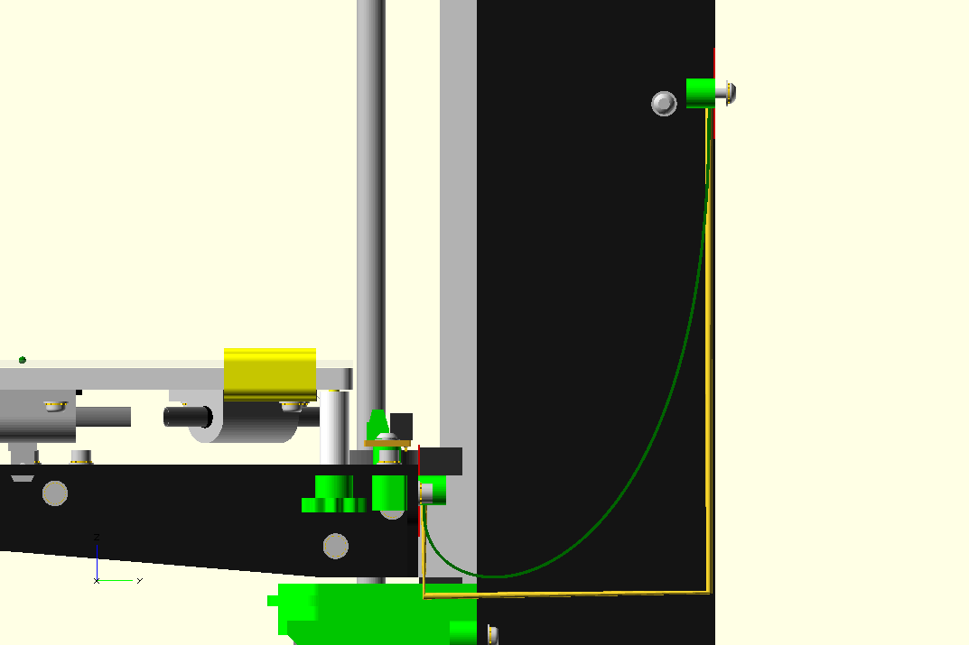

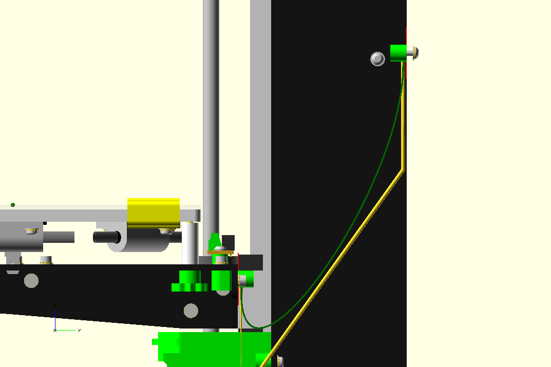

I don't know if this has a mathematical validity but simple keeping the two
inner control points level with each other seems to produce a curve that
matches a strip held against the screen fairly well.
The length of the strip is only 9mm longer compared to the version with the
control points equidistant below the end points.

Sat, Dec 23, 2017 5:38 PM
I severely doubt that this can have a trivial solution.
Yes for a general strip that is certainly true. In my case the weight of
the strip is negligible compared to its stiffness so gravity doesn't play a
part. I can turn it upside down and its shape doesn't change noticeably.
Yes if the ends get two close together it would try to be a light bulb
shape. That doesn't matter in my model because it is only the lower
position that is critical. The constraint is the strip must be short enough
to not touch the bottom. I use your iteration method to find the control
points to give the target z value when the table is at the bottom. That
gives me the length of the strip. In any other position I move the control
points to achieve that length. In the middle position it may bulge forwards
slightly in real life but not in the model. As there is nothing for it to
hit it doesn't matter for my purpose. What matters is I generate the
correct length of strip and cable on the BOM and that it is a long as
possible without touching the bottom.
My breakthrough has been giving the two control points the same z value, so
a single parameter moves them up and down together. I found by accident
that gives a realistic curve and can rationalise it by realising that
having the control points level is the minimum energy state of the curve
through the control points. I.e. if the two bottom corners were sprung
hinges that wanted to be 180 then both at 90 gives the minimum energy as it
would be proportional to the sum of (180 - angle) squared. Whether the
Bezier curve generated from those points is the minimum energy curve I
don't know but empirically it seems to match reality. If I make the rear
point lower it increases the radius of the curve but when it goes below the
the front control point the strip starts to kink as it leaves its clamp.
When the rear control point is higher than the front one the strip forms
too tight a curve.

Yes for a general strip that is certainly true. In my case the weight of the strip is negligible compared to its stiffness so gravity doesn't play a part. I can turn it upside down and its shape doesn't change noticeably.
Yes if the ends get two close together it would try to be a light bulb shape. That doesn't matter in my model because it is only the lower position that is critical. The constraint is the strip must be short enough to not touch the bottom. I use your iteration method to find the control points to give the target z value when the table is at the bottom. That gives me the length of the strip. In any other position I move the control points to achieve that length. In the middle position it may bulge forwards slightly in real life but not in the model. As there is nothing for it to hit it doesn't matter for my purpose. What matters is I generate the correct length of strip and cable on the BOM and that it is a long as possible without touching the bottom.
My breakthrough has been giving the two control points the same z value, so a single parameter moves them up and down together. I found by accident that gives a realistic curve and can rationalise it by realising that having the control points level is the minimum energy state of the curve through the control points. I.e. if the two bottom corners were sprung hinges that wanted to be 180 then both at 90 gives the minimum energy as it would be proportional to the sum of (180 - angle) squared. Whether the Bezier curve generated from those points is the minimum energy curve I don't know but empirically it seems to match reality. If I make the rear point lower it increases the radius of the curve but when it goes below the the front control point the strip starts to kink as it leaves its clamp. When the rear control point is higher than the front one the strip forms too tight a curve.
