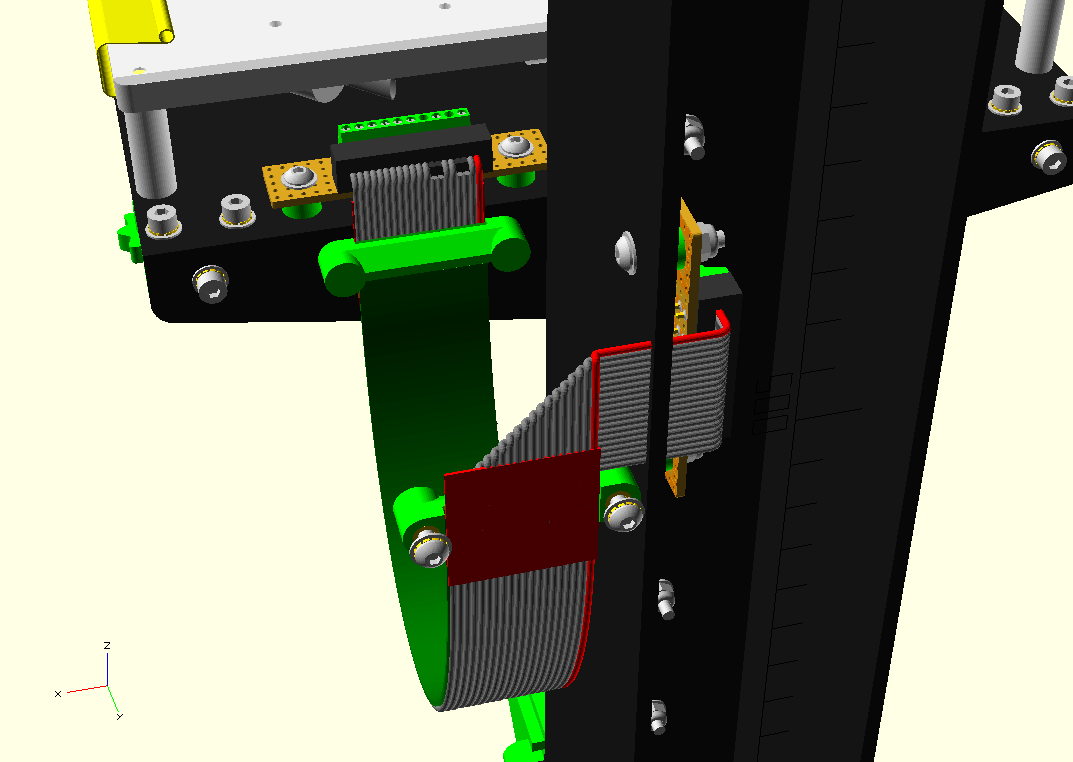

Modelling a flexible strip
Tue, Dec 19, 2017 10:39 PM
I just held a real strip up to my monitor and can see it quite different at
the extremes, so yes I would be interested to see your minimum energy
solution please Ronaldo.
On 19 December 2017 at 22:19, nop head nop.head@gmail.com wrote:
Hi Ronaldo,
Thanks for your input. I tried dropping in your changes to my code but
didn't see any noticeable speed improvement. I think this is because I had
already made the length function faster by only using 100 segments instead
of 1000. I also calculate the target length to give the minimum z that is
allowed by adjusting the control points until it droops the correct amount.
My code currently takes 20 seconds because I added the ribbon cable and
sweep each wire separately because they take different paths at the fold. I
also model the veroboard terminations including tracks, breaks and solder
menisci! I think the time for the Bezier calculation is swamped by 20
sweeps. I used Frenet-Serret for the strip because it has two vertical
sections that the minimum angle solution doesn't like. I used minimum angle
for the cable because Frenet-Serret goes wild when the at the fold.
Yes I think you are correct saying the optimum starting angle is not
straight down but I am not sure if that is worth changing.  I still need to
see how accurate it is against a real strip.

I have addressed the problem of finding the minimum energy Bezier arc
too. I have a version that is reasonable fast now requiring between 1 to 2
sec for each step of an animation similar to nophead's one. I don't believe
that material is of broad interest but anyone interested in it may contact
me by PM.
BTW, I think nophead could reduce the polypropylene strip strain by
giving it a little slope in the table end instead of driving it vertically.
2017-12-07 10:22 GMT-02:00 nop head nop.head@gmail.com:
Yes I suspect the bend radius would be a bit bigger in real life, closer
to an arc. The cable is ribbon, so not stiff at all but I bend it around a
0.8mm thick polypropylene strip to distribute the bending. It is the strip
I am trying to model. It works like a cable chain for ribbon but is a lot
more compact and cheaper. Without it ribbon tends to bend too much at the
attachment points.
The model needs to predict the length to make the strip as that goes on
the BOM. The length should be as long as possible without hitting the
bottom as it would buckle if it did. Using Bezier my guess is it is a bit
shorter than it could be. If it is not too much that will be OK but if it
is grossly wrong then the strip is tighter than it needs to be so is not
good for cable life.
When I get home I will mock it up and see if it is accurate enough. If
not I will try to work out a minimum energy solution using finite elements.
It is after all drawn with 100 finite elements so I can easily calculate
the bend at each joint. The tricky bit is moving the joints to minimise the
energy.
On 7 December 2017 at 10:31, arnholm@arnholm.org wrote:
On 2017-12-05 23:01, nop head wrote:
Yes it is a bit tight, which is why I modelled it. The problem is it
needs to not hit the shelf below that covers the electronics. It only
cycles once per build so I think I will get away with it. I have used
ribbons on X and Y that move millions of times in a build.
Nice video, although the cable deformation is somewhat unrealistic.
If knowing the true shape was critical, it would require non-linear
finite element analysis. Someone mentioned a catenary, but this cable is
much stiffer than a catenary (essentially no bending stiffness). The
problem is quite similar to analyzing flexible risers used on the offshore
industry. Non-negligible bending stiffness, large deformations, boundary
conditions at the ends.
Still the simplified approximation was quite ok for a demo.
attachment points.
energy.
As a long-time happy builder/user of a Mendel90, I must say I love seeing these sneak peeks at what you're cooking up next, and it continually impresses me how thorough you are with your OpenSCAD designs! Cheers, Len. On 20 December 2017 at 11:19, nop head <nop.head@gmail.com> wrote: > Hi Ronaldo, > Thanks for your input. I tried dropping in your changes to my code but > didn't see any noticeable speed improvement. I think this is because I had > already made the length function faster by only using 100 segments instead > of 1000. I also calculate the target length to give the minimum z that is > allowed by adjusting the control points until it droops the correct amount. > > My code currently takes 20 seconds because I added the ribbon cable and > sweep each wire separately because they take different paths at the fold. I > also model the veroboard terminations including tracks, breaks and solder > menisci! I think the time for the Bezier calculation is swamped by 20 > sweeps. I used Frenet-Serret for the strip because it has two vertical > sections that the minimum angle solution doesn't like. I used minimum angle > for the cable because Frenet-Serret goes wild when the at the fold. > > Yes I think you are correct saying the optimum starting angle is not > straight down but I am not sure if that is worth changing. I still need to > see how accurate it is against a real strip. > > > ​ > > > > > > On 18 December 2017 at 12:23, Ronaldo Persiano <rcmpersiano@gmail.com> > wrote: > >> I have been struggling with this problem for a while. I will not go into >> the details of the energy minimizing problem here and will just address the >> problem of finding the Bezier arc with a given length, given its end points >> and its tangent directions at the endpoints. The function AdjustBezier() >> provided by Torleif is inefficient for this task requiring a lot of >> adjustment. >> >> The main idea of Torleif solution is to adjust the Bezier arc endpoints >> derivatives until the required length is attained. The adjustment is done >> by: >> >> function adjust1(p, r) = >> [ p[0], p[0]+(p[1]-p[0])*r, p[3]+(p[2]-p[3])*r , p[3] ]; >> >> >> where p is the incoming Bezier control points and r is the adjustment >> parameter. So, the problem is to find the parameter r such that: >> >> len3bz(adjust(p,r)) == length >> >> >> where len3bz() is the function that estimates a Bezier arc length. >> >> I have observed that the length of the Bezier arc is fairly linear with >> respect to the parameter r and the following code explores it: >> >> function AdjustBezier(p, l, eps=0.001, r1=10, r2=12, l1, l2)= >> let( l1 = l1!=undef? l1: len3bz(adjust1(p,r1), eps), >> l2 = l2!=undef? l2: len3bz(adjust1(p,r2), eps) ) >> abs(l1-l)<eps ? >> adjust1(p,r1) >> : >> let( r = r1 + (l-l1)*(r2-r1)/(l2-l1) ) >> abs(r-r1)<abs(r-r2) ? >> AdjustBezier(p, l, eps, r, r1, undef, l1) >> : >> AdjustBezier(p, l, eps, r, r2, undef, l2); >> >> >> This function requires very few steps compared with Torleif's one which >> is very lengthy when the solution is almost stretched. >> >> Next, I have considered the time consuming function len3bz(). I >> approached this by Bezier subdivision instead of a fixed sample of Bezier >> evaluations. The resulting code is a bit longer but it is more efficient. >> >> function len3bz(bz, eps=0.001) = >> let( l1 = polygonalLength(bz, ceil(-log(eps))), >> l2 = polygonalLength([for(i=[0:3:len(bz)-1]) bz[i]], >> ceil(-log(eps))) ) >> l1-l2<eps ? >> (l1+l2)/2 >> : >> len3bz(subdivBezier3(bz, 1), eps); >> >> function polygonalLength(p) = >> let( l = [for(i=[1:len(p)-1]) norm(p[i]-p[i-1]) ] ) >> l*[for(i=[0:len(l)-1]) 1]; >> >> function subdivBezier3(p, n=3) = >> n==0 ? >> p >> : >> subdivBezier3( concat([for(i=[0:3:len(p)-4], >> s=[_subdivB(p,i)], >> j=[0:len(s)-2] ) s[j] ], >> [p[len(p)-1] ] ), >> n-1); >> >> function _subdivB(p, from=0) = >> [ [1,0,0,0], >> [1/2,1/2,0,0], >> [1/4,1/2,1/4,0], >> [1/8,3/8, 3/8, 1/8], >> [0, 1/4,1/2,1/4], >> [0, 0, 1/2,1/2], >> [0, 0, 0, 1] ] >> * [p[from], p[from+1], p[from+2], p[from+3] ]; >> >> >> I have addressed the problem of finding the minimum energy Bezier arc >> too. I have a version that is reasonable fast now requiring between 1 to 2 >> sec for each step of an animation similar to nophead's one. I don't believe >> that material is of broad interest but anyone interested in it may contact >> me by PM. >> >> BTW, I think nophead could reduce the polypropylene strip strain by >> giving it a little slope in the table end instead of driving it vertically. >> >> >> 2017-12-07 10:22 GMT-02:00 nop head <nop.head@gmail.com>: >> >>> Yes I suspect the bend radius would be a bit bigger in real life, closer >>> to an arc. The cable is ribbon, so not stiff at all but I bend it around a >>> 0.8mm thick polypropylene strip to distribute the bending. It is the strip >>> I am trying to model. It works like a cable chain for ribbon but is a lot >>> more compact and cheaper. Without it ribbon tends to bend too much at the >>> attachment points. >>> >>> The model needs to predict the length to make the strip as that goes on >>> the BOM. The length should be as long as possible without hitting the >>> bottom as it would buckle if it did. Using Bezier my guess is it is a bit >>> shorter than it could be. If it is not too much that will be OK but if it >>> is grossly wrong then the strip is tighter than it needs to be so is not >>> good for cable life. >>> >>> When I get home I will mock it up and see if it is accurate enough. If >>> not I will try to work out a minimum energy solution using finite elements. >>> It is after all drawn with 100 finite elements so I can easily calculate >>> the bend at each joint. The tricky bit is moving the joints to minimise the >>> energy. >>> >>> On 7 December 2017 at 10:31, <arnholm@arnholm.org> wrote: >>> >>>> On 2017-12-05 23:01, nop head wrote: >>>> >>>>> Yes it is a bit tight, which is why I modelled it. The problem is it >>>>> needs to not hit the shelf below that covers the electronics. It only >>>>> cycles once per build so I think I will get away with it. I have used >>>>> ribbons on X and Y that move millions of times in a build. >>>>> >>>> >>>> Nice video, although the cable deformation is somewhat unrealistic. >>>> >>>> If knowing the true shape was critical, it would require non-linear >>>> finite element analysis. Someone mentioned a catenary, but this cable is >>>> much stiffer than a catenary (essentially no bending stiffness). The >>>> problem is quite similar to analyzing flexible risers used on the offshore >>>> industry. Non-negligible bending stiffness, large deformations, boundary >>>> conditions at the ends. >>>> >>>> Still the simplified approximation was quite ok for a demo. >>>> >>>> Carsten Arnholm >>>> >>>> >>>> _______________________________________________ >>>> OpenSCAD mailing list >>>> Discuss@lists.openscad.org >>>> http://lists.openscad.org/mailman/listinfo/discuss_lists.openscad.org >>>> >>> >>> >>> _______________________________________________ >>> OpenSCAD mailing list >>> Discuss@lists.openscad.org >>> http://lists.openscad.org/mailman/listinfo/discuss_lists.openscad.org >>> >>> >> >> _______________________________________________ >> OpenSCAD mailing list >> Discuss@lists.openscad.org >> http://lists.openscad.org/mailman/listinfo/discuss_lists.openscad.org >> >> > > _______________________________________________ > OpenSCAD mailing list > Discuss@lists.openscad.org > http://lists.openscad.org/mailman/listinfo/discuss_lists.openscad.org > >

Unfortunately, I am away home and haven't took my notebook with me. You
will have to wait till after Christmas...
I can tell you the general principles, though. The energy expression of a
curve was taken proportional to the integral of its second parametric
derivative. Using Maxima, I found the energy of a cubic arc may be computed
by:
d0d0 + d0d1 + d1*d1
where d0 and d1 are the second parametric derivatives at the ends of the
arc.
In order to change the arc to minimize its energy, I have used the
following adjustment:
function adjust2(bz, s) =
[ [ bz[0],
bz[0] + 2*(1-s)(b[1]-bz[0]),
bz[3] + 2
s*(b[2]-bz[3]),
bz[3] ];
where s is a real parameter in [0,1]. The parameter s changes the balance
between the two end derivatives of the arc. In special, adjust2(bz, 0.5) ==
bz.
Plotting the energy of an adjusted arc as a function of s in [0,1], I found
that it has no other local minimum besides the global minimum. The energy
minimizing process is a recursive algorithm that starts with an interval of
s values (s0, s1) that contains the minimum s, finds an approximation of
the minimum and a narrower interval to recur. To find an approximation, I
interpolate a quadratic polynomial to the points s0, (s0+s1)/2 and s1 and
find its minimum. For each s whose energy is needed, the arc is adjusted to
the proper length by AdujstBezier.
2017-12-19 20:39 GMT-02:00 nop head nop.head@gmail.com:
at the extremes, so yes I would be interested to see your minimum energy
Hi Ronaldo,
On 18 December 2017 at 12:23, Ronaldo Persiano rcmpersiano@gmail.com
adjustment.
by:
abs(l1-l)<eps ?
adjust1(p,r1)
ceil(-log(eps))) )
l1-l2<eps ?
(l1+l2)/2
n==0 ?
p
s=[_subdivB(p,i)],
[p[len(p)-1] ] ),
n-1);
[ [1,0,0,0],
[1/2,1/2,0,0],
[1/4,1/2,1/4,0],
[0, 1/4,1/2,1/4],
[0, 0, 1/2,1/2],
[0, 0, 0, 1]  ]
me by PM.

rotations globally. The alternative code instead computes the global
section rotation by composing small local rotations from one path point to
the next.

The sweep.scad code doesn't compute rotations from angles. The rotation unstability on vertical segments results from computing the section rotations globally. The alternative code instead computes the global section rotation by composing small local rotations from one path point to the next. 2017-12-20 17:53 GMT-02:00 Revar Desmera <revarbat@gmail.com>: > I ran into that issue with vertical sections of my sweeps as well. I fixed > it by changing my code to use quaternions instead of Euler angles. > > - Revar >
Fri, Dec 22, 2017 7:51 PM
The energy expression of a curve was taken proportional to the integral of
its second parametric derivative
I don't think this is right. I think the energy is proportional to the
integral of the square of curvature. This is because the potential energy
in a spring is a square law due to the force increasing as you bend it.
Also I think curvature is second derivative with respect to arc length, not
the parameter.
the next.
