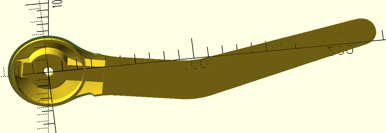

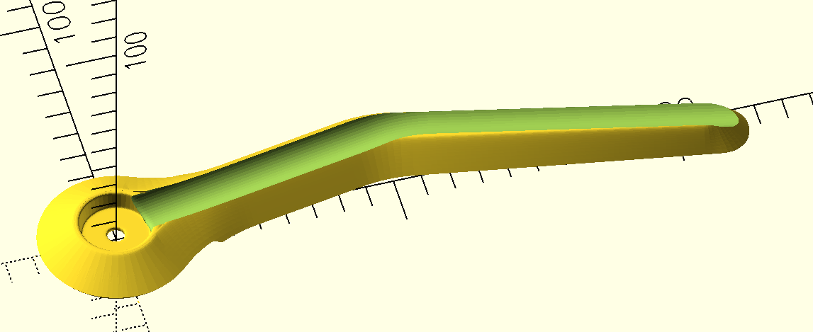

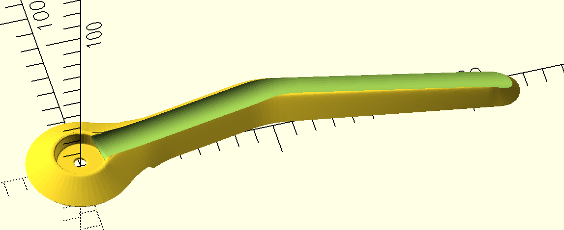

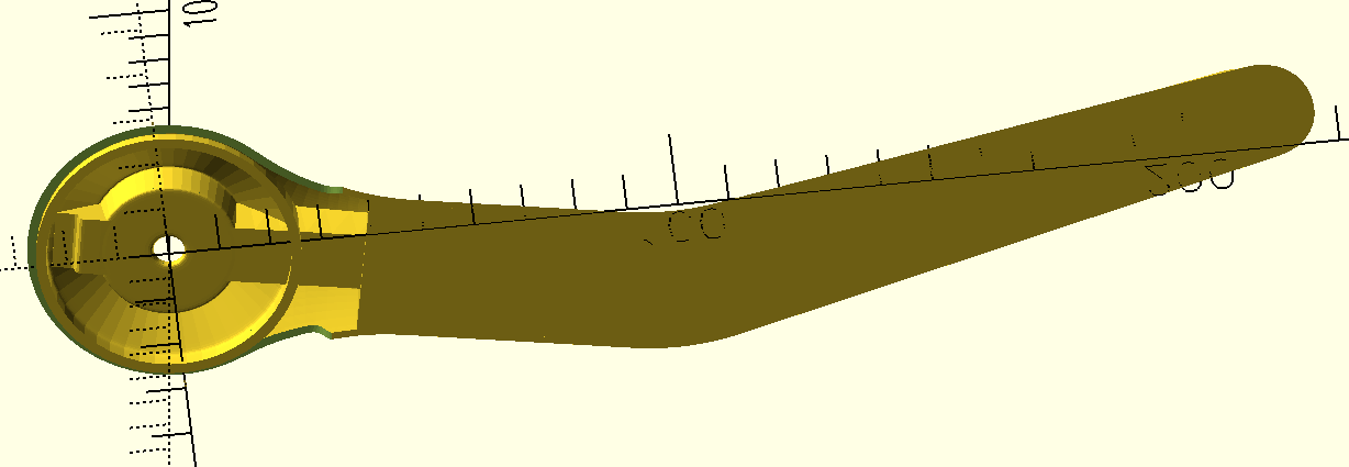

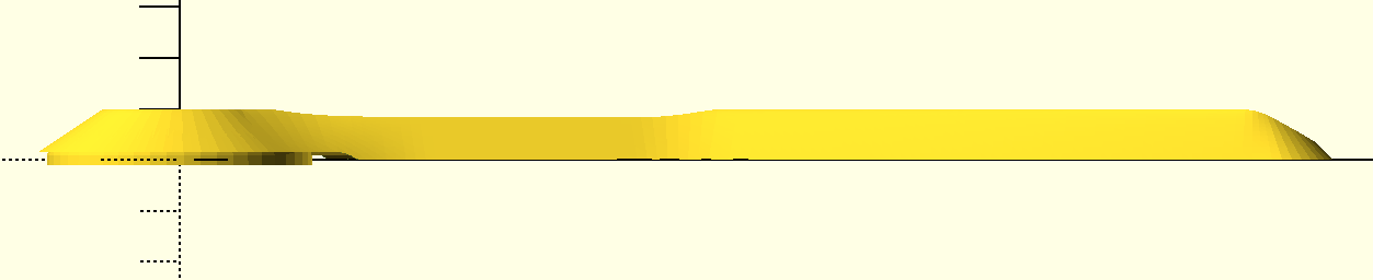

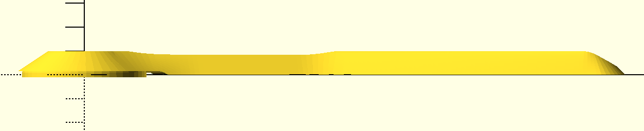

Sat, Jun 6, 2026 4:00 PM
I tried this today and it took a while
very difficult
posted the scad file: it is 1.6 mb (strange_shape.scad)
https://github.com/sprabhakar2006/openSCAD/blob/main/strange_shape.scad
associated_python code is attached
[image: Screenshot 2026-06-06 at 9.10.37 PM.png]
[image: Screenshot 2026-06-06 at 9.12.14 PM.png]
[image: Screenshot 2026-06-06 at 9.11.34 PM.png]

I tried this today and it took a while very difficult posted the scad file: it is 1.6 mb (strange_shape.scad) https://github.com/sprabhakar2006/openSCAD/blob/main/strange_shape.scad associated_python code is attached [image: Screenshot 2026-06-06 at 9.10.37 PM.png] [image: Screenshot 2026-06-06 at 9.12.14 PM.png] [image: Screenshot 2026-06-06 at 9.11.34 PM.png] On Wed, 3 Jun 2026 at 06:03, Sanjeev Prabhakar <sprabhakar2006@gmail.com> wrote: > OK no problem > I will try > > On Wed, 3 Jun, 2026, 3:59 am jon jonbondy.com, <jon@jonbondy.com> wrote: > >> The part is on its way back to its owner. All I can offer now is that >> you download the YouTube video and do some screen frame grabs. >> >> Jon >> >> >> On 6/2/2026 11:00 AM, Sanjeev Prabhakar wrote: >> >> Hi Jon, >> Can you post some still pictures of this handle? >> I want to give it a try this weekend >> Regards >> >> On Sat, 30 May 2026 at 22:03, Jon Bondy via Discuss < >> discuss@lists.openscad.org> wrote: >> >>> I was asked to model the handle shown in this brief video: >>> >>> https://youtu.be/2Cl6_5Co-L4 >>> <https://urldefense.proofpoint.com/v2/url?u=https-3A__youtu.be_2Cl6-5F5Co-2DL4&d=DwMFaQ&c=euGZstcaTDllvimEN8b7jXrwqOf-v5A_CdpgnVfiiMM&r=AsrE-c7ZR7B2Kyr3qgfvvppkCEBVsNmwEMndcrRSuOI&m=PCh_CDD_4ZaWo2eqN5GZU2oDJPZRmy4wmw_LBJfS4y31P0aivtBb1TA-HPEy-XTe&s=RuNeweI0Jbo4vsEmcA9KQPXahlcgRZsdaWI3e_hOoKA&e=> >>> >>> I did a 3D scan, which produced a recognizable version of the handle, >>> but not anything I would give to a customer. Attempts at improving >>> things using sculpting software (SculptGL) helped a bit, but the scan >>> seems to have a lot of internal errors (voids inside the object) which >>> were revealed when I sliced the scan for printing. >>> >>> It may well be that modeling this in OS is impossible, but I wondered if >>> anyone had an approach that they would suggest. The handle need not be >>> an exact replica, but at least something that is not embarrassing. Of >>> course, the so-created handle could well interfere with other parts of >>> the assembly (that is, the exact shape may be due to parts around the >>> actuation path of the handle). >>> >>> Note that the counterbore at the non-pointy end, and the six slanted >>> nubs and the through hole are easy enough to model. It is the graceful >>> shape that eludes me. >>> >>> Thanks! >>> >>> Jon >>> >>> >>> -- >>> This email has been checked for viruses by AVG antivirus software. >>> www.avg.com >>> <https://urldefense.proofpoint.com/v2/url?u=http-3A__www.avg.com&d=DwMFaQ&c=euGZstcaTDllvimEN8b7jXrwqOf-v5A_CdpgnVfiiMM&r=AsrE-c7ZR7B2Kyr3qgfvvppkCEBVsNmwEMndcrRSuOI&m=PCh_CDD_4ZaWo2eqN5GZU2oDJPZRmy4wmw_LBJfS4y31P0aivtBb1TA-HPEy-XTe&s=aIG_B2Jt4cW6KKAzsay5ILK6SlSoSJ0jK6YfLJWn4OU&e=> >>> _______________________________________________ >>> OpenSCAD mailing list >>> To unsubscribe send an email to discuss-leave@lists.openscad.org >> >>
JJ
jon jonbondy.com
Sat, Jun 6, 2026 6:03 PM
A very good likeness!
very difficult
https://github.com/sprabhakar2006/openSCAD/blob/main/strange_shape.scadhttps://urldefense.proofpoint.com/v2/url?u=https-3A__github.com_sprabhakar2006_openSCAD_blob_main_strange-5Fshape.scad&d=DwMFaQ&c=euGZstcaTDllvimEN8b7jXrwqOf-v5A_CdpgnVfiiMM&r=AsrE-c7ZR7B2Kyr3qgfvvppkCEBVsNmwEMndcrRSuOI&m=9Vu-I-8lkbmP2hkkNkZhZEquxy-DGAf7E0uatGsET1tdBD4kP8Ltr6N0UmCTS-m4&s=FoY3gJudRGyPkmPBkF9EtixlL47PTgipiosfMTg4Id0&e=
[Screenshot 2026-06-06 at 9.10.37 PM.png]
