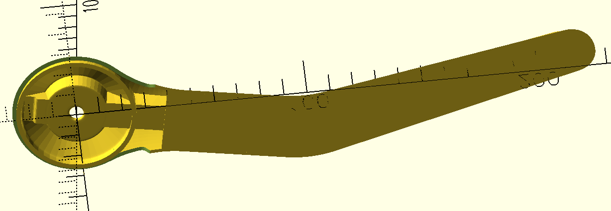

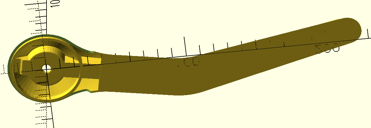

I just have to ask -- what is that part, and what does it do?  Also, is the
end naturally bent like that, or has it been warn and twisted.
Others have walked you through different ways of making this in OpenSCAD.
I would have also asked how well did it scan, and then offer some
suggestions -- paint it with a light color water-based paint (off-white),
and then speckle it with multi-colored dots and lines.  3 to 5 different
colors is best.  Also, if you play with the lighting to get different deep
shadows, this will also help you get good scans.  There are all sorts of
trick like this to scan.
Another, more old-school, was of doing this is to carefully measure
different transitions -- like from the half-circle of the head, to the
straight profile.  Once you had a cross-section measurement, you can make
sweeps, triangles, rectangles, etc.
Best of luck!

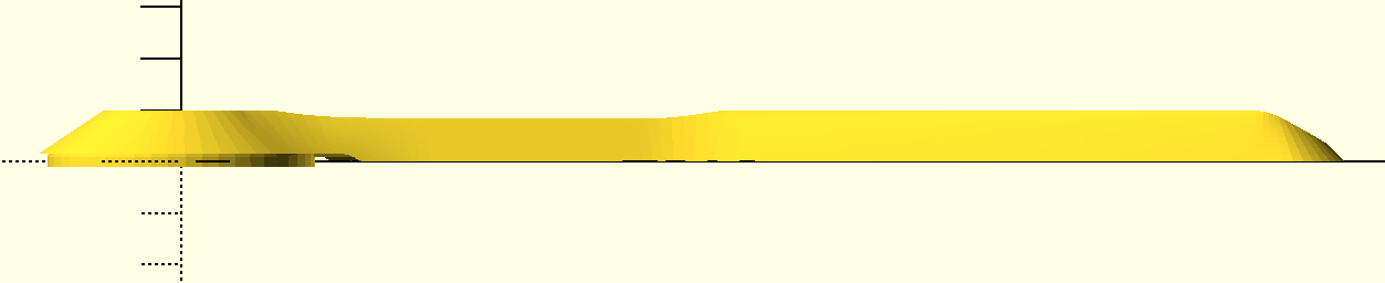

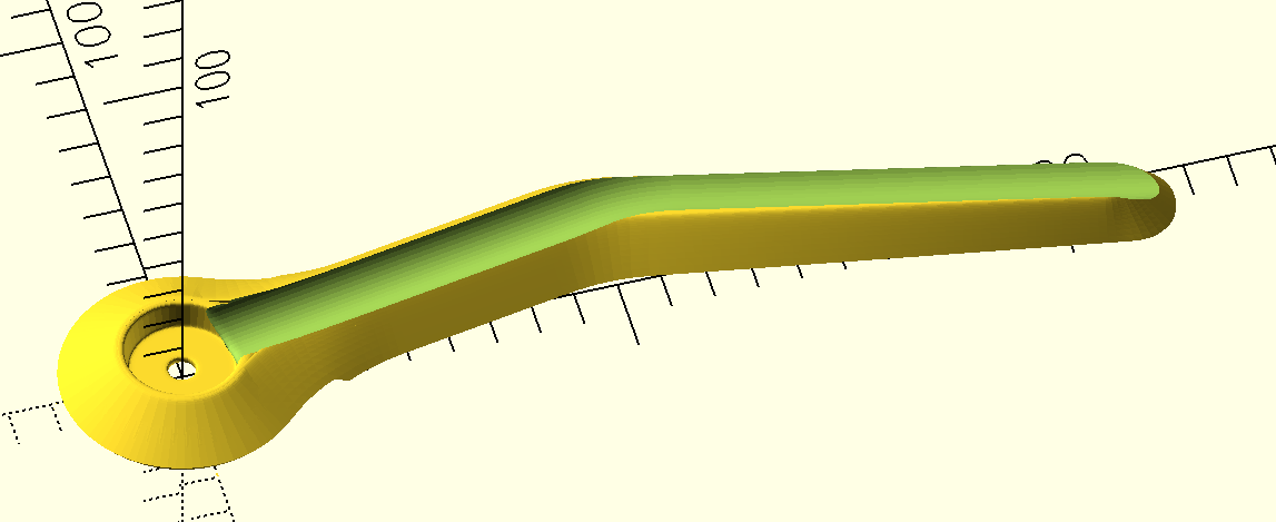

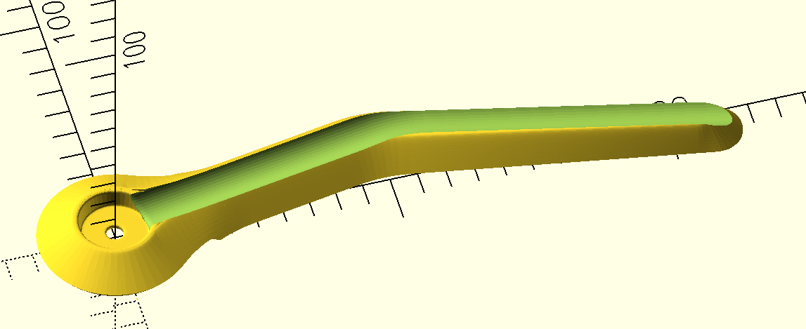

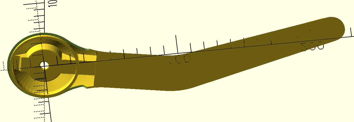

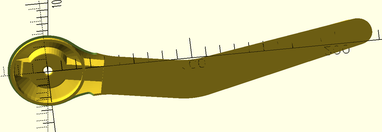

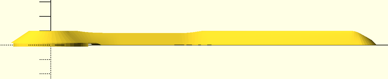

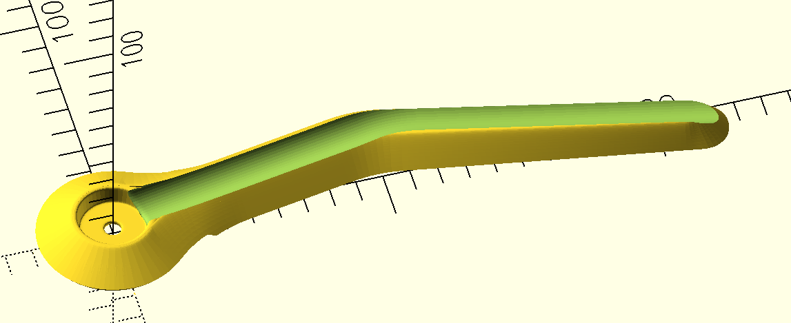

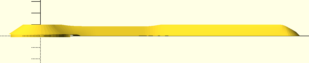

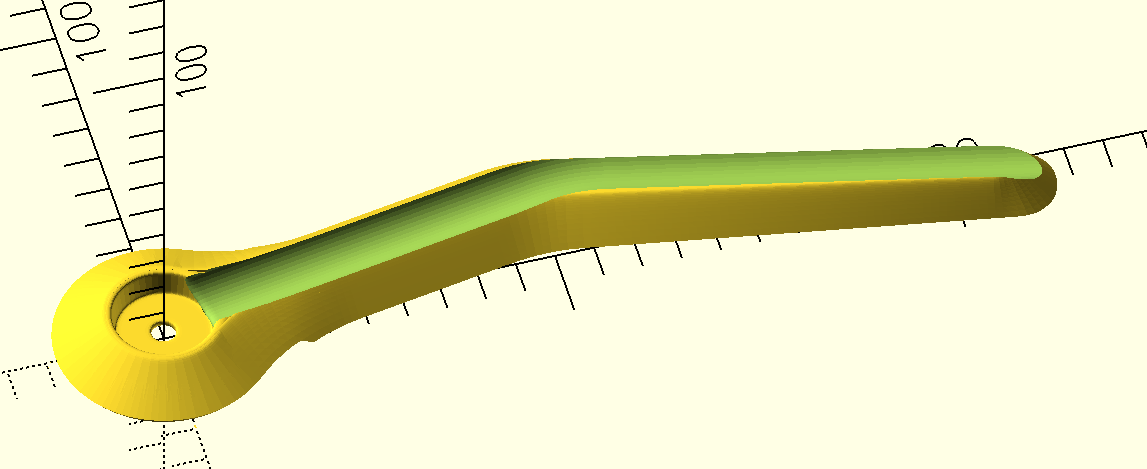

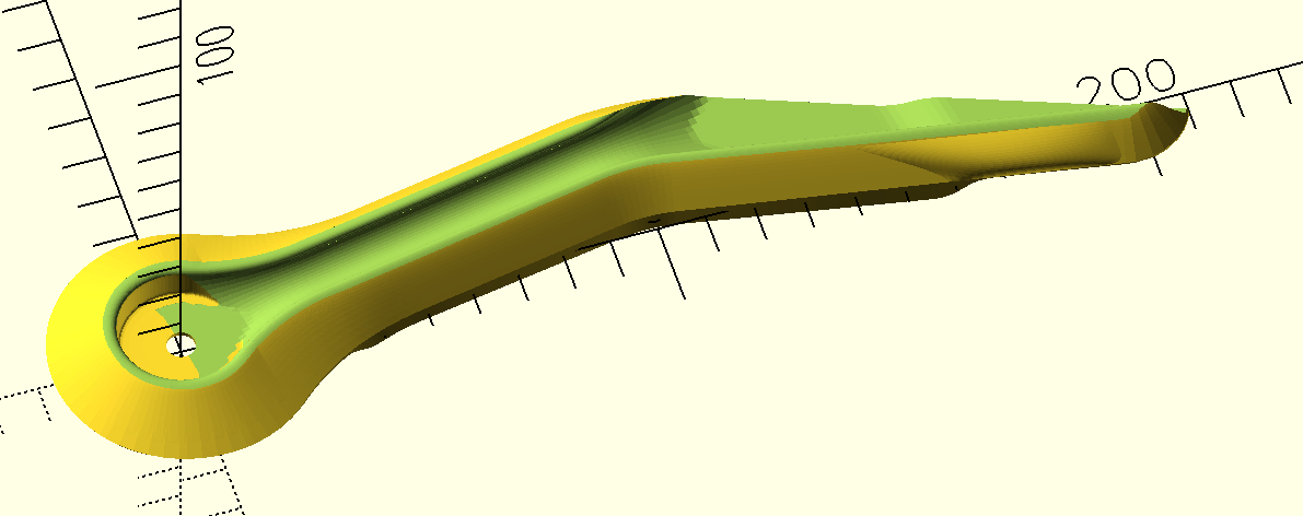

I tried this today and it took a while
very difficult
posted the scad file: it is 1.6 mb (strange_shape.scad)
https://github.com/sprabhakar2006/openSCAD/blob/main/strange_shape.scad
https://urldefense.proofpoint.com/v2/url?u=https-3A__github.com_sprabhakar2006_openSCAD_blob_main_strange-5Fshape.scad&d=DwMFaQ&c=euGZstcaTDllvimEN8b7jXrwqOf-v5A_CdpgnVfiiMM&r=AsrE-c7ZR7B2Kyr3qgfvvppkCEBVsNmwEMndcrRSuOI&m=9Vu-I-8lkbmP2hkkNkZhZEquxy-DGAf7E0uatGsET1tdBD4kP8Ltr6N0UmCTS-m4&s=FoY3gJudRGyPkmPBkF9EtixlL47PTgipiosfMTg4Id0&e=
associated_python code is attached
[image: Screenshot 2026-06-06 at 9.10.37 PM.png]
[image: Screenshot 2026-06-06 at 9.12.14 PM.png]
[image: Screenshot 2026-06-06 at 9.11.34 PM.png]

I was asked to model the handle shown in this brief video:
https://youtu.be/2Cl6_5Co-L4
https://urldefense.proofpoint.com/v2/url?u=https-3A__youtu.be_2Cl6-5F5Co-2DL4&d=DwMFaQ&c=euGZstcaTDllvimEN8b7jXrwqOf-v5A_CdpgnVfiiMM&r=AsrE-c7ZR7B2Kyr3qgfvvppkCEBVsNmwEMndcrRSuOI&m=PCh_CDD_4ZaWo2eqN5GZU2oDJPZRmy4wmw_LBJfS4y31P0aivtBb1TA-HPEy-XTe&s=RuNeweI0Jbo4vsEmcA9KQPXahlcgRZsdaWI3e_hOoKA&e=
I did a 3D scan, which produced a recognizable version of the handle,
but not anything I would give to a customer.  Attempts at improving
things using sculpting software (SculptGL) helped a bit, but the scan
seems to have a lot of internal errors (voids inside the object) which
were revealed when I sliced the scan for printing.
It may well be that modeling this in OS is impossible, but I wondered
if
anyone had an approach that they would suggest. The handle need not be
an exact replica, but at least something that is not embarrassing.  Of
course, the so-created handle could well interfere with other parts of
the assembly (that is, the exact shape may be due to parts around the
actuation path of the handle).
Note that the counterbore at the non-pointy end, and the six slanted
nubs and the through hole are easy enough to model.  It is the graceful
shape that eludes me.
Thanks!

Sat, Jun 6, 2026 9:21 PM
This handle is used to elevate a pneumatic seat in a modern Ferrari.  The shape is pristine, not distorted or bent.  I ended up spraying it with foot powder to make the scan, which went OK.  The reason I gave up was that, after printing a sample, it became clear to me that I would be unable to make a really good print, because some side was going to have to be down, and thus supported.  I know of no FDM printer that prints perfect surfaces above support structures.  Good surfaces, yes, but not perfect.  The top surface would be seen by the customer, so it needed to look good; the bottom surface had some functional nibs on it, and needed to be perfect.  And the gentle curves led to a lot of stair stepping.  A challenge all around.

This handle is used to elevate a pneumatic seat in a modern Ferrari. The shape is pristine, not distorted or bent. I ended up spraying it with foot powder to make the scan, which went OK. The reason I gave up was that, after printing a sample, it became clear to me that I would be unable to make a really good print, because some side was going to have to be down, and thus supported. I know of no FDM printer that prints perfect surfaces above support structures. Good surfaces, yes, but not perfect. The top surface would be seen by the customer, so it needed to look good; the bottom surface had some functional nibs on it, and needed to be perfect. And the gentle curves led to a lot of stair stepping. A challenge all around. Jon On 6/6/2026 3:57 PM, John David wrote: I just have to ask -- what is that part, and what does it do? Also, is the end naturally bent like that, or has it been warn and twisted. Others have walked you through different ways of making this in OpenSCAD. I would have also asked how well did it scan, and then offer some suggestions -- paint it with a light color water-based paint (off-white), and then speckle it with multi-colored dots and lines. 3 to 5 different colors is best. Also, if you play with the lighting to get different deep shadows, this will also help you get good scans. There are all sorts of trick like this to scan. Another, more old-school, was of doing this is to carefully measure different transitions -- like from the half-circle of the head, to the straight profile. Once you had a cross-section measurement, you can make sweeps, triangles, rectangles, etc. Best of luck! EBo -- On Sat, Jun 6, 2026 at 2:03 PM jon jonbondy.com<https://urldefense.proofpoint.com/v2/url?u=http-3A__jonbondy.com&d=DwMFaQ&c=euGZstcaTDllvimEN8b7jXrwqOf-v5A_CdpgnVfiiMM&r=AsrE-c7ZR7B2Kyr3qgfvvppkCEBVsNmwEMndcrRSuOI&m=3sue_gBU8Fo2G35LIkv7_lqGFX9Iw4H_FFYPQv6VPOVfET4b6iru2UwoU1qovXUg&s=j1rVBTqGYuPaLIVmxsph4dUyjj0E-Tw0lpeeMBrDyow&e=> via Discuss <discuss@lists.openscad.org<mailto:discuss@lists.openscad.org>> wrote: A very good likeness! On 6/6/2026 12:00 PM, Sanjeev Prabhakar wrote: I tried this today and it took a while very difficult posted the scad file: it is 1.6 mb (strange_shape.scad) https://github.com/sprabhakar2006/openSCAD/blob/main/strange_shape.scad<https://urldefense.proofpoint.com/v2/url?u=https-3A__github.com_sprabhakar2006_openSCAD_blob_main_strange-5Fshape.scad&d=DwMFaQ&c=euGZstcaTDllvimEN8b7jXrwqOf-v5A_CdpgnVfiiMM&r=AsrE-c7ZR7B2Kyr3qgfvvppkCEBVsNmwEMndcrRSuOI&m=9Vu-I-8lkbmP2hkkNkZhZEquxy-DGAf7E0uatGsET1tdBD4kP8Ltr6N0UmCTS-m4&s=FoY3gJudRGyPkmPBkF9EtixlL47PTgipiosfMTg4Id0&e=> associated_python code is attached [Screenshot 2026-06-06 at 9.10.37 PM.png] [Screenshot 2026-06-06 at 9.12.14 PM.png] [Screenshot 2026-06-06 at 9.11.34 PM.png] On Wed, 3 Jun 2026 at 06:03, Sanjeev Prabhakar <sprabhakar2006@gmail.com<mailto:sprabhakar2006@gmail.com>> wrote: OK no problem I will try On Wed, 3 Jun, 2026, 3:59 am jon jonbondy.com<https://urldefense.proofpoint.com/v2/url?u=http-3A__jonbondy.com&d=DwMFaQ&c=euGZstcaTDllvimEN8b7jXrwqOf-v5A_CdpgnVfiiMM&r=AsrE-c7ZR7B2Kyr3qgfvvppkCEBVsNmwEMndcrRSuOI&m=9Vu-I-8lkbmP2hkkNkZhZEquxy-DGAf7E0uatGsET1tdBD4kP8Ltr6N0UmCTS-m4&s=zyMJSqOUqMC-3SbFgiS8uQv2MjufDTZmgcG47vNgfys&e=>, <jon@jonbondy.com<mailto:jon@jonbondy.com>> wrote: The part is on its way back to its owner. All I can offer now is that you download the YouTube video and do some screen frame grabs. Jon On 6/2/2026 11:00 AM, Sanjeev Prabhakar wrote: Hi Jon, Can you post some still pictures of this handle? I want to give it a try this weekend Regards On Sat, 30 May 2026 at 22:03, Jon Bondy via Discuss <discuss@lists.openscad.org<mailto:discuss@lists.openscad.org>> wrote: I was asked to model the handle shown in this brief video: https://youtu.be/2Cl6_5Co-L4<https://urldefense.proofpoint.com/v2/url?u=https-3A__youtu.be_2Cl6-5F5Co-2DL4&d=DwMFaQ&c=euGZstcaTDllvimEN8b7jXrwqOf-v5A_CdpgnVfiiMM&r=AsrE-c7ZR7B2Kyr3qgfvvppkCEBVsNmwEMndcrRSuOI&m=PCh_CDD_4ZaWo2eqN5GZU2oDJPZRmy4wmw_LBJfS4y31P0aivtBb1TA-HPEy-XTe&s=RuNeweI0Jbo4vsEmcA9KQPXahlcgRZsdaWI3e_hOoKA&e=> I did a 3D scan, which produced a recognizable version of the handle, but not anything I would give to a customer. Attempts at improving things using sculpting software (SculptGL) helped a bit, but the scan seems to have a lot of internal errors (voids inside the object) which were revealed when I sliced the scan for printing. It may well be that modeling this in OS is impossible, but I wondered if anyone had an approach that they would suggest. The handle need not be an exact replica, but at least something that is not embarrassing. Of course, the so-created handle could well interfere with other parts of the assembly (that is, the exact shape may be due to parts around the actuation path of the handle). Note that the counterbore at the non-pointy end, and the six slanted nubs and the through hole are easy enough to model. It is the graceful shape that eludes me. Thanks! Jon -- This email has been checked for viruses by AVG antivirus software. www.avg.com<https://urldefense.proofpoint.com/v2/url?u=http-3A__www.avg.com&d=DwMFaQ&c=euGZstcaTDllvimEN8b7jXrwqOf-v5A_CdpgnVfiiMM&r=AsrE-c7ZR7B2Kyr3qgfvvppkCEBVsNmwEMndcrRSuOI&m=PCh_CDD_4ZaWo2eqN5GZU2oDJPZRmy4wmw_LBJfS4y31P0aivtBb1TA-HPEy-XTe&s=aIG_B2Jt4cW6KKAzsay5ILK6SlSoSJ0jK6YfLJWn4OU&e=> _______________________________________________ OpenSCAD mailing list To unsubscribe send an email to discuss-leave@lists.openscad.org<mailto:discuss-leave@lists.openscad.org> _______________________________________________ OpenSCAD mailing list To unsubscribe send an email to discuss-leave@lists.openscad.org<mailto:discuss-leave@lists.openscad.org>

Jon, being inside a car with the associated high temperature, I am assuming ASA filament, so would vapour-smoothing the finished handle with acetone have made it more acceptable? For example- https://www.3dsourced.com/rigid-ink/acetone-vapor-smooth-3d-prints-abs-asa/ On 7/6/26 07:21, jon jonbondy.com via Discuss wrote: > > This handle is used to elevate a pneumatic seat in a modern Ferrari.  The shape is pristine, not distorted or bent.  I ended up spraying it with foot powder to make the scan, which went OK.  The reason I gave up was that, after printing a sample, it became clear to me that I would be unable to make a really good print, because some side was going to have to be down, and thus supported.  I know of no FDM printer that prints perfect surfaces above support structures.  Good surfaces, yes, but not perfect.  The top surface would be seen by the customer, so it needed to look good; the bottom surface had some functional nibs on it, and needed to be perfect.  And the gentle curves led to a lot of stair stepping.  A challenge all around. > > Jon > > > On 6/6/2026 3:57 PM, John David wrote: >> I just have to ask -- what is that part, and what does it do?  Also, is the end naturally bent like that, or has it been warn and twisted. >> >> Others have walked you through different ways of making this in OpenSCAD.  I would have also asked how well did it scan, and then offer some suggestions -- paint it with a light color water-based paint (off-white), and then speckle it with multi-colored dots and lines.  3 to 5 different colors is best.  Also, if you play with the lighting to get different deep shadows, this will also help you get good scans.  There are all sorts of trick like this to scan. >> >> Another, more old-school, was of doing this is to carefully measure different transitions -- like from the half-circle of the head, to the straight profile.  Once you had a cross-section measurement, you can make sweeps, triangles, rectangles, etc. >> >> Best of luck! >> >>   EBo -- >> >> On Sat, Jun 6, 2026 at 2:03 PM jon jonbondy.com <https://urldefense.proofpoint.com/v2/url?u=http-3A__jonbondy.com&d=DwMFaQ&c=euGZstcaTDllvimEN8b7jXrwqOf-v5A_CdpgnVfiiMM&r=AsrE-c7ZR7B2Kyr3qgfvvppkCEBVsNmwEMndcrRSuOI&m=3sue_gBU8Fo2G35LIkv7_lqGFX9Iw4H_FFYPQv6VPOVfET4b6iru2UwoU1qovXUg&s=j1rVBTqGYuPaLIVmxsph4dUyjj0E-Tw0lpeeMBrDyow&e=> via Discuss <discuss@lists.openscad.org> wrote: >> >> A very good likeness! >> >> >> On 6/6/2026 12:00 PM, Sanjeev Prabhakar wrote: >>> I tried this today and it took a while >>> very difficult >>> posted the scad file: it is 1.6 mb (strange_shape.scad) >>> https://github.com/sprabhakar2006/openSCAD/blob/main/strange_shape.scad <https://urldefense.proofpoint.com/v2/url?u=https-3A__github.com_sprabhakar2006_openSCAD_blob_main_strange-5Fshape.scad&d=DwMFaQ&c=euGZstcaTDllvimEN8b7jXrwqOf-v5A_CdpgnVfiiMM&r=AsrE-c7ZR7B2Kyr3qgfvvppkCEBVsNmwEMndcrRSuOI&m=9Vu-I-8lkbmP2hkkNkZhZEquxy-DGAf7E0uatGsET1tdBD4kP8Ltr6N0UmCTS-m4&s=FoY3gJudRGyPkmPBkF9EtixlL47PTgipiosfMTg4Id0&e=> >>> >>> associated_python code is attached >>> Screenshot 2026-06-06 at 9.10.37 PM.png >>> Screenshot 2026-06-06 at 9.12.14 PM.png >>> Screenshot 2026-06-06 at 9.11.34 PM.png >>> >>> >>> On Wed, 3 Jun 2026 at 06:03, Sanjeev Prabhakar <sprabhakar2006@gmail.com> wrote: >>> >>> OK no problem >>> I will try >>> >>> On Wed, 3 Jun, 2026, 3:59 am jon jonbondy.com <https://urldefense.proofpoint.com/v2/url?u=http-3A__jonbondy.com&d=DwMFaQ&c=euGZstcaTDllvimEN8b7jXrwqOf-v5A_CdpgnVfiiMM&r=AsrE-c7ZR7B2Kyr3qgfvvppkCEBVsNmwEMndcrRSuOI&m=9Vu-I-8lkbmP2hkkNkZhZEquxy-DGAf7E0uatGsET1tdBD4kP8Ltr6N0UmCTS-m4&s=zyMJSqOUqMC-3SbFgiS8uQv2MjufDTZmgcG47vNgfys&e=>, <jon@jonbondy.com> wrote: >>> >>> The part is on its way back to its owner. All I can offer now is that you download the YouTube video and do some screen frame grabs. >>> >>> Jon >>> >>> >>> On 6/2/2026 11:00 AM, Sanjeev Prabhakar wrote: >>>> Hi Jon, >>>> Can you post some still pictures of this handle? >>>> I want to give it a try this weekend >>>> Regards >>>> >>>> On Sat, 30 May 2026 at 22:03, Jon Bondy via Discuss <discuss@lists.openscad.org> wrote: >>>> >>>> I was asked to model the handle shown in this brief video: >>>> >>>> https://youtu.be/2Cl6_5Co-L4 <https://urldefense.proofpoint.com/v2/url?u=https-3A__youtu.be_2Cl6-5F5Co-2DL4&d=DwMFaQ&c=euGZstcaTDllvimEN8b7jXrwqOf-v5A_CdpgnVfiiMM&r=AsrE-c7ZR7B2Kyr3qgfvvppkCEBVsNmwEMndcrRSuOI&m=PCh_CDD_4ZaWo2eqN5GZU2oDJPZRmy4wmw_LBJfS4y31P0aivtBb1TA-HPEy-XTe&s=RuNeweI0Jbo4vsEmcA9KQPXahlcgRZsdaWI3e_hOoKA&e=> >>>> >>>> I did a 3D scan, which produced a recognizable version of the handle, >>>> but not anything I would give to a customer.  Attempts at improving >>>> things using sculpting software (SculptGL) helped a bit, but the scan >>>> seems to have a lot of internal errors (voids inside the object) which >>>> were revealed when I sliced the scan for printing. >>>> >>>> It may well be that modeling this in OS is impossible, but I wondered if >>>> anyone had an approach that they would suggest. The handle need not be >>>> an exact replica, but at least something that is not embarrassing.  Of >>>> course, the so-created handle could well interfere with other parts of >>>> the assembly (that is, the exact shape may be due to parts around the >>>> actuation path of the handle). >>>> >>>> Note that the counterbore at the non-pointy end, and the six slanted >>>> nubs and the through hole are easy enough to model.  It is the graceful >>>> shape that eludes me. >>>> >>>> Thanks! >>>> >>>> Jon >>>> >>>> >>>> -- >>>> This email has been checked for viruses by AVG antivirus software. >>>> www.avg.com <https://urldefense.proofpoint.com/v2/url?u=http-3A__www.avg.com&d=DwMFaQ&c=euGZstcaTDllvimEN8b7jXrwqOf-v5A_CdpgnVfiiMM&r=AsrE-c7ZR7B2Kyr3qgfvvppkCEBVsNmwEMndcrRSuOI&m=PCh_CDD_4ZaWo2eqN5GZU2oDJPZRmy4wmw_LBJfS4y31P0aivtBb1TA-HPEy-XTe&s=aIG_B2Jt4cW6KKAzsay5ILK6SlSoSJ0jK6YfLJWn4OU&e=> >>>> _______________________________________________ >>>> OpenSCAD mailing list >>>> To unsubscribe send an email to discuss-leave@lists.openscad.org >>>> >> _______________________________________________ >> OpenSCAD mailing list >> To unsubscribe send an email to discuss-leave@lists.openscad.org >> > > _______________________________________________ > OpenSCAD mailing list > To unsubscribe send an email todiscuss-leave@lists.openscad.org -- Cheers, Ken bats059@gmail.com https://vk7krj.com https://vk7krj.com/running.html ---------------------------------------- A baby can be defined as an ego with a noise at one end and a smell at the other. Your job as parents is to teach them to control all three. My job as a grandad is to tell you how you are doing it all wrong!
Sun, Jun 7, 2026 8:48 AM
Also if you can do a support interface layer in soluble filament then it
can be fully dense and fully in contact with the part. That would leave no
blemishes.
On Sun, 7 Jun 2026 at 03:16, Ken via Discuss discuss@lists.openscad.org
For example-

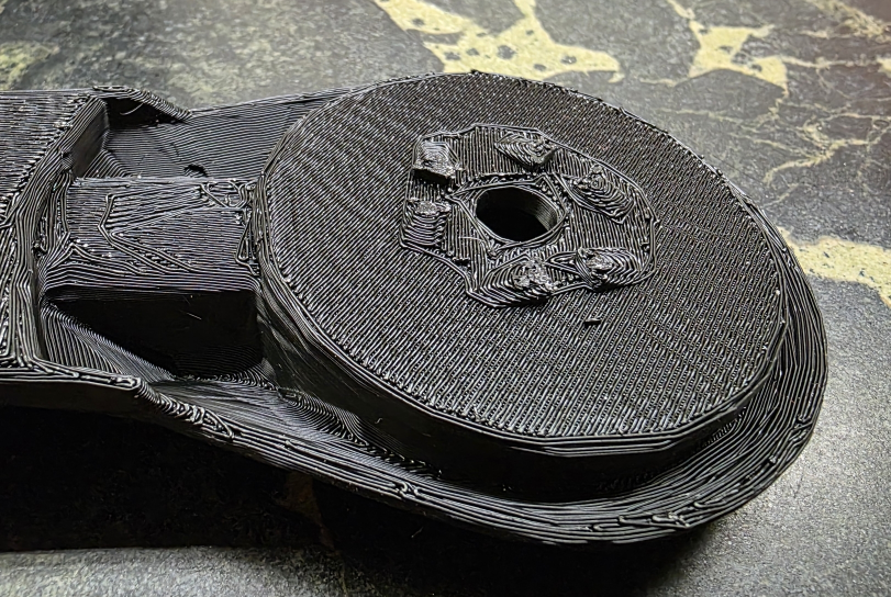

around.
very difficult

I considered a variety of post processing techniques (sanding, epoxy
coating), but the printer was barely able to print the details required
for the "nubs".  I think it was just not meant to be.  This was at 0.2
mm layer height, so more detail was possible, but surfaces above support
are never pretty, just occasionally tolerable.

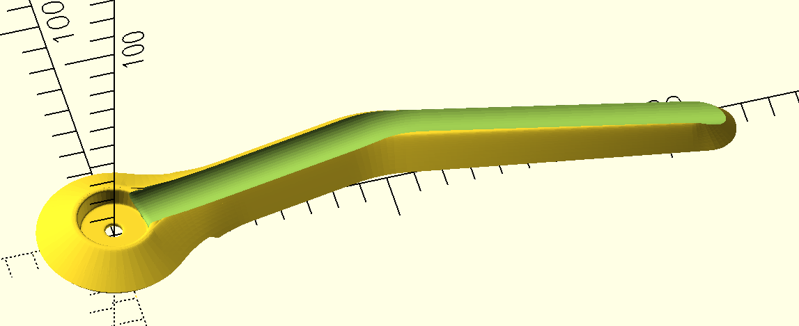

very difficult

On 6/7/2026 12:01 PM, larry via Discuss wrote:
required for the "nubs".  I think it was just not meant to be.  This
was at 0.2 mm layer height, so more detail was possible, but surfaces
above support are never pretty, just occasionally tolerable.

Larry: Thanks.  I do not have a problem removing supports when printed on my Bambu printers, but the surface quality of the print is always worse above support than above the build plate or on the top surface. Jon On 6/7/2026 12:01 PM, larry via Discuss wrote: > On Sun, 2026-06-07 at 08:48 -0400, Jon Bondy via Discuss wrote: >> I considered a variety of post processing techniques (sanding, epoxy >> coating), but the printer was barely able to print the details >> required for the "nubs". I think it was just not meant to be. This >> was at 0.2 mm layer height, so more detail was possible, but surfaces >> above support are never pretty, just occasionally tolerable. > Here's something that made my support surfaces very nice, and that was > using only one filament for model and supports. It's was for a Bambu > Lab printer, but I think it's generic enough to be worth trying on any > printer. > > Cribbed from TotalWarHammer, from a post on Reddit > > GUIDE: How to produce easy to remove supports every time... > > <snip> -- This email has been checked for viruses by AVG antivirus software. www.avg.com
Mon, Jun 8, 2026 11:40 AM
You probably need less gap between the support and the layer above. That
will make them harder to remove but leave a better layer above.

Mon, Jun 8, 2026 7:48 PM
If you have an AMS you can print the topmost support layers in a different material (PETG when the model is PLA). Doing so you can totally omit the gap and get a perfectly smooth supported surface. This works because PLA and PETG don't connect well when printed on top of each other.
See https://www.youtube.com/watch?v=KVi2z1ODdBM for an example.

Sun, Jun 21, 2026 11:31 AM

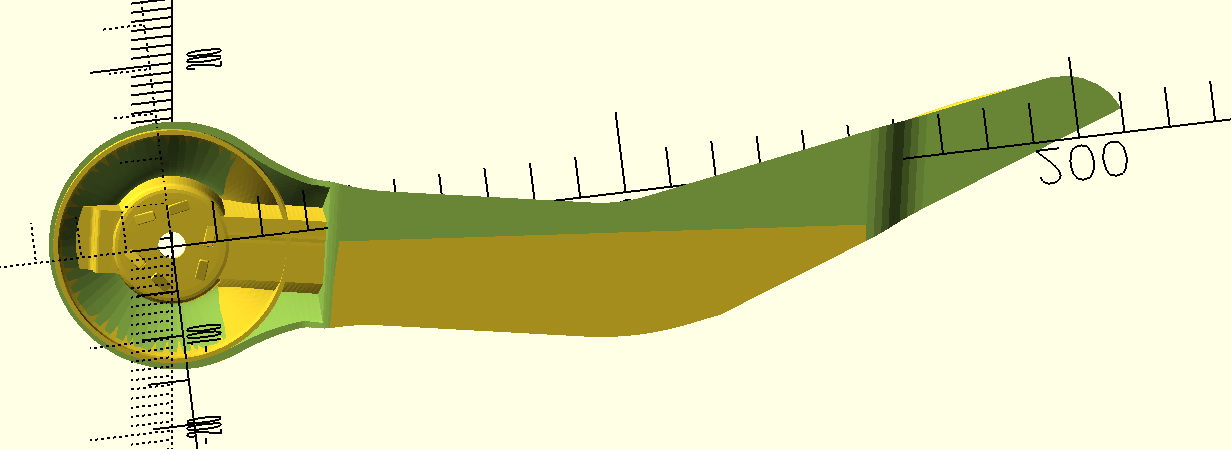

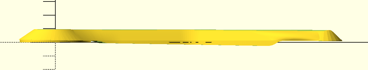

I had another attempt at this strange shape yesterday and this time it is a
slightly more respectable copy. It's amazing to see the power of python
[image: Screenshot 2026-06-20 at 10.10.45 PM.png]
[image: Screenshot 2026-06-20 at 10.11.30 PM.png]
[image: Screenshot 2026-06-20 at 10.12.04 PM.png]
If anyone wants to try
the scad file can be downloaded from :
python code can be downloaded from:
https://github.com/sprabhakar2006/openSCAD/blob/main/strange_shape.txt
I had another attempt at this strange shape yesterday and this time it is a slightly more respectable copy. It's amazing to see the power of python [image: Screenshot 2026-06-20 at 10.10.45 PM.png] [image: Screenshot 2026-06-20 at 10.11.30 PM.png] [image: Screenshot 2026-06-20 at 10.12.04 PM.png] If anyone wants to try the scad file can be downloaded from : https://github.com/sprabhakar2006/openSCAD/blob/main/strange_shape.scad python code can be downloaded from: https://github.com/sprabhakar2006/openSCAD/blob/main/strange_shape.txt >
