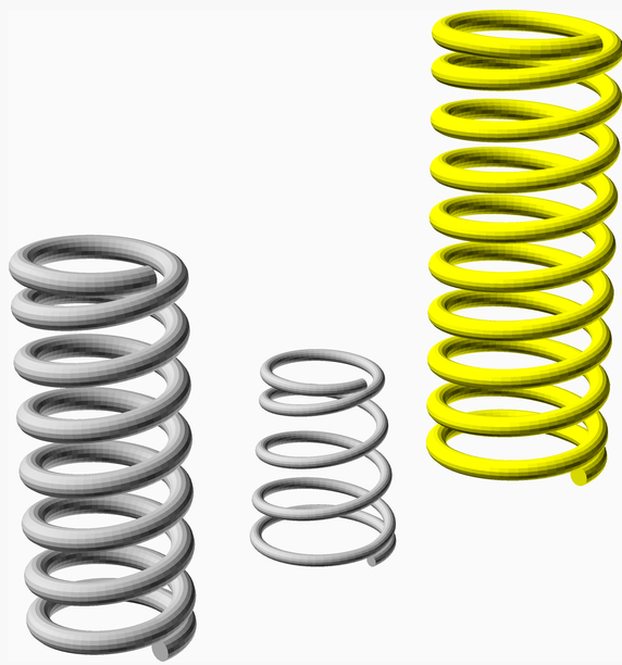

Jordan posted a detailed description of the banana shaped cross section you need to make a helix with linear extrude and twist. Definitely not a circle or an ellipse. On Fri, Oct 25, 2024 at 14:44 nop head via Discuss < discuss@lists.openscad.org> wrote: > If you are using sweep the profile is just a circle but if you are linear > extruding with a twist then the profile is what you would get if you slice > a spiral spring horizontally. That isn't an ellipse. An ellipse is what you > would get if you sliced an inclined cylinder but a helix bends so it's > cross section is an ellipse bent around the helix diameter. > > On Fri, 25 Oct 2024, 19:12 Father Horton via Discuss, < > discuss@lists.openscad.org> wrote: > >> I think what he wants is what you’d get if you wrapped a wire with a >> circular cross section around a cylinder. And I think that’s what this will >> produce. >> >> On Fri, Oct 25, 2024 at 12:28 PM nop head via Discuss < >> discuss@lists.openscad.org> wrote: >> >>> I don't think that is quite right because if you slice a helix you don't >>> get an ellipse. It is an ellipse bent around the circle of the spiral. >>> >>> On Fri, 25 Oct 2024 at 18:10, Father Horton via Discuss < >>> discuss@lists.openscad.org> wrote: >>> >>>> Let d be the diameter of the circle and alpha be the angle of the >>>> helix. Then create a circle of diameter d, scale it by [1, >>>> 1/cos(90-alpha)], and linear_extrude that. I think that’s what you want. >>>> >>>> On Fri, Oct 25, 2024 at 11:43 AM gene heskett via Discuss < >>>> discuss@lists.openscad.org> wrote: >>>> >>>>> On 10/25/24 07:36, mike.fraser.1945+osc--- via Discuss wrote: >>>>> > Morning folks, >>>>> > >>>>> > Is there any way to create a helix with a circular cross-section? I >>>>> have >>>>> > tried linear_extrude with both a circle & various ovals as input. >>>>> I’ve >>>>> > tried various BOLS2 threading functions. I can get the helix easily >>>>> but >>>>> > not with a smooth circle cross-section. >>>>> > >>>>> I am doing this in both linuxcnc and in openscad, by rendering each >>>>> "slice" of a buttress thread at a slight tilt angle, thereby blending >>>>> the resultant surface areas effectively at the thread angle. Actually >>>>> its rendered once, then rotated into place. Speeds rendering when the >>>>> spiral is 20 turns of the screw long in 2 start and the slice is a >>>>> half >>>>> a degree thick. More than one way to skin that cat. ;o)> >>>>> Gene. >>>>> > Mike >>>>> > >>>>> > >>>>> > _______________________________________________ >>>>> > OpenSCAD mailing list >>>>> > To unsubscribe send an email to discuss-leave@lists.openscad.org >>>>> >>>>> Cheers, Gene Heskett, CET. >>>>> -- >>>>> "There are four boxes to be used in defense of liberty: >>>>> soap, ballot, jury, and ammo. Please use in that order." >>>>> -Ed Howdershelt (Author, 1940) >>>>> If we desire respect for the law, we must first make the law >>>>> respectable. >>>>> - Louis D. Brandeis >>>>> _______________________________________________ >>>>> OpenSCAD mailing list >>>>> To unsubscribe send an email to discuss-leave@lists.openscad.org >>>>> >>>> _______________________________________________ >>>> OpenSCAD mailing list >>>> To unsubscribe send an email to discuss-leave@lists.openscad.org >>>> >>> _______________________________________________ >>> OpenSCAD mailing list >>> To unsubscribe send an email to discuss-leave@lists.openscad.org >>> >> _______________________________________________ >> OpenSCAD mailing list >> To unsubscribe send an email to discuss-leave@lists.openscad.org >> > _______________________________________________ > OpenSCAD mailing list > To unsubscribe send an email to discuss-leave@lists.openscad.org >
Fri, Oct 25, 2024 7:19 PM
https://lists.openscad.org/empathy/thread/DC2WDIIZS57SIDWVAVKDN3NEN4MOZOYM
Hans did the same thing much earlier in a Thingiverse post.

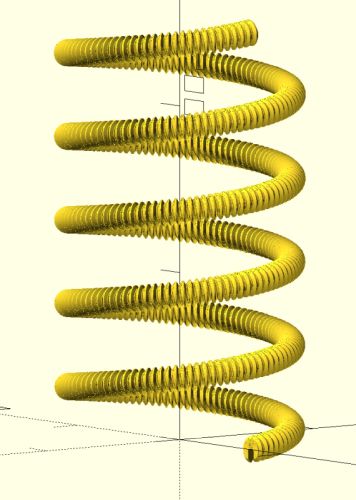

I realize I am late to the party, but here is what I sometimes do when I
need to create some sort of helical feature. Any convex 2D geometry (in
this case a circle) can be passed as a child to the helix module and it
stitches together a number of thin slices of the profile via calls to
hull():
// extrude a helix with radius 'Radius', N revolutions, pitch
module helix (Radius, N, pitch, fa=10, eps=1e-3) {
for (i=[0:N360/fa-1]) {
hull() {
rotate([0, 0, i
fa])
translate([Radius, 0, pitchifa/360])
rotate([90+180*(pitch/(23.14Radius))/3.14, 0, 0])
linear_extrude(height=eps, center=true) children();
rotate([0, 0, (i+1)fa])
(i+1)fa/360])
rotate([90+180
helix(Radius=4, N=4, pitch=3, fa=5) circle(r=1, $fn=30);

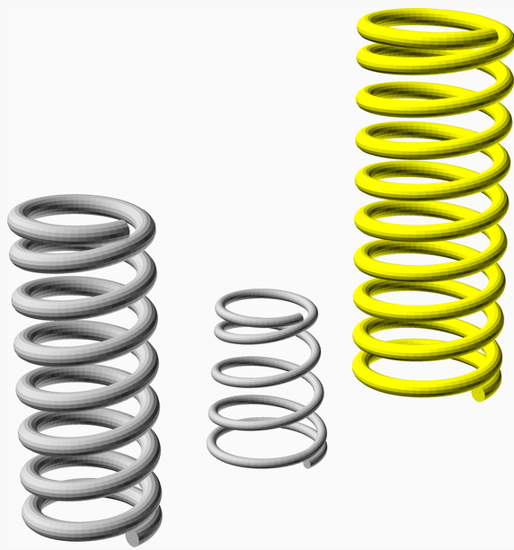

These are all made by sweeping a circle on a helical path. Much easier than
using linear_extrude with a  twist.
