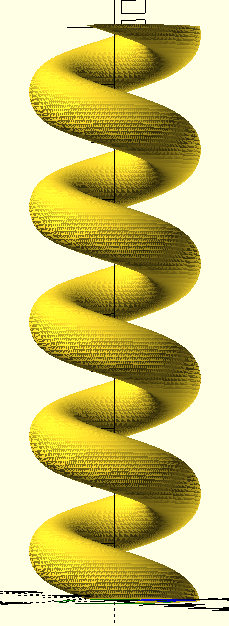

[ This was a math puzzle.  It's almost certainly not the right way to
generate a helix. I thought others might find it interesting. ]
Everybody knows that you can't generate a helix with linear_extrude.
Linear extrude works with horizontal cross sections, and a proper helix
needs a circle (or whatever shape) that's tilted to perpendicular to the
angle of the helix.  You end up with something like so:

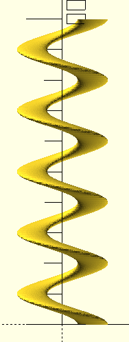

Some time back, I realized that you could generate a helix with linear
extrude.  The problem is that the horizontal cross-section isn't
simple.  It's sort of banana-shaped:
But what is that shape?
I got interested in this question again, and played with the idea that
it's a circle that's been stretched around the circumference of the helix.
I tried translating it into polar coordinates and scaling theta by
1/sin(helix angle), and although I'm not sure that it's absolutely
right, the result is pretty good:
Here's a cross-section perpendicular to the helix angle:
Perfect circle?  Maybe, maybe not.  I'm not sure that I cut the
cross-section at exactly the right point, or took the screen shot from
the right angle.

p[0] * cos(p[1]),
p[0] * sin(p[1])
function topolar2(p) = [
norm(p),
atan2(p.y, p.x)
// Helix angle
helix_a = atan2(pitch, helix_r2PI);
// degrees per unit, along the circumference
theta_scale = 360/(2PIhelix_r);
// Banana, algorithm A
bananaA = function() [
for (a=[0:359])
torect2([helix_r, 0] + [r*cos(a), r * sin(a) * theta_scale / sin(helix_a)])
// Banana, algorithm B
bananaB = function() [
for (a=[0:359])
let(circ = torect2([r, a]))        // circle
let(tcirc = circ + [helix_r, 0])    // translated
let(pcirc = topolar2(tcirc))        // in polar coords
let(smeared_circ = [pcirc[0], pcirc[1]/sin(helix_a)])
torect2(smeared_circ)
// Simple circle, for comparison
circle = function() [
for (a=[0:359])
torect2([r, a]) + [helix_r, 0]
functions = [ bananaA, bananaB, circle ];
module helix() {
linear_extrude(height=h, twist=360*h/pitch, convexity=2)
polygon(functionsalgorithm);
if (intersect) {
#helix();
translate([helix_r, 0, pitch]) rotate([-helix_a,0,0]) cube([r2, 0.01, r2], center=true);
} else {
helix();
// A few reference shapes
// A circle.  If helix_a is 90, this should match the bottom of the helix.
color("blue") translate([helix_r,0,-0.1]) linear_extrude(height=0.1) circle(r=r);
// The circumference of the helix.
color("green") translate([0,0,-0.2]) linear_extrude(height=0.1) difference() { circle(r=helix_r+0.1); circle(r=helix_r-0.1); }
I am absolutely stunned that it's possible to create a flat cross-section such that the final result looks correctly, when extruded! However, I feel a helix would look more natural when the top/bottom face of the helix would be normal to the natural extrusion. Being able to tilt the extruded 2d shape has its justification :) On Tue, Feb 27, 2024 at 11:50 PM Hans L via Discuss < discuss@lists.openscad.org> wrote: > Here is my solution from ~8.5 yrs ago > https://www.thingiverse.com/thing:1098806 > > On Mon, Feb 26, 2024 at 11:59 PM Jordan Brown via Discuss < > discuss@lists.openscad.org> wrote: > >> [ This was a math puzzle. It's almost certainly not the *right* way to >> generate a helix. I thought others might find it interesting. ] >> >> Everybody knows that you can't generate a helix with linear_extrude. >> Linear extrude works with horizontal cross sections, and a proper helix >> needs a circle (or whatever shape) that's tilted to perpendicular to the >> angle of the helix. You end up with something like so: >> >> >> >> Some time back, I realized that you *could* generate a helix with linear >> extrude. The problem is that the horizontal cross-section isn't simple. >> It's sort of banana-shaped: >> >> >> But what *is* that shape? >> >> I got interested in this question again, and played with the idea that >> it's a circle that's been stretched around the circumference of the helix. >> >> I tried translating it into polar coordinates and scaling theta by >> 1/sin(helix angle), and although I'm not sure that it's absolutely right, >> the result is pretty good: >> >> >> >> Here's a cross-section perpendicular to the helix angle: >> >> >> Perfect circle? Maybe, maybe not. I'm not sure that I cut the >> cross-section at exactly the right point, or took the screen shot from the >> right angle. >> >> Here's the demo program, intended for use with the customizer. The best >> algorithm, A, is in bananaA(). bananaB() is a different way to stretch the >> circle that doesn't really work, but I don't understand why not because I >> can't think well in polar coordinates. circle() is a straightforward >> circle, like you would get from the "doesn't work" linear extrude >> solution. (And yes, of course if I was really trying to write a helix >> function everything would be an argument, not a global.) >> >> // Vertical distance from the centerline of one turn to the centerline of the next turn >> pitch = 20; >> // Radius of the helix, from XY=0 to the centerline of the extruded circle >> helix_r = 15; >> // Radius of the extruded circle >> r = 5; >> // Height of the helix >> h = 100; >> // Show cross-section (view from -Y orthogonal) >> intersect = false; >> // Which algorithm to use (a is best, b is interesting but not as good, 2 is simple circle) >> algorithm = 0; // [ 0: a, 1: b, 2: circle ] >> >> module stop(); >> >> // This is a little interesting to animate: >> // pitch = 20 + 10*abs($t*2-1); >> >> function torect2(p) = [ >> p[0] * cos(p[1]), >> p[0] * sin(p[1]) >> ]; >> function topolar2(p) = [ >> norm(p), >> atan2(p.y, p.x) >> ]; >> >> // Helix angle >> helix_a = atan2(pitch, helix_r*2*PI); >> >> // degrees per unit, along the circumference >> theta_scale = 360/(2*PI*helix_r); >> >> // Banana, algorithm A >> bananaA = function() [ >> for (a=[0:359]) >> torect2([helix_r, 0] + [r*cos(a), r * sin(a) * theta_scale / sin(helix_a)]) >> ]; >> >> // Banana, algorithm B >> bananaB = function() [ >> for (a=[0:359]) >> let(circ = torect2([r, a])) // circle >> let(tcirc = circ + [helix_r, 0]) // translated >> let(pcirc = topolar2(tcirc)) // in polar coords >> let(smeared_circ = [pcirc[0], pcirc[1]/sin(helix_a)]) >> torect2(smeared_circ) >> ]; >> >> // Simple circle, for comparison >> circle = function() [ >> for (a=[0:359]) >> torect2([r, a]) + [helix_r, 0] >> ]; >> >> functions = [ bananaA, bananaB, circle ]; >> >> module helix() { >> linear_extrude(height=h, twist=360*h/pitch, convexity=2) >> polygon(functions[algorithm]()); >> } >> >> if (intersect) { >> intersection() { >> #helix(); >> translate([helix_r, 0, pitch]) rotate([-helix_a,0,0]) cube([r*2, 0.01, r*2], center=true); >> } >> } else { >> helix(); >> } >> >> // A few reference shapes >> >> // A circle. If helix_a is 90, this should match the bottom of the helix. >> color("blue") translate([helix_r,0,-0.1]) linear_extrude(height=0.1) circle(r=r); >> >> // The circumference of the helix. >> color("green") translate([0,0,-0.2]) linear_extrude(height=0.1) difference() { circle(r=helix_r+0.1); circle(r=helix_r-0.1); } >> >> _______________________________________________ >> OpenSCAD mailing list >> To unsubscribe send an email to discuss-leave@lists.openscad.org >> > _______________________________________________ > OpenSCAD mailing list > To unsubscribe send an email to discuss-leave@lists.openscad.org >
