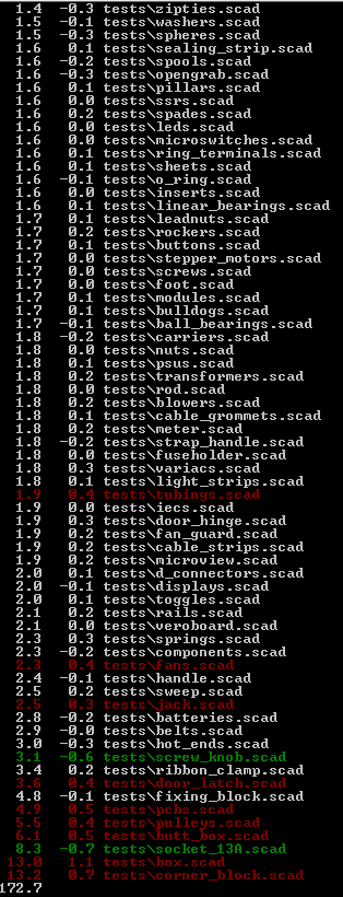

Sun, Apr 14, 2019 5:29 PM
To test my own library I time each test and store the results in a JSON
file. At the end of the test I show which got faster or slower by
significant amounts by showing the delta and colouring red and green and I
rank them by time. Here is the last run. As soon as I added this it
prompted me to start investigating how to make it go faster. It started at
972 seconds and now 172.3. It does vary a bit randomly as my PC is doing
other things. Perhaps the OpenSCAD test suite should do the same to
highlight how performance is changing.

On 14.04.19 19:29, nop head wrote:
Perhaps the OpenSCAD test suite should do the same to highlight
Yes, that's pretty much what I'm thinking too. But as we run tests
on various machines it's not that simple as we don't want to have
lots of random errors flagged just because we got a slower worker
VM assigned for a build.
That's why I hope we might be able handle that using a couple of
specific test cases which have a reasonable long run time and
compare those against some base line tests. That way it would
only trigger notifications in case the relative time is changing
a lot and not absolute runtime.

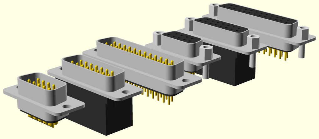

Sun, Apr 14, 2019 11:28 PM
Yes I measure the time to preview a large PNG using the command line. It is
about 1.5 seconds slower than F5 preview but I am exporting a 4096 x 4096
image. I do that because viewall is quite conservative and leaves a large
border. I then use image magick to trim the border and downsize it to 1280
width to give some anti-aliasing. The results look like this.
