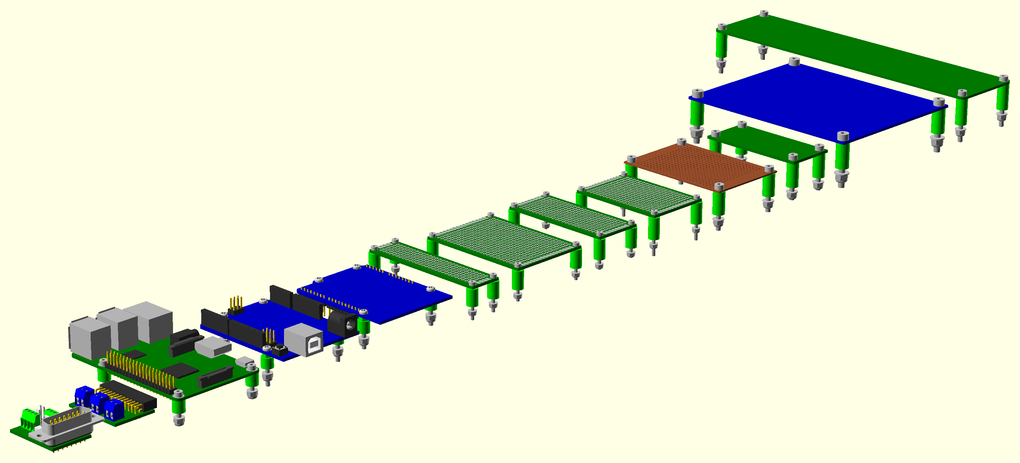

Yes but I have recently removed most of the renders. I now only have them
where there is a 3D difference or intersection. And I also rewrote
everything to avoid as many of those as possible by using unions of
linear_extrudes, rotate_extrudes and hulls.
The only render in this picture is for the solder bucket pins that are
hollow tubes with a 45 degree slice off the end. And I render one pin and
duplicate it rather than rendering all the gold pins together, which would
have done a CGAL union.
In the GUI this previews in 0 seconds. On the command line it takes 2
seconds.
Previously I rendered everything at the top level for each colour and this
test took 44 seconds, one of the slowest. I only realised recently that
OpenCSG union is totally free and that objects made from the union of lots
of little bits still draw quickly. Difference and intersection take
significant time and don't scale well. If I don't render them in a scene
with hundreds of objects then the GUI becomes unresponsive and I get
z-fighting between negative objects and they go wrong when the camera gets
close.
So now I only have 14 renders in about 46 vitamin files and that is what
takes most of the remaining time. These PCBs take about 4.7 seconds.
[image: pcbs.png]
The only renders left are the blue and green terminal housings that are 3D
differences.
I used to do all the ways together but to speed it up greatly I render a
single way and duplicate it.
Looking it at it now I realise I could decompose the connector housings
into the union of lots of tiny pieces to avoid any differences and shave
some more time off. Looks like it would be about 0.5 seconds.

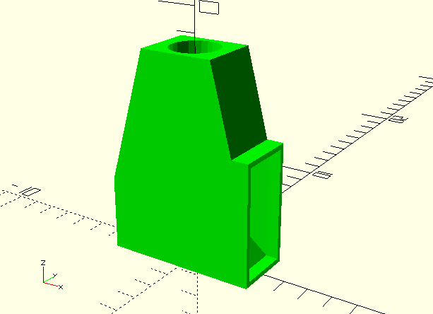

Yes each housing cell is now a union of three linear extrudes, one
horizontal and two vertical, avoiding any renders. Time is now down to 4.1
seconds.
