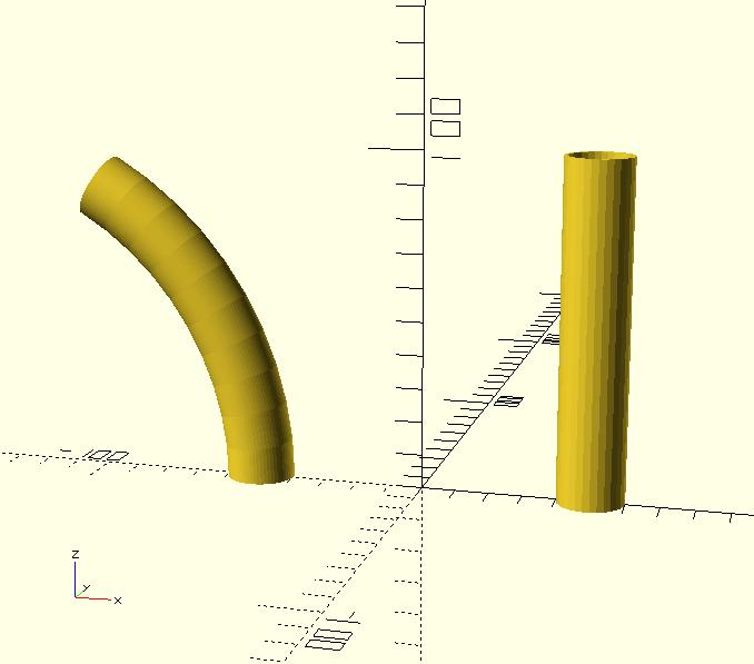

right now next problem I am facing is to construct machine that use lot of
pipes  that must be positioned precosely and have bends thar are half
circular, and my method of creating pipes from difference of two cilinders
is good only for straight pipes. if anyone know function to create such
pipes, please tell me where to find it.
http://forum.openscad.org/file/n21446/PerpetumMobiusDupliIstostraniPomaknutProziran.jpg
So basically you have 2 closed pipe loops consisting of straight and
circular segments, and the 2 loops are independent of each other (not
connected to each other) and rotated 45 degrees relative. Is that right?
I tried to open the OpenSCAD file of your original post, but it didn't
look anything like the photo above. To get any further I think it would
be a good idea to clarify whether the above photo is indeed what you
want to create.
Parts of your hand made thing below seems to be in loose agreement with
the above photo, but the details are unclear.
http://forum.openscad.org/file/n21447/Photo-0001.jpg
I have no idea if this thing would do anything meaningful, it just seems
like a few bent pipes with no entrance/exit, but it should be possible
to model if the top photo is representative.
So is it the "PerpetumMobiusDupliIstostraniPomaknutProziran.jpg" layout
as shown you are attempting to recreate, with the dimensions from the
.scad file in your original post?

On 14. mai 2017 16:26, Marijan Pollak wrote:
It is Gravity motor, but I did not
asked for help with that, only in creating round pipes or cylinders which I
can made difference from cylindrical plate to get pipes inside.
I would recommend something like below for creating pipes, instead of
subtracting cylinders. This avoids the problem that the inner cylinder
has to extend at both ends, to avoid numerical problems:
$fn=30;
module StraightPipe(ro=10, th=1, l=100)
linear_extrude(l)
difference() { circle(ro); circle(ro-th); }
module CurvedPipe(ro=10, th=1, radius=100, angle=60)
rotate([90,0,0])
translate([-radius,0,0])
rotate_extrude(angle=angle,$fn=60)
translate([radius,0,0])
translate([-50,0,0]) CurvedPipe();
translate([+50,0,0]) StraightPipe();
The angle parameter in rotate_extrude requires a recent version of OpenSCAD.
Btw. the "PerpetumMobius" photo or the model you made with hoses imply
non-planar bent pipes. That isn't possible with rotate_extrude in OpenSCAD.
