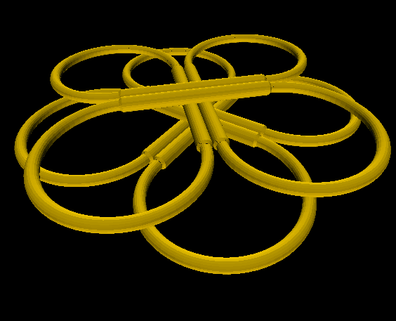

I would recommend something like below for creating pipes, instead of
subtracting cylinders. This avoids the problem that the inner cylinder has
to extend at both ends, to avoid numerical problems:
$fn=30;
module StraightPipe(ro=10, th=1, l=100)
linear_extrude(l)
difference() { circle(ro); circle(ro-th); }
module CurvedPipe(ro=10, th=1, radius=100, angle=60)
rotate([90,0,0])
translate([-radius,0,0])
rotate_extrude(angle=angle,$fn=60)
translate([radius,0,0])
translate([-50,0,0]) CurvedPipe();
translate([+50,0,0]) StraightPipe();
The angle parameter in rotate_extrude requires a recent version of
OpenSCAD.
Btw. the "PerpetumMobius" photo or the model you made with hoses imply
non-planar bent pipes. That isn't possible with rotate_extrude in OpenSCAD.
In the general setting of the photo, rotate_extrude and linear_extrude has little value. The natural solution would be to define the tube path by interpolating splines and build the tube by sweeping a ring along that path. That is a completely distinct approach though. 2017-05-14 12:38 GMT-03:00 Carsten Arnholm <arnholm@arnholm.org>: > On 14. mai 2017 16:26, Marijan Pollak wrote: > >> It is Gravity motor, but I did not >> asked for help with that, only in creating round pipes or cylinders which >> I >> can made difference from cylindrical plate to get pipes inside. >> > > I would recommend something like below for creating pipes, instead of > subtracting cylinders. This avoids the problem that the inner cylinder has > to extend at both ends, to avoid numerical problems: > > > $fn=30; > module StraightPipe(ro=10, th=1, l=100) > { > linear_extrude(l) > difference() { circle(ro); circle(ro-th); } > } > > module CurvedPipe(ro=10, th=1, radius=100, angle=60) > { > rotate([90,0,0]) > translate([-radius,0,0]) > rotate_extrude(angle=angle,$fn=60) > translate([radius,0,0]) > difference() { circle(ro); circle(ro-th); } > } > > > translate([-50,0,0]) CurvedPipe(); > translate([+50,0,0]) StraightPipe(); > > ---- > > The angle parameter in rotate_extrude requires a recent version of > OpenSCAD. > > Btw. the "PerpetumMobius" photo or the model you made with hoses imply > non-planar bent pipes. That isn't possible with rotate_extrude in OpenSCAD. > > > Carsten Arnholm > > _______________________________________________ > OpenSCAD mailing list > Discuss@lists.openscad.org > http://lists.openscad.org/mailman/listinfo/discuss_lists.openscad.org > >
CA
Sun, May 14, 2017 5:55 PM
It is true for OpenSCAD, you cannot create that model with either of the
above methods using built-in functions directly.
For the fun of it I tried to replicate the photo using only my variants
of linear_extrude, rotate_extrude plus 'transform_extrude' (i.e. not in
OpenSCAD). See image of model generated with xcsg. In principle it is
doable with similar functions.
Being able to sweep a general cross section along a spline path is
something anyone would like to have, I totally agree with that.

include <polysections.scad>;
include <path_extrude.scad>;
include <bezier_curve.scad>;
include <circle_path.scad>;
function knot(N=360, a=2, b=1.5, c=2, r = 100) =
[for (t=[0:N]) r * [(a+cos(at))cos(bt), (a+cos(at))sin(bt),
.2sin(ct)]];
traj = knot(720, 2, 1.5, 2);
shape_pts = circle_path(radius = 25);
path_extrude(shape_pts, traj);
