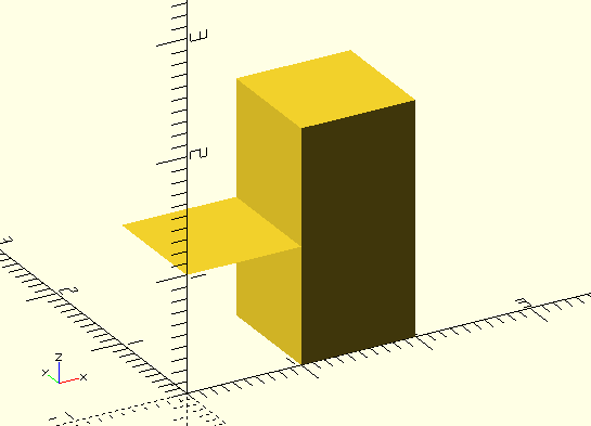

Hi everyone,
When I run this code (with F6), I get an stl with an empty flat square,
which is not a valid volume...
Can anyone confirm this on some other version of Openscad? (I am 42
commits behind current master version)
translate([0,0,1]) cube();
cube();
You can try also this:
translate([-25,-25,10]) cube(50);
cylinder(r=20,h=10);
wich generates a non manifold volume.
Seems to me like a regularization (closure of the interior) is missing
for the intersection operation.
Sincerely,
Sebastien

Both mathematically define an infinitely thin shape, so it is not

CGAL, that is called by F6, doesn't seem to do regularization. Throw a warn
if the solid seems to be non-manifold. STL may be generated nevertheless.

Hi!,
surprising it is non manifold. What do you expect the result to be?
The result should be empty.
The whole point of openscad is generating valid 3D solids. Any shape
with 0 volume is essentially 2d, not 3d, and should be removed.  Here is
one such invalid shape (use F6):
translate([1,0,0]) cube([1,1,2]);
cube();
By the way, if you import this stl into openscad, it will fail to render
(with F6), as openscad considers it invalid (as it should).
Sebastien
