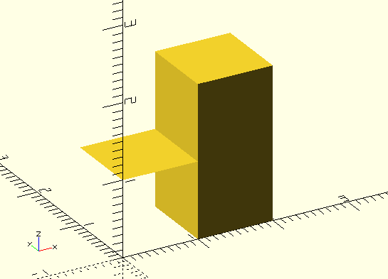

The whole point of openscad is generating valid 3D solids. Any shape with
0 volume is essentially 2d, not 3d, and should be removed.  Here is one
such invalid shape (use F6):
translate([1,0,0]) cube([1,1,2]);
translate([0,0,1]) cube();
cube();
By the way, if you import this stl into openscad, it will fail to render
(with F6), as openscad considers it invalid (as it should).
Sebastien

You are right, but a non manifold geometry can be "regularized"  to a
3-manifold (see http://doc.cgal.org/latest/Nef_3/index.html#title3 ). It
is done by computing the boundary of the interior... (closure(),
interior(), regularization() ).
If openscad was using regularization after boolean operations, it would
output 3-manifolds that are printable, and would be able to import its
own stl without probem.
Anyway I tried to add regularization() and it works. So is there any
reason I missed why openscad doesn't regularize?
Sebastien

Wed, Aug 17, 2016 10:53 AM
 to a 3-manifold.
I'm not sure that helps a lot. Making a wrong model technically
correct does not fix the core issue, or maybe I just misunderstand
what it's doing in detail.
What's the result for the example with that thin plane?
it would output 3-manifolds that are printable, and would be
able to import its own stl without probem.
The main issue when importing STLs is zero-faces that are
currently not handled well as the face orientation is not defined.
Would that also be solved?
Von: DIRO <roys@iro.umontreal.ca> > You are right, but a non manifold geometry can be "regularized" > to a 3-manifold. > I'm not sure that helps a lot. Making a wrong model technically correct does not fix the core issue, or maybe I just misunderstand what it's doing in detail. What's the result for the example with that thin plane? > If openscad was using regularization after boolean operations, > it would output 3-manifolds that are printable, and would be > able to import its own stl without probem. > The main issue when importing STLs is zero-faces that are currently not handled well as the face orientation is not defined. Would that also be solved? ciao, Torsten.
Wed, Aug 17, 2016 11:20 AM
I think regularization would remove the zero volume entities, so the
resulting solids could be saved to STL and re-imported succesfully. They
don't match what the source code describes though.

Hmm, might be worth a try then, maybe as optional experimental
feature. Just running every model forcibly though a new CGAL
functions sounds a bit scary.
