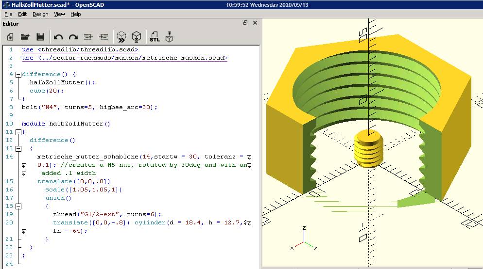

Works for me:
I suggest you try thread_profile.scad actually in OpenSCAD/libraries.
If you still have a problem, please use the scad code above, and show the console results.

ok tried it, worked, was baffled ... but then instead of metric thread, i
used :
nut("G1/2-ext", turns=10, Douter=16);
full code:
use <threadlib/threadlib.scad>
use <../scalar-rackmods/masken/metrische_masken.scad>
halbZollMutter();
cube(20);
//bolt("M4", turns = 5, higbee_arc = 30);
//bolt("G1/2-ext","turns = 5, higbee_arc = 30);
//nut("M12x0.5", turns=10, Douter=16);
module halbZollMutter()
metrische_mutter_schablone(14,startw = 30, toleranz = 0.1); //creates a
M5 nut-mask, rotated by 30deg and with an added .1 width
translate([0,0,.0])
scale([1.05,1.05,1])
union()
thread("G1/2-ext", turns=6);
translate([0,0,-.8]) cylinder(d = 18.4, h = 12.7,$fn = 64);

Garbage In - Garbage Out.
If you look at threadlib.scad, bolt() & nut() add the "-ext" or "-int" to the designator.
So nut("G1/2-ext", turns=10, Douter=16); goes searching for "G1/2-ext-int" which doesn't exist.
The rest of the program tries to run with an undef variable and naturally fails badly...
nut("G1/2", turns=10, Douter=16); // works
Many, particularly older, libraries do not do much parameter checking.

full code:
halbZollMutter();
cube(20);
a M5 nut-mask, rotated by 30deg and with an added .1 width
translate([0,0,.0])
union()
and the i get in the console:

its OpenSCAD https://www.openscad.org/* version 2020.04.26.nightly (git
648206e)*
i remove the symbolic link on thread_profile.scad in the openscad library
dir, didn't change anything indeed....
so ,well i created the nut myself, so the urgency is low, but still
there's strange stuff going on....
used :
full code:
halbZollMutter();
cube(20);
translate([0,0,.0])
union()
WARNING: Matrix must contain only numbers. Problem at row 1, col 3

Am Mi., 13. Mai 2020 um 03:04 Uhr schrieb OzAtMichael <
oz.at.michael@gmail.com>:
Works for me:
console results.
Works for me:
