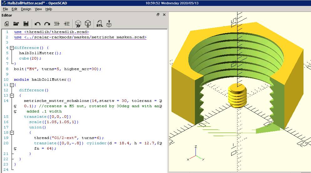

Am Do., 14. Mai 2020 um 06:49 Uhr schrieb OzAtMichael <
oz.at.michael@gmail.com>:
Garbage In - Garbage Out.
If you look at threadlib.scad, bolt() & nut() add the "-ext" or "-int"
to the designator.
So nut("G1/2-ext", turns=10, Douter=16); goes searching for
"G1/2-ext-int" which doesn't exist.
The rest of the program tries to run with an undef variable and
naturally fails badly...
nut("G1/2", turns=10, Douter=16); // works

ok tried it, worked, was baffled ... but then instead of metric thread,
i used :
full code:
use <threadlib/threadlib.scad>
use <../scalar-rackmods/masken/metrische_masken.scad>
halbZollMutter();
cube(20);
//bolt("M4", turns = 5, higbee_arc = 30);
//bolt("G1/2-ext","turns = 5, higbee_arc = 30);
//nut("M12x0.5", turns=10, Douter=16);
module halbZollMutter()
metrische_mutter_schablone(14,startw = 30, toleranz = 0.1);
//creates a M5 nut-mask, rotated by 30deg and with an added .1 width
translate([0,0,.0])
scale([1.05,1.05,1])
union()
thread("G1/2-ext", turns=6);
translate([0,0,-.8]) cylinder(d = 18.4, h = 12.7,$fn = 64);
and the i get in the console:
If you look at threadlib.scad, bolt() & nut() add the "-ext" or "-int" to the designator.
So nut("G1/2-ext", turns=10, Douter=16); goes searching for "G1/2-ext-int" which doesn't exist.
The rest of the program tries to run with an undef variable and naturally fails badly...
Many, particularly older, libraries do not do much parameter checking.

ok tried it, worked, was baffled ... but then instead of metric thread, i used :
full code:
halbZollMutter();
cube(20);

Works for me:
I suggest you try thread_profile.scad actually in OpenSCAD/libraries.
If you still have a problem, please use the scad code above, and show the console results.

bboett wrote
Hello!
i need some 1/2" pipe connector for a pump (when can they switch to metric
and wanted to give https://github.com/adrianschlatter/threadlib a try....
i cloned the 3 libs too
had to fix the problem with the spaces in the IoP lib and add the path to
the threadlib...
i got it to display just a thread, but as soon as i try a bolt or nut i
get
Loaded design '/home/bboett/Downloads/3dmodel/garten/pumpenadapter.scad'.
WARNING: Matrix must contain only numbers. Problem at row 1, col 3
DEPRECATED: Using ranges of the form [begin:end] with begin value greater
than the end value is deprecated, in file skin.scad, line 67
than the end value is deprecated, in file skin.scad, line 74
the designator.
fails badly...
used :
full code:
halbZollMutter();
cube(20);
metrische_mutter_schablone(14,startw = 30, toleranz = 0.1); //creates
translate([0,0,.0])
union()

Am Mi., 13. Mai 2020 um 03:04 Uhr schrieb OzAtMichael <
Works for me:
console results.
*Bruno Boettcher
Sent: Tue, 12 May 2020 02:34

I just downloaded it & tried
bolt("M4", turns=5, higbee_arc=30);
and it worked.
the threadlib
What is IoP lib?
No need to add the path if they are n your OpenSCAD library,
https://en.wikibooks.org/wiki/OpenSCAD_User_Manual/Libraries
Please share pumpenadapter.scad
