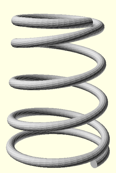

I was under the impression that if a module was instantiated multiple times
with the same parameters the results were cached and reused.
If I make a module that renders() the difference between a cube and a
sphere with lots of vertices  and use it 100 times in a preview it take the
same time to preview 100 as it does one. I.e. it only does the slow
difference once and then draws the result 100 times.
However if I generate a spring using a helical sweep of a circle than it
takes about 1 second to preview one and 100 seconds to preview 100.
So it seems I misunderstood the caching. It only seems to cache CGAL
operations, not the actual instantiation of the module. It still needs to
calculate the sweep each time despite all the springs being identical. Is
this the case? I.e. it doesn't shortcut modules when the parameters don't
change?
I am surprised it takes a second to generate all the vertices for the
polyhedron. It is about 9000 facets generated with list comprehensions and
transformations in an interpreted language, but even so, PCs are very fast.
Looks like I need to save the points and face lists myself and reuse them.

So I rewrote my spring module as a function that returns a mesh (points and
faces) so I can save it as a variable and then re-use it to draw many
springs by simply calling polyhedron.
100 springs was taking 61 seconds when it was doing a sweep for each one.
With only one sweep to generate the mesh and 100 calls of polygon it now
takes 23 seconds. Why is polyhedron so slow? I expected it to by
instantaneous in F5. All it has to do is process the lists into a polyset.

It spends most of the 22 seconds stuck at Compiling design (CSG Tree
generation)...
After that it does all the rest in about 1 second, including a very fast
progress bar.
Geometries in cache: 395
Geometry cache size in bytes: 20331104
CGAL Polyhedrons in cache: 0
CGAL cache size in bytes: 0
Normalized CSG tree has 100 elements
Compile and preview finished.
Total rendering time: 0 hours, 0 minutes, 22 seconds
It would be a problem if I was designing a mattress with PLA springs but
fortunately only a battery box with four, but it would be nice if
polyhedrons were cached like other geometry seems to be. I clearly don't
fully understand OpenSCADs caching system.

Here is a boiled down version:
https://gist.github.com/nophead/fd4ca58b5f6b19dc25bb98f7edbae90f
I captured the points and face lists generated by sweep and hard coded them
to remove all of my library. Each spring is 4576 points, 9122 faces but
they are all the same polyhedron repeated 100 times. Given that it doesn't
cache polyhedra it has to process the same lists to a Polyset 100 times.
Taking about 1/4 second to process 9000 faces seems very slow to me on a 64
bit 2.5GHz core I7 with 8 GB memory.

Here is a boiled down version: https://gist.github.com/nophead/fd4ca58b5f6b19dc25bb98f7edbae90f I captured the points and face lists generated by sweep and hard coded them to remove all of my library. Each spring is 4576 points, 9122 faces but they are all the same polyhedron repeated 100 times. Given that it doesn't cache polyhedra it has to process the same lists to a Polyset 100 times. Taking about 1/4 second to process 9000 faces seems very slow to me on a 64 bit 2.5GHz core I7 with 8 GB memory. On Mon, 28 Jan 2019 at 02:23, Hans L <thehans@gmail.com> wrote: > Hi nophead, > > Could you post a sample script for others to reproduce the slowness you > experience? > > Thanks, > Hans > > On Sun, Jan 27, 2019 at 4:59 PM nop head <nop.head@gmail.com> wrote: > >> It spends most of the 22 seconds stuck at Compiling design (CSG Tree >> generation)... >> >> After that it does all the rest in about 1 second, including a very fast >> progress bar. >> >> Compiling design (CSG Products generation)... >> >> Geometries in cache: 395 >> >> Geometry cache size in bytes: 20331104 >> >> CGAL Polyhedrons in cache: 0 >> >> CGAL cache size in bytes: 0 >> >> Compiling design (CSG Products normalization)... >> >> Normalized CSG tree has 100 elements >> >> Compile and preview finished. >> >> Total rendering time: 0 hours, 0 minutes, 22 seconds >> >> >> It would be a problem if I was designing a mattress with PLA springs but >> fortunately only a battery box with four, but it would be nice if >> polyhedrons were cached like other geometry seems to be. I clearly don't >> fully understand OpenSCADs caching system. >> >> On Sun, 27 Jan 2019 at 22:33, Parkinbot <rudolf@digitaldocument.de> >> wrote: >> >>> nophead wrote >>> > Is it perhaps that the lists are stored as strings when the polyhedron >>> is >>> > instantiated and then parsed to vectors every time the geometry is >>> > created. >>> >>> I doubt that. But you are right, the code really looks like nothing very >>> time consuming is happening. >>> Is the triangulation of the faces done by Open GL? What happens after the >>> geometry has been created? >>> >>> >>> >>> -- >>> Sent from: http://forum.openscad.org/ >>> >>> _______________________________________________ >>> OpenSCAD mailing list >>> Discuss@lists.openscad.org >>> http://lists.openscad.org/mailman/listinfo/discuss_lists.openscad.org >>> >> _______________________________________________ >> OpenSCAD mailing list >> Discuss@lists.openscad.org >> http://lists.openscad.org/mailman/listinfo/discuss_lists.openscad.org >> > _______________________________________________ > OpenSCAD mailing list > Discuss@lists.openscad.org > http://lists.openscad.org/mailman/listinfo/discuss_lists.openscad.org >
