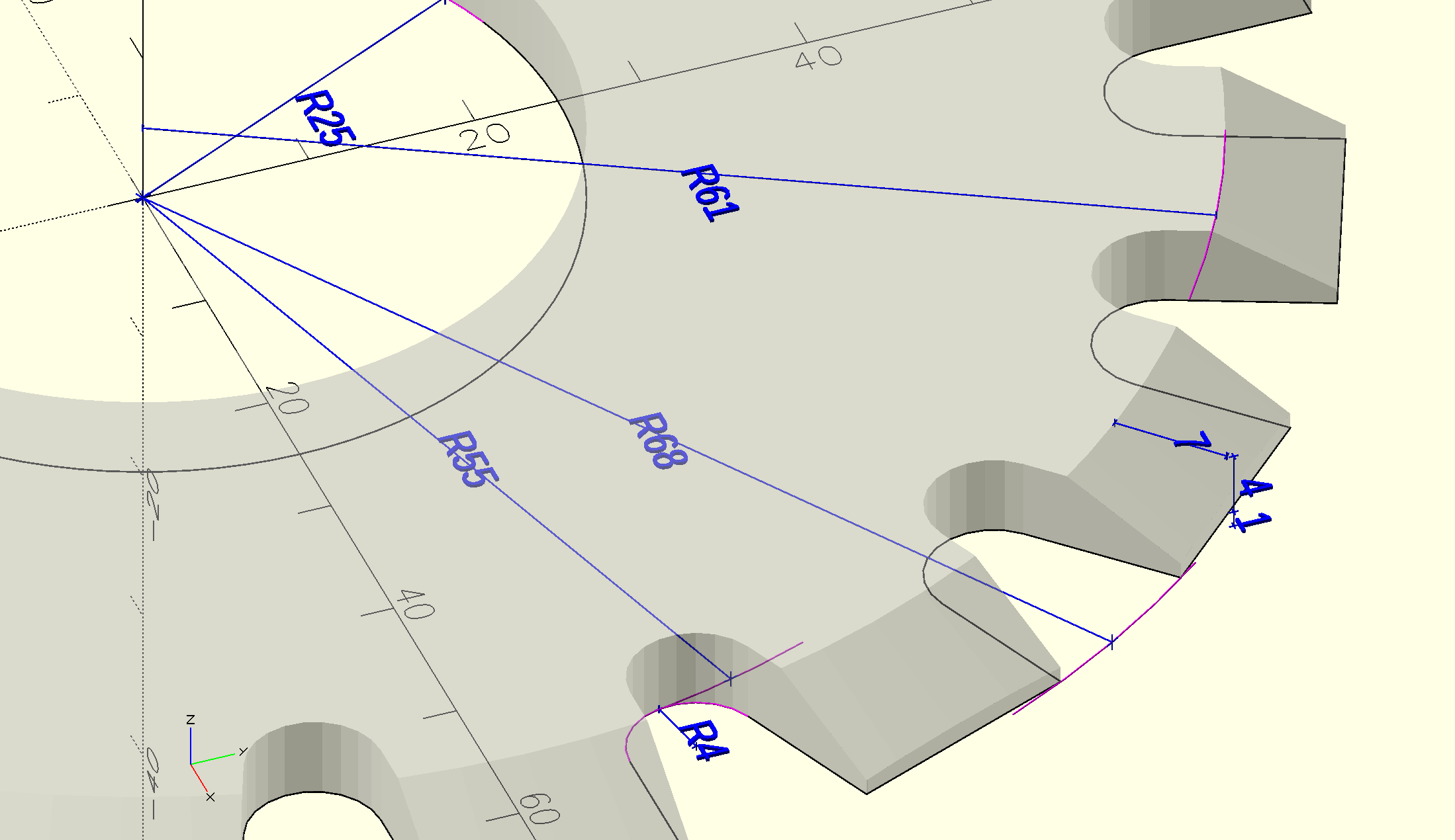

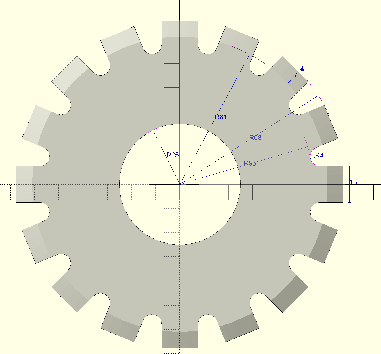

Dimensioning is another area to work on in openSCAD
One of the examples which I created on how to communicate a design intent
using Python.
File attached for reference
Would you be able to create the same model with this?
[image: Screenshot 2026-01-09 at 9.34.37 PM.png]
[image: Screenshot 2026-01-09 at 9.46.54 PM.png]

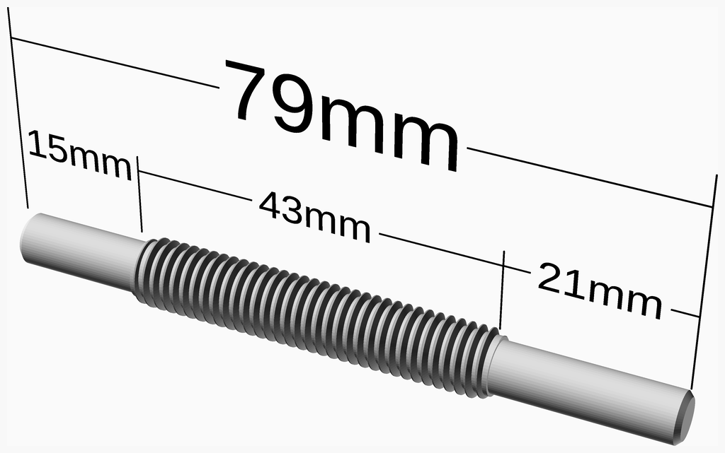

This is how I dimension:
[image: rod_assembly.png]

Fri, Jan 9, 2026 10:17 PM
Right, and that looks gorgeous, but you had to do that more or less "by
hand", right? That is, which direction the offset is for the line,
offset for the vertical lines from the measurement endpoints, et cetera.
And that only works from this angle; if you rotated that rod 90° the
labels wouldn't work.
My dimension lines look like so:
but I positioned those "by hand".
On 1/9/2026 12:45 PM, nop head via Discuss wrote: > This is how I dimension: > > rod_assembly.png Right, and that looks gorgeous, but you had to do that more or less "by hand", right? That is, which direction the offset is for the line, offset for the vertical lines from the measurement endpoints, et cetera. And that only works from this angle; if you rotated that rod 90° the labels wouldn't work. My dimension lines look like so: but I positioned those "by hand".
Fri, Jan 9, 2026 10:24 PM
module dimv(p1, p2, z, max = inf, offset = 1) { //! Draw a vertical
dimension showing the x,y distance between two points
for(p = [p1, p2])
translate(p + [0, 0, offset])
cylinder(r = 0.1, h = z - p.z - offset);
mid = (p1 + p2) / 2;
d = norm(vec2(p1 - p2));
text = str(d, "mm");
tw = d - 2;
if(max < tw)
    for(side = [-1, 1])
        translate([mid.x, mid.y, 0] + [side * d / 2, 0, z - max /
len(text) / 1.75])
rotate([0, -side * 90, 0])
cylinder(r = 0.1, h = (d - max) / 2 - 1);
translate([mid.x, mid.y, z])
    rotate([90, 0, 0])
        resize([min(tw, max), 0], auto = true)
            linear_extrude(0.1)
                text(text, halign = "center", valign = "top");
//! 1. Turn down the ends of the studding to 5.96mm
module rod_assembly()
assembly("rod", big = true) {
if(exploded())
color("black") {
h = 15;
p0 = axle_pos + [0, 0, axle_d / 2];
p1 = studding_pos + [0, 0, studding_d / 2];
p2 = studding_pos + [-studding_length, 0, studding_d / 2];
p3 = axle_pos + [-axle_length, 0, axle_d / 2];
            max = p2.x - p3.x - 2;
            dimv(p0, p1, axle_pos.z + h, max);
            dimv(p1, p2, axle_pos.z + h, max);
            dimv(p2, p3, axle_pos.z + h, max);
            dimv(p0, p3, axle_pos.z + 2 * h, 2 * max);
    translate(axle_pos)
        rotate([0, -90, 0])
            not_on_bom()
                rod(axle_d, axle_length, center = false);
    translate(studding_pos)
        rotate([0, -90, 0])
            let($show_threads = true)
                not_on_bom()
                    studding(studding_d, studding_length, false);
    hidden()
        studding(studding_d, axle_length, false);

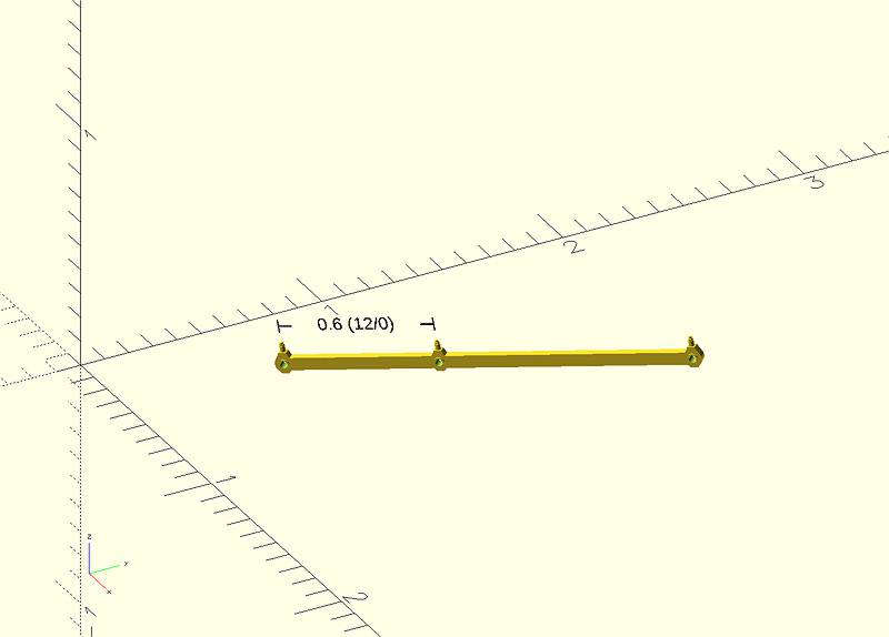

Glenn Butcher
Fri, Jan 9, 2026 11:22 PM
I lay out my parts on an axis (usually X), and I use variables for major
measurements.  So, when I use my dimension() module it lays out on the X
axis, and I pass it the particular measurements into its start and end
parameters.  If I put the part module call and the dimension module call
in a module,e.g, dimensioned_siderod(), I can translate/rotate that to
my heart's content:
rotate([0,-10,45]) dimensioned_siderod();
does this:
The numbers in parentheses are turns and ticks of the mill wheel to take
the tool from the left-center to the center-center, useful when

If you have to do this manually it is very tedious.
You need to definitely mention which arc needs to be dimensioned or which
line etc.
With primitives it is very hard to do that and also it misses the point
when you do that manually because it may not show the correct values.
This can be done more usefully if:
  • you draw models with the points list
  • there is a points tracing / numbering method available
  • all calculations should be autonomous like it should auto calculate arc
    radius , angle between 2 lines, distance between 2 given points and display
    the results.
    and so on...
The python code for the example I shared is below for reference:
from openscad4 import *
c1,c2,c3=[circle(i,s=100) for i in [50/2,110/2,136/2]]
l1=[[-150,7.5],[150,7.5]]
l2=path_offset(l1,15)
p0,p1,p2,p3=s_int1([l1,l2]+seg(c3))
p4,p5,p6,p7=rot2d(22.5,[p0,p1,p2,p3])
p8=s_int1([[p0,p1],[p7,p6]])[0]
l3=corner_n_radius_list([p0,p8,p7],[0,4,0])
l4=a_([ rot2d(i,l3) for i in arange(0,360,22.5)]).reshape(-1,2).tolist()
txt1=dim_radial(l3[1:-1],.5,"blue",2)
path=cr2dt([[0,0],[0,1],[-7,4]])
sol=prism(c3,path)
sol1=translate([0,0,-.5],linear_extrude(l4,7))
sol2=translate([0,0,-.5],linear_extrude(c1,7))
txt2=dim_linear([p0,p3],-5,1,text_size=2)
txt3=dim_radial(c2[3:7],1,text_size=2)
txt4=dim_radial(c3[7:12],1,text_size=2)
txt5=dim_radial(c1[30:35],1,text_size=2)
txt6=dim_linear([sol[0][12],sol[1][12]],-1,.5,text_size=2)
txt7=dim_linear(point_vector(sol[1][12],[0,0,4]),-1,.5,text_size=2)
txt8=dim_linear(point_vector(sol[2][12],a_(line_as_unit_vector([[0,0,sol[2][
12][2]],sol[2][12]]))*7),1,.5,text_size=2)
txt9=dim_radial(sol[2][15:20],0.5,text_size=2)
fo: file open
fo(f'''
color("black") for(p={[c1,l4]}) p_line3dc(p,0.1);
{txt1}{txt2}{txt3}{txt4}{txt5}{txt6}{txt7}{txt8}{txt9}
%difference(){{
intersection(){{
{swp(sol)}
{swp(sol1)}
{swp(sol2)}
