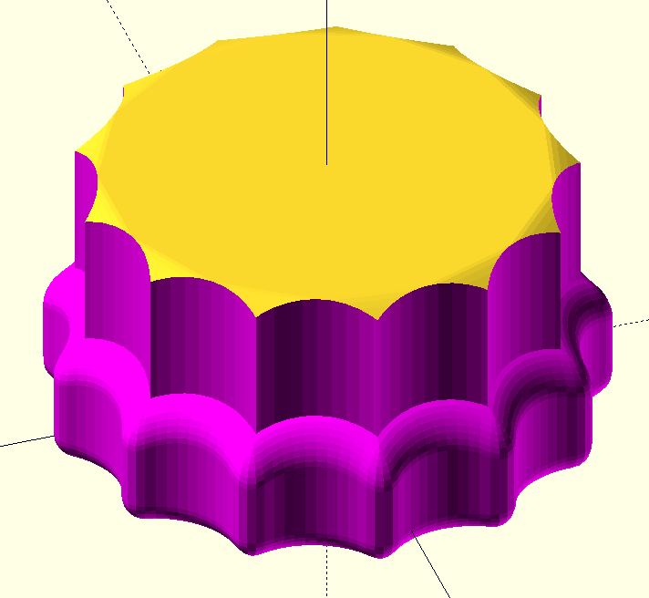

Actually I got fooled when I viewed the shape with "thrown together".  He
explicitly calls render() in his code, which bypasses the thrown-together
process.  I actually figured this out because the BOSL2 polyhedron
validator produced a long list of errors like this:
ECHO: "ERROR REVERSAL (violet): Faces Reverse Across Edge at [[0.0319137,
-16.3794, 18.4927], [-0.932485, -16.0686, 18.6187]] indices: [3217, 3216]"
ECHO: "ERROR REVERSAL (violet): Faces Reverse Across Edge at [[0.949081,
-16.81, 18.2839], [0.0319137, -16.3794, 18.4927]] indices: [3218, 3217]"
ECHO: "ERROR REVERSAL (violet): Faces Reverse Across Edge at [[1.80419,
-17.3535, 17.9945], [0.949081, -16.81, 18.2839]] indices: [3219, 3218]"
ECHO: "ERROR REVERSAL (violet): Faces Reverse Across Edge at [[2.1411,
-17.6335, 17.8396], [1.80419, -17.3535, 17.9945]] indices: [3220, 3219]"
ECHO: "ERROR REVERSAL (violet): Faces Reverse Across Edge at [[2.4012,
-17.281, 17.9945], [2.1411, -17.6335, 17.8396]] indices: [3221, 3220]"
ECHO: "ERROR REVERSAL (violet): Faces Reverse Across Edge at [[3.10139,
-16.5486, 18.2839], [2.4012, -17.281, 17.9945]] indices: [3222, 3221]"
I am not sure why that render() call is there.  It doesn't seem to do
anything other than preventing the user from using preview and hiding
errors. With render() removed, and thrown together enabled, the face
reversal is obvious as seen below.  So the conclusion is: the polyhedron
has reversed faces, hence it is invalid.

He did post (a link to) the full code. Actually I got fooled when I viewed the shape with "thrown together". He explicitly calls render() in his code, which bypasses the thrown-together process. I actually figured this out because the BOSL2 polyhedron validator produced a long list of errors like this: ECHO: "ERROR REVERSAL (violet): Faces Reverse Across Edge at [[0.0319137, -16.3794, 18.4927], [-0.932485, -16.0686, 18.6187]] indices: [3217, 3216]" ECHO: "ERROR REVERSAL (violet): Faces Reverse Across Edge at [[0.949081, -16.81, 18.2839], [0.0319137, -16.3794, 18.4927]] indices: [3218, 3217]" ECHO: "ERROR REVERSAL (violet): Faces Reverse Across Edge at [[1.80419, -17.3535, 17.9945], [0.949081, -16.81, 18.2839]] indices: [3219, 3218]" ECHO: "ERROR REVERSAL (violet): Faces Reverse Across Edge at [[2.1411, -17.6335, 17.8396], [1.80419, -17.3535, 17.9945]] indices: [3220, 3219]" ECHO: "ERROR REVERSAL (violet): Faces Reverse Across Edge at [[2.4012, -17.281, 17.9945], [2.1411, -17.6335, 17.8396]] indices: [3221, 3220]" ECHO: "ERROR REVERSAL (violet): Faces Reverse Across Edge at [[3.10139, -16.5486, 18.2839], [2.4012, -17.281, 17.9945]] indices: [3222, 3221]" I am not sure why that render() call is there. It doesn't seem to do anything other than preventing the user from using preview and hiding errors. With render() removed, and thrown together enabled, the face reversal is obvious as seen below. So the conclusion is: the polyhedron has reversed faces, hence it is invalid. [image: image.png] On Sun, Jan 12, 2025 at 11:10 AM Raymond West via Discuss < discuss@lists.openscad.org> wrote: > It would help if you posted an image of what you're trying to create, > and possibly some code. I can't help if you are trying to use bos2l or > you refer to github/elsewhere. > > I find in f5 render, a lot of my stuff breaks up. However, in manifold > rendering f6, generally works. You can check, as Jordan hinted, by > including a cube when you f6, do it as the object is evolved. If you get > just a cube, then you know where you've screwed up. > > On 12/01/2025 08:08, Thomas Richter via Discuss wrote: > > I create concave polyhedra of several thousand faces. For details about > the purpose see > https://lists.openscad.org/empathy/thread/LY26O7U4CLHPW3BGQIDLSAE6FRVVHEUG > > > > My question is not about building the shape, that's solved, but about a > strange error I experience with certain input values. An example causing > the error can be found on Github: > > > > > https://github.com/trses/screw-nut-knobs/blob/boolean-glitch/analytical-solution.scad > > > > When I render the shape I get this error: > > > > WARNING: PolySet -> Manifold conversion failed: NotManifold > > Trying to repair and reconstruct mesh.. > > ERROR: [manifold] Input mesh is not closed! > > ERROR: [manifold] Surface_mesh -> Manifold conversion failed: NotManifold > > > > This happens in very rare situations (e. g.: ARMS = 13, 1.97 <= > _armPitch <= 2.17, _q = 182, _q = 208 and ARMS = 17, 1.93 <= _armPitch <= > 2.18, _q = 204). Since the values are similar I believe there is a > geometrical reason but I have no idea how I could debug this and figure out > the actual cause. > > > > If you comment out line 163 (subtract hollow sphere) it doesn't happen > (though the shape will look strange then). The polyhedron itself is built > correctly, I have checked it several times by hand. > > > > My platform is an Apple Silicon M3 CPU. > > > > I would like to know if others experience the same behavior (on other > platforms) with the example provided and if so, what is the cause or at > least what could I do to debug it. My impression is that it happens when > the shape to subtract from is complex and very tiny faces are generated. > Unfortunately, the error message is not very helpful. > > > > Is this an already known glitch? > > > > Second question related to this: In case this is a shortcoming of the > rendering engine: Is there any chance to catch this error by means of the > source code and handle it by, e. g., adjusting the _armPitch value? > > > > If this question is assumed to be spam, please let me know how I should > have brought this problem up. I have already asked the question in one of > the last messages of the other thread but it seems that it got lost there. > > _______________________________________________ > > OpenSCAD mailing list > > To unsubscribe send an email to discuss-leave@lists.openscad.org > _______________________________________________ > OpenSCAD mailing list > To unsubscribe send an email to discuss-leave@lists.openscad.org >

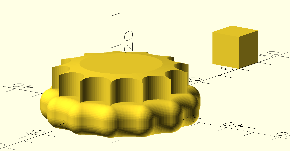

Hi, I never followed the link, I'm not sure if the image is what was
wanted, but not difficult to create, or something like. I guess the
roundover could be smaller, but it's all parametric anyway.
code attached below. No rendering problems. similar to a post a few days
ago.

Thank you for this insight. I misunderstood the manual and oriented the side faces counterclockwise instead of clockwise. After fixing this the purple is all gone, the problem persists with boolean operations, goes away without boolean operations.
The render() was there because the misoriented side faces made the body appearing transparent. Unfortunately this didn't lead to any insight on my side :-(
I checked with a script that all points - copied from output with echo - are unique.
I have uploaded the version with the fixed faces:
I flushed the caches before every experiment and made the following observations when trying to render (not preview), see lines 167 - 179:
  • difference with the polyhedron and a hollow sphere: problem persists
  • union with the polyhedron and a cube someplace else: problem persists
  • commenting out the difference / union rendering just the polyhedron: problem goes away.
What does this mean?

Sun, Jan 12, 2025 7:16 PM
Create another copy of your 'working' polyhedra, so you have two on the
screen. You will probably get none! If you are 3d printing, the slicer
may say it is not watertight. If you understand MeshLab, that may help -
it's useful for reducing the number of facets. However, there is a
problem still with the polyhedra you have created, in that case, (In
language I understand ), it does not know which points should connect to
others, in union or difference. If it is that sort of scalloped knob you
are concerned with, look at it to build it from shapes you know work, at
the simplest level (even then you can get problems) so, build stuff from
squares/circles, mostly  extrude works, as does rotate, translate and
scale, the basic stuff. No need to use bosl2, whatever. Minkowski is
slow, but render at $fn=50, say, to see if it is OK, then go for 150, or
100.
However, it is possible to fail in trying to difference two cylinders at
slight angles, But don't ask me to replicate it sod's law is paramount..
[3217, 3216]"
<image.png>
<image.png>
On Sun, Jan 12, 2025 at 11:10 AM Raymond West via Discuss discuss@lists.openscad.org wrote:
