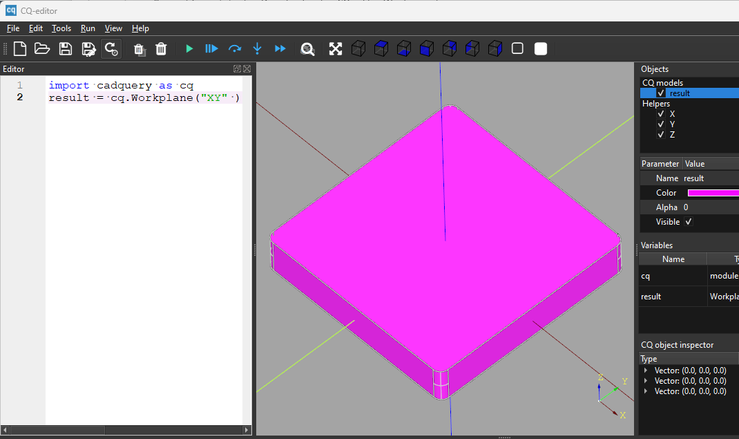

_Anyone else tried this out to compare it with OpenSCAD:_ I gave it a try. Installation was not very obvioous, but in the end succesfull. Graphical userinterface, I thought of it as outdated. The OpenScad language syntax is much easier. Learning curve of OpenScad is better. I also like commandline tools but not for 3D modelling. Groet Matthieu ------------------------- Leonard Martin Struttmann via Discuss schreef op 2024-01-15 03:44: > It sounds interesting, so I decided to install CADquery & CQ-editor and > play around with it. > > Installation is taking a VERY, VERY long time. While I am waiting for > the install to finish, I decided to peruse some of the examples at: > > https://cadquery.readthedocs.io/en/latest/examples.html > > I must say that the syntax looks quite daunting to me. Reminds me of > CSS (which I do not like). > > And the examples given do not seem to be well written. The one that > really screams at me is "Panel With Various Connector Holes". So many > hard-coded numbers! No subroutines? And apparently there is no > concept of OpenSCAD's hull() function. > > I'll start playing with this tomorrow (if the install ever completes!). > > Anyone else tried this out to compare it with OpenSCAD? > > Len > > On Sun, Jan 14, 2024 at 7:54 PM Jeff Cooper via Discuss > <discuss@lists.openscad.org> wrote: > Sorry, I'm somewhat late to this discussion, but I too prefer command > line solutions for the same reasons especially including the ability to > use makefiles. > > Coop, > aa1ww > > On Thu, Jan 11, 2024 at 10:22 AM neri-engineering via Discuss > <discuss@lists.openscad.org> wrote: > Hi. I was looking for a tool with which I can create, at the very > least, STEP files for CNC machining etc. I ABSOLUTELY HATE graphical > user interfaces because I would describe myself as a UNIX power user; I > DESPISE GUIs because in order to make a change to a process it usually > entails going through all of the user interface steps again, which is > very laborious and error prone because human nature is involved. I > MUCH PREFER scripting parts, so that a change can be made by locating > the section of code which needs changing and making the change there. > Even better, for the extreme power user there is the possibility of > generating/modifying generation code on the fly, programmatically, in > order to tweak some process in an automated/batch sort of manner. For > these reasons I am very fond of OpenSCAD. > > I found CadQuery and so far I am VERY IMPRESSED with its abilities. I > am still in the research/learning phase however. Any thoughts? Just > curious. > > Sent with Proton Mail [1] secure email. > _______________________________________________ > OpenSCAD mailing list > To unsubscribe send an email to discuss-leave@lists.openscad.org > _______________________________________________ > OpenSCAD mailing list > To unsubscribe send an email to discuss-leave@lists.openscad.org _______________________________________________ OpenSCAD mailing list To unsubscribe send an email to discuss-leave@lists.openscad.org Links: ------ [1] https://proton.me/
Mon, Jan 15, 2024 10:56 AM
Why can I see partially through the back corners of the example when the
alpha value is zero?
Is there any way to see a perspective view?
On Mon, 15 Jan 2024 at 07:28, Matthieu Hendriks via Discuss <
succesfull.
better.
Groet Matthieu

Why can I see partially through the back corners of the example when the alpha value is zero? [image: image.png] Is there any way to see a perspective view? On Mon, 15 Jan 2024 at 07:28, Matthieu Hendriks via Discuss < discuss@lists.openscad.org> wrote: > *Anyone else tried this out to compare it with OpenSCAD:* > > I gave it a try. Installation was not very obvioous, but in the end > succesfull. > > Graphical userinterface, I thought of it as outdated. > > The OpenScad language syntax is much easier. Learning curve of OpenScad is > better. > > I also like commandline tools but not for 3D modelling. > > Groet Matthieu > > > ------------------------------ > > > Leonard Martin Struttmann via Discuss schreef op 2024-01-15 03:44: > > It sounds interesting, so I decided to install CADquery & CQ-editor and > play around with it. > > Installation is taking a VERY, VERY long time. While I am waiting for the > install to finish, I decided to peruse some of the examples at: > > https://cadquery.readthedocs.io/en/latest/examples.html > > I must say that the syntax looks quite daunting to me. Reminds me of CSS > (which I do not like). > > And the examples given do not seem to be well written. The one that > really screams at me is "Panel With Various Connector Holes". So many > hard-coded numbers! No subroutines? And apparently there is no concept of > OpenSCAD's hull() function. > > I'll start playing with this tomorrow (if the install ever completes!). > > Anyone else tried this out to compare it with OpenSCAD? > > Len > > On Sun, Jan 14, 2024 at 7:54 PM Jeff Cooper via Discuss < > discuss@lists.openscad.org> wrote: > > Sorry, I'm somewhat late to this discussion, but I too prefer command line > solutions for the same reasons especially including the ability to use > makefiles. > > Coop, > aa1ww > > > On Thu, Jan 11, 2024 at 10:22 AM neri-engineering via Discuss < > discuss@lists.openscad.org> wrote: > > Hi. I was looking for a tool with which I can create, at the very least, > STEP files for CNC machining etc. I ABSOLUTELY HATE graphical user > interfaces because I would describe myself as a UNIX power user; I DESPISE > GUIs because in order to make a change to a process it usually entails > going through all of the user interface steps again, which is very > laborious and error prone because human nature is involved. I MUCH PREFER > scripting parts, so that a change can be made by locating the section of > code which needs changing and making the change there. Even better, for > the extreme power user there is the possibility of generating/modifying > generation code on the fly, programmatically, in order to tweak some > process in an automated/batch sort of manner. For these reasons I am very > fond of OpenSCAD. > > I found CadQuery and so far I am VERY IMPRESSED with its abilities. I am > still in the research/learning phase however. Any thoughts? Just curious. > > > Sent with Proton Mail <https://proton.me/> secure email. > _______________________________________________ > OpenSCAD mailing list > To unsubscribe send an email to discuss-leave@lists.openscad.org > > _______________________________________________ > OpenSCAD mailing list > To unsubscribe send an email to discuss-leave@lists.openscad.org > > > _______________________________________________ > OpenSCAD mailing list > To unsubscribe send an email to discuss-leave@lists.openscad.org > > _______________________________________________ > OpenSCAD mailing list > To unsubscribe send an email to discuss-leave@lists.openscad.org >
