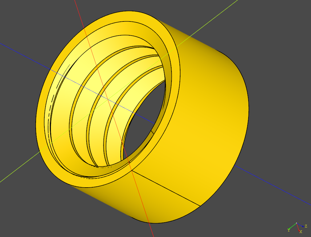

UPDATE: So I finally got CadQuery/CQ-editor installed and spent about three
hours playing with it today to design a simple part.
Conclusion: I will probably NOT be switching over to CadQuery.
I found the user interface to be clunky, and the editor is very basic with
little in the way of preferences.
CadQuery is very flexible, but flexibility breeds complexity.  The learning
curve is very steep.
In practice, I found it to work just as if you were documenting each step
you would take if you were using a drawing program such as TinkerCAD,
FreeCADD, etc. For simple parts, each line of code (or each layer in the
stack of functions) corresponds with a similar action on a drawing program:
Select a plane, do some 2D drawing, then cut or extrude, select some edges,
apply chamfer/fillets, and then repeat.
The devil is in the details and in understanding what is going on under the
hood (bonnet).  For example, I could extrude a regular polygon, but I could
not extrude a polyline (created from a list of points).  After much
searching, I found that one must use the .close() function between the
polyline and the extrude.
Of course, your mileage may vary and if you are transitioning from a
drawing program you may find it easier than this old guy.
End of report.

CadQuery is very powerful; it's for the power user, much like UNIX can be compared to Windows. A power user who does not fear learning things would always gravitate towards UNIX or a UNIX-like system (even MacOS I suppose).
Yes you're right, the installation of CadQuery and of cq-editor was a bit more difficult than is typical, and it's because these tools live in "Python world" which needs to know how to load libs etc. That's why they have tools such as conda, anaconda, mambaforge, etc. to handle library dependencies and library installations. Even I was not an expert in Python but I was able to install these tools after careful reading and a few trial and error steps. Yes it took a couple of hours in my case as well.
I still do like OpenSCAD, but for me it's crucial to have a tool that generates STEP files for CNC machining at my disposal. This is why I had to look beyond just OpenSCAD. Furthermore I'm very repulsed with the idea of using graphical user interfaces to create parts that are very similar to each other, with minor differences in between. In other words having a language with which to "program parts" is very agreeable with me; this is exactly what drew me to OpenSCAD initially.
Because CadQuery uses a B-rep lib as its backend, things like "shelling", "fillet", or even "chamfer" are built-ins. In other words smoothing things is easy; it's part of the backend library. These are frequently discussed topics on this forum. 'Helix' and other complex operations are also built-ins. Yes there is a learning curve with the extensive API, but once you start working on simple examples it becomes clearer and clearer. STL can be generated by CadQuery.
Well here is an example. Threads for screws are very easy to program. With about 300 lines of code I was able to write a complete thread library in two days, which generates both internal and external threads, with many options. (Now of course I will be maintaining it when I find bugs, which is expected because I'm using this in all of my projects.)
If you are interested in trying the thread generation code, it is here:
https://sourceforge.net/p/nl10/code/HEAD/tree/cq-code/common/metric_threads.py
If you add these few lines of code
show_object(internal_metric_thread(diameter=3.0,
pitch=0.5,
length=2.0,
bottom_chamfer=True,
base_tube_od=3.5))
to the bottom of thread lib linked above, opening in cq-editor will get you this:
[threads.png]
Cheers.
