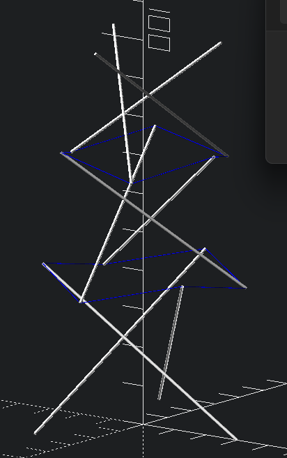

I personally like seeing what Sanjeev does with his hybrid process.  I, too, have used Python to generate OpenSCAD code
(see the attached tensegrity tower).

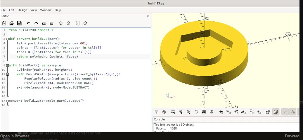

yes, i have also tested cadquery (actually build123d) and it's very
powerful.
openscad is not better or worse than cadquery, it's just 2 different
programs with different focuses and different strengths .
I like both of them!
Most value of cadquery is in its powerful opc kernel and you just " import
" into your python to make use of it.
Some time back I successfully imported the kernel into pythonscad and it
was working fine in linux.
see here:
build123d is just a cadquery derivative, it works like a charm.
why dont use both world in one model ?
too, have used Python to generate OpenSCAD code (see the attached
tensegrity tower).  However, I do admit that his programming is complex and
difficult to follow in his videos.  Someday, when I have more time, I'll
delve deeper into his techniques and see what I can learn.
