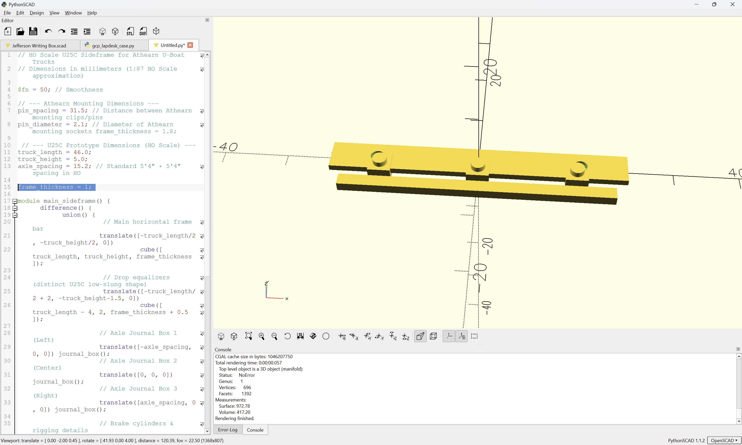

I am in need of some help with this code. This was AI generated when I to generate code to build an U25C sideframe to fit an Athearn power truck. (Yes, I'm a model railroader.) I don't have the knowledge to hand draw what I need.  The generated code is this (Spacing and indents have been put in as was generated in the webpage)::

When I try to run the code, it errors out with the message: 'Ignoring unknown module 'main_sideframe'. I know AI can have errors but as I have no idea where to begin, any ideas on how to fix this would be most welcomed.

It's missing a variable that defines the thickness of the frame.
Try adding this right after axle_spacing:
frame_thickness = 1;
It should give you somrthing to start with.

Looking at this, I see:
frame_thickness is used on line 20, but not defined --- what should it be?
Adding:
as line 15 allowed it to render in PythonSCAD (when set to use .scad code)
Why not try to draw it by hand? If you could provide a dimensioned sketch we could better advise.

Oh, there it is, in this line:
pin_diameter = 2.1; // Diameter of Athearn mounting sockets frame_thickness
= 1.8;
change to:
frame_thickness = 1.8;

On 9/13/2026 6:20 PM, Douglas Ochsner via Discuss wrote:
module main_sideframe() {
 // Render the sideframe
main_sideframe();
most welcomed.
Nobody has specifically addressed this comment.
And I won't either, because I don't see any problem with
main_sideframe() and my OpenSCAD doesn't either.
As others have said, fixing the definition of frame_thickness makes it
run to completion, though I have no idea whether it produces the model
that you want.
Adding:
That looks correct for the back but I would need to see the other side to see if that rendered properly.
William F. Adams wrote: > Looking at this, I see: > frame_thickness is used on line 20, but not defined --- what should it be? > Adding: > frame_thickness = 1; > as line 15 allowed it to render in PythonSCAD (when set to use .scad code) > > Why not try to draw it by hand? If you could provide a dimensioned sketch we could better advise. > William That looks correct for the back but I would need to see the other side to see if that rendered properly.
