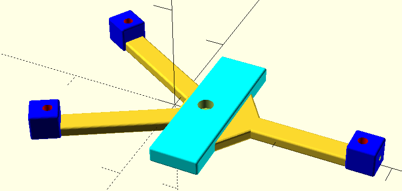

Thank you gentlemen, but as usual (for me), it turned out to be operator error. I was applying mikowski to the entire thing- it eventually finished (almost two hours), but the object it returned wasn't anything close to the one it started with.
I couldn't get it to do what I wanted with minkowski so I eventually bit the bullet and went through and resized everything.
But scale would have been a much easier and better idea- thanks Jon.
The object in question is a carry box for something I have called a "low-pod"- a very low to the ground, flat tripod. My good lady is a keen photographer and likes to take close-ups of flowers, fungi, tiny plants etc. which involves macro lenses and focus-stacking- often 20 or 30, several seconds long, exposures, so the camera needs to be very low to the ground and completely still for quite long periods. The easiest way I could come up with to make the carry box was to difference out the slightly scaled-up low-pod from a flattened cube.
I have attached screen shots of the two objects.

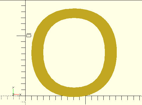

scale and minkowski (and positive offset, which is sort of a special
case of minkowski) look like they might do something similar, but they
really don't.
scale() makes every part of the object bigger. minkowski and offset
make it ... thicker.

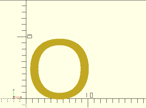

Let's look at a simple object: an O.
text("O");
Let's scale that up by 50%.
scale(1.5) text("O");

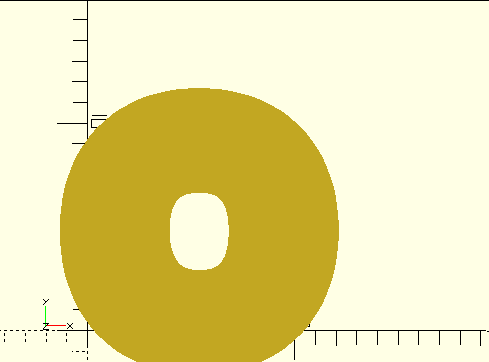

Now let's play with offset. That O starts out about 10 units square, so
scaling it up by 50% added about five units in X and Y. Let's use
offset to add, say, two units in all directions.
offset(2) text("O");
The new object is about 14 units square, as intended, but it's not at
all the same object. Where scale made the hole in the middle larger
(just as it made the rest of the figure larger), offset made the hole
smaller, because it pushed the inner boundary inward.
The default operation for offset is equivalent to 2D minkoswki with a
circle.

Again, minkowski pushes the inner boundary inward, because it rolls the
circle around both the inner and outer boundaries.

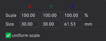

On Wed, 2024-09-11 at 22:05 +0100, Raymond West via Discuss wrote:
If you are 3d printing, as well as scaling it by %, you can put in
the final size you want for each direction.
I bought a Bambu Lab P1S early this year, and have been somewhat
spoiled by a feature in Bambu Studio. If I have an object I want to
scale, it gives me a box (attached image) in which I can choose to
scale by percentage or dimension, and if I uncheck uniform scale, I can
change one, two or three dimensions separately.
I have always had problems with OpenSCAD's scale, in that if I know
what length, width, or height, I want, I needed to do the math (not my
strong suit).
How hard would it be to incorporate something like that in the scale
function (or in BOSL2 for that matter)?
Of course, not everyone would want that functionality, so if it's not
worth the effort, I'm fine with that.
