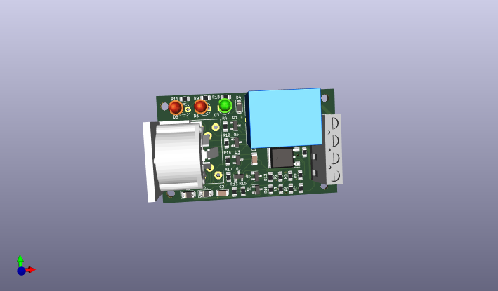

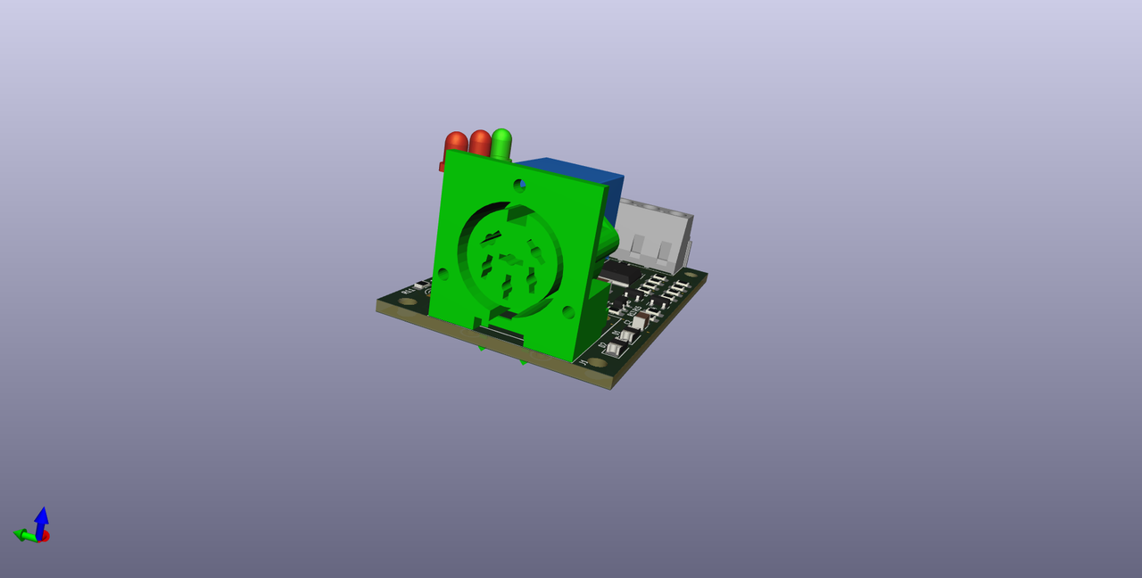

I've just started using OpenScad and have created a few simple boxes which has worked out well.
I'm now trying to design a few boxes that will fit my PCB's which I have designed using KiCAD and want to make sure that all the measurements are correct before getting them printed.
Is there any way I can take the 3D file from KiCAD (STL or OBJ) and place it virtually in the box to see if all the measurements/holes etc are lined up. Or is it a case of first taking careful measurements, doing the design in OpenScad, 3D printing a sample and check. Make corrections and keep repeating until its correct.
Example of the 3D Kicad image:
https://i.postimg.cc/cJkmNDSr/pic1.png
https://i.postimg.cc/C1Z4MjhJ/pic2.png
Picture of the box I've make in OpenScad:
https://i.postimg.cc/VLPF1r3B/1.png
Is this something that OpenScad supports? Is there any way to see if this will virtually fit before actually printing?

You can load most .STL files into OpenSCAD with import("myFile.stl"); Once
it is visible (you may need to zoom out to see where it is in OpenSCAD
space), you can use translate([anX, aY, aZ]) to put it where  you want it.
Add the OpenSCAD for your box, and zoom in to see if it has the right
clearance.

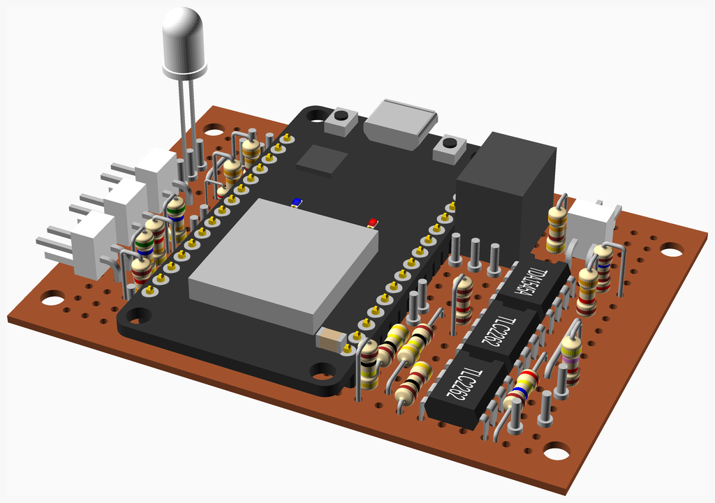

I model the PCB in OpenSCAD to just enough detail to fit boxes around it.
For example I sometimes just measure the board and its mounting holes but
usually I add the connectors and large components.
A lot of my circuits are built on veroboard or perfboard, or are closed
source modules from China, so I have no ECAD data for them, so I model
everything in OpenSCAD.

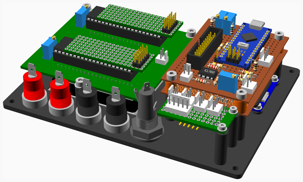

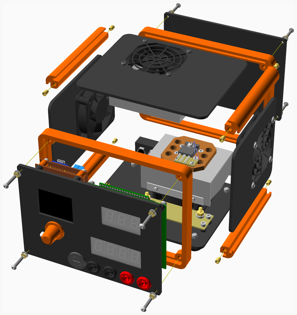

Here is a complex programmable load panel assembly that used part of a PCB
recycled from a solder station with perfboards soldered on top of ICs to
scrape the segment data from LED meters and convert to analogue voltages
for an Arduino nano to decode and convert to serial and do autoranging. The
main controller was an ESP32 underneath. There is also a four fan
controller on a third perboard and an OLED screen and shaft encoder
board buried below.
[image: box_top_assembled.png]
[image: controller_assembled.png]
[image: box_assembly.png]

I model the PCB in OpenSCAD to just enough detail to fit boxes around it. For example I sometimes just measure the board and its mounting holes but usually I add the connectors and large components. A lot of my circuits are built on veroboard or perfboard, or are closed source modules from China, so I have no ECAD data for them, so I model everything in OpenSCAD. Here is a complex programmable load panel assembly that used part of a PCB recycled from a solder station with perfboards soldered on top of ICs to scrape the segment data from LED meters and convert to analogue voltages for an Arduino nano to decode and convert to serial and do autoranging. The main controller was an ESP32 underneath. There is also a four fan controller on a third perboard and an OLED screen and shaft encoder board buried below. [image: box_top_assembled.png] [image: controller_assembled.png] [image: box_assembly.png] On Tue, 24 May 2022 at 10:58, Daniel <daniel@puggsy.net> wrote: > Have attached the python script & box-generating .scad I made. Fairly > rough but maybe you will find it useful. > > > It would be great if I could get it to automatically generate the box > following the same outline of the PCB but I'm not there yet. > > > -Daniel > > > > On 24/05/2022 10:39, Daniel wrote: > > Hi, > > > I often make boxes for things I designed in KiCad and wrote a script to > extract mount points. > > > See here for explanation how to use > > > https://www.eevblog.com/forum/3d-printing/kicad-to-openscad-for-pcb-case-generation/ > > > > -Daniel > > > On 24/05/2022 06:57, kl1k . wrote: > > I've just started using OpenScad and have created a few simple boxes which > has worked out well. > > I'm now trying to design a few boxes that will fit my PCB's which I have > designed using KiCAD and want to make sure that all the measurements are > correct before getting them printed. > > Is there any way I can take the 3D file from KiCAD (STL or OBJ) and place > it virtually in the box to see if all the measurements/holes etc are lined > up. Or is it a case of first taking careful measurements, doing the design > in OpenScad, 3D printing a sample and check. Make corrections and keep > repeating until its correct. > > Example of the 3D Kicad image: > https://i.postimg.cc/cJkmNDSr/pic1.png > https://i.postimg.cc/C1Z4MjhJ/pic2.png > > Picture of the box I've make in OpenScad: > https://i.postimg.cc/VLPF1r3B/1.png > > Is this something that OpenScad supports? Is there any way to see if this > will virtually fit before actually printing? > I found an article on importing the KiCad STL file into Fusion360 but > haven't found anything on how to do it in OpenScad? (Don't really want to > learn F360 after having spent a good few hours with OpenScad) > > _______________________________________________ > OpenSCAD mailing list > To unsubscribe send an email to discuss-leave@lists.openscad.org > > > _______________________________________________ > OpenSCAD mailing list > To unsubscribe send an email to discuss-leave@lists.openscad.org > > _______________________________________________ > OpenSCAD mailing list > To unsubscribe send an email to discuss-leave@lists.openscad.org >
Tue, May 24, 2022 12:11 PM
nop head:
I admire your tenacity, skill, and available hours.
