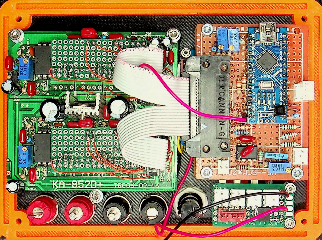

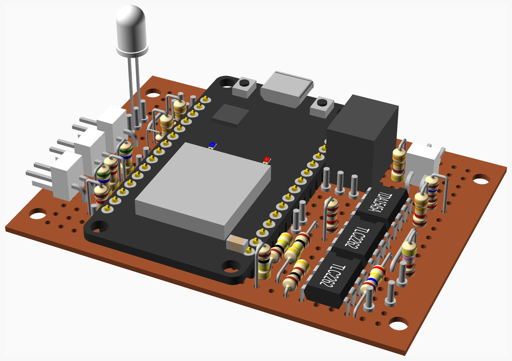

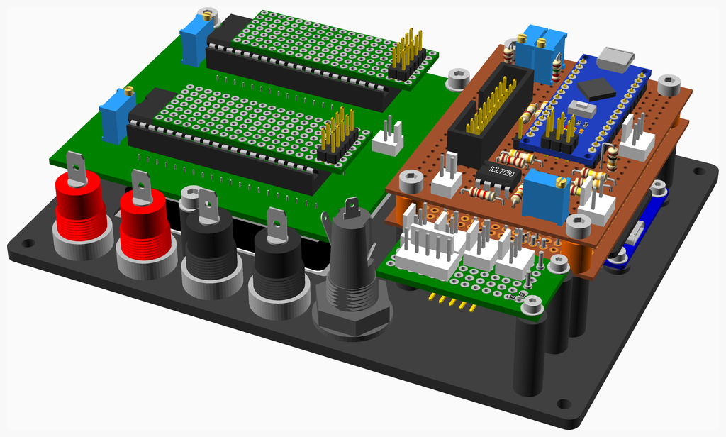

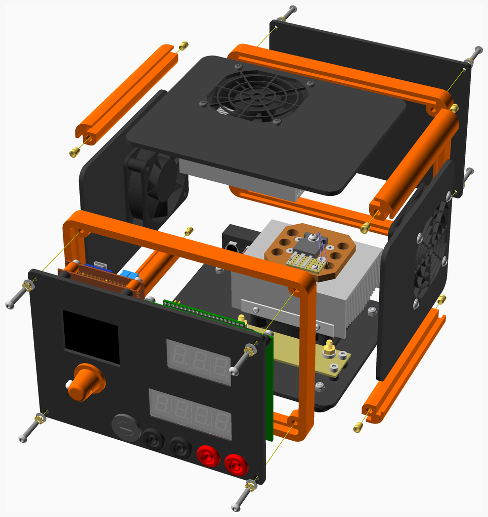

I model the PCB in OpenSCAD to just enough detail to fit boxes around it.
For example I sometimes just measure the board and its mounting holes but
usually I add the connectors and large components.
A lot of my circuits are built on veroboard or perfboard, or are closed
source modules from China, so I have no ECAD data for them, so I model
everything in OpenSCAD.
Here is a complex programmable load panel assembly that used part of a PCB
recycled from a solder station with perfboards soldered on top of ICs to
scrape the segment data from LED meters and convert to analogue voltages
for an Arduino nano to decode and convert to serial and do autoranging. The
main controller was an ESP32 underneath. There is also a four fan
controller on a third perboard and an OLED screen and shaft encoder
board buried below.

No but perhaps I can because I have some photos and notes and I have a
second identical solder station board to use in a second project but I am
not at home at the moment. Here is a  quick summary.
The solder stations were bizarre because they use potentiometers to drive
ICL7107 voltmeters to get a digital display and then another gang on the
pot sets the thermostat switch point in an analog circuit. So the display
isn't a digital temperature reading, it is just an accurate scale on the
pot showing the set point. An LED shows if the thermostat is on or off, so
you can see when it is at temperature.
Another weird thing is they had two diacs in each meter circuit, one in the
RC oscillator and another across the reference voltage but they could never
do anything because diacs don't turn on until about 30V and the circuit
runs at 5V. Even if they fitted normal diodes in the positions it would
make no sense. The RC oscillator would get an asymmetric duty cycle but the
first thing the chip does is divide it by four and a diode used as a 0.7V
reference would be worse than a potential divider from the regulated 5V
rail, which is actually how it works. I.e. they had resistors that gave
0.7V from 5V with a diac across it. I removed them and it didn't make the
slightest difference.
I replaced the diac with a precision 2.5V reference and changed the
resistors to get a more normal 100mV reference for 200mV full scale.
The ICL7107 directly drives 3 and half seven segment displays with constant
current 8ma per segment. That is far more than needed for modern 7 seg
displays that are designed to be multiplexed and far too much for the 5V
linear regulator, so they put a single 56R resistor in the supply to all
the display anodes. That meant the display brightness changed according to
how many segments were on. I replaced the resistor with a tiny buck
regulator to give about the same voltage as the resistor but it doesn't sag
when more segments are on and doesn't load the linear reg.
I added an extra digit to give a leading  0 or 1 on the current display
that I wanted to display up to 19.99A and put a single LED in place of the
leading digit on the voltmeter so that I could display 3 digits of voltage
but still detect overflow.
To scrape the numbers I worked out that you only need to look at segments
a, b, e, f and g to recognise the number. So that is 5 * 3 digits + 1 for
the leading 1, so 16 bits in total for each display. I grouped them into
groups of four and summed them with 100K, 200K, 400K and 800K resistors and
fed them into 8 analogue inputs of an Arduino Nano. That is why I needed
the anode voltage to be constant. The chip has internal pullups on the
segment drives ,so they switch from 5V to about 0.79V when on.  The Nano
reads the voltage and quantises it to a number between 0 and 15 to retrieve
the four bits. It then regroups then into 5 bit segments and does a table
lookup to convert to ascii.
the RC oscillator and another across the reference voltage but they could
never do anything because diacs don't turn on until about 30V and the
circuit runs at 5V. Even if they fitted normal diodes in the positions it
would make no sense. The RC oscillator would get an asymmetric duty cycle
but the first thing the chip does is divide it by four and a diode used as
a 0.7V reference would be worse than a potential divider from the regulated
5V rail, which is actually how it works. I.e. they had resistors that gave
constant current 8ma per segment. That is far more than needed for modern 7
seg displays that are designed to be multiplexed and far too much for the
5V linear regulator, so they put a single 56R resistor in the supply to all

The reason I convert from digital to analog and back to digital is just to
reduce the amount of wiring and inputs required on the micro. I
contemplated using old EPROM to do the same job but it would be more
difficult to wire up. I just used 0805 SMT resistors on top of the
perfboards. The 400K and 800K were made up of two in series.
The Nano also drives the decimal points that were not used in the solder
station and drives tiny MOSFETs to control the voltage divider for 999V,
99.9V and 9,99V voltage ranges and the feedback resistor in a chopper
stabilised OP amp that gives 19.99A and 9.999A current ranges with a 0.01R
shunt.
Another quirk of the solder station was they put green filters over red
LEDs, so I replaced it with red film! I also printed black rubber shrouds
which fit around the digits, firstly to align the extra floating one I
added and also to not show the internals through the film.
