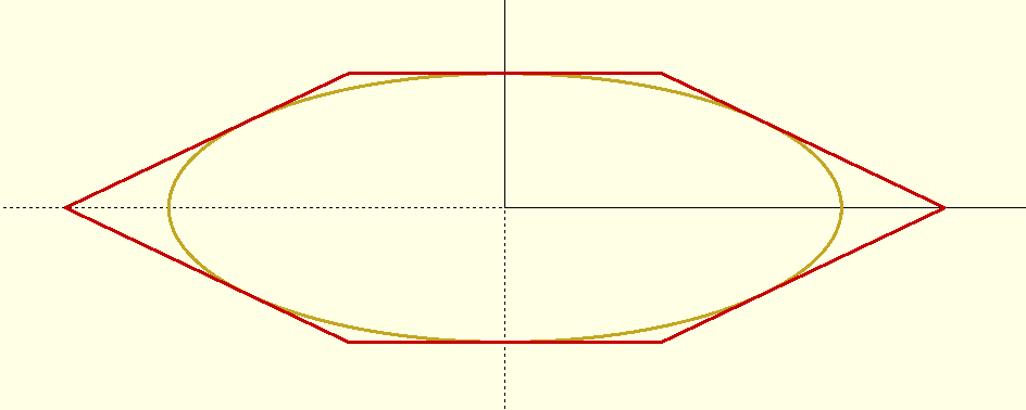

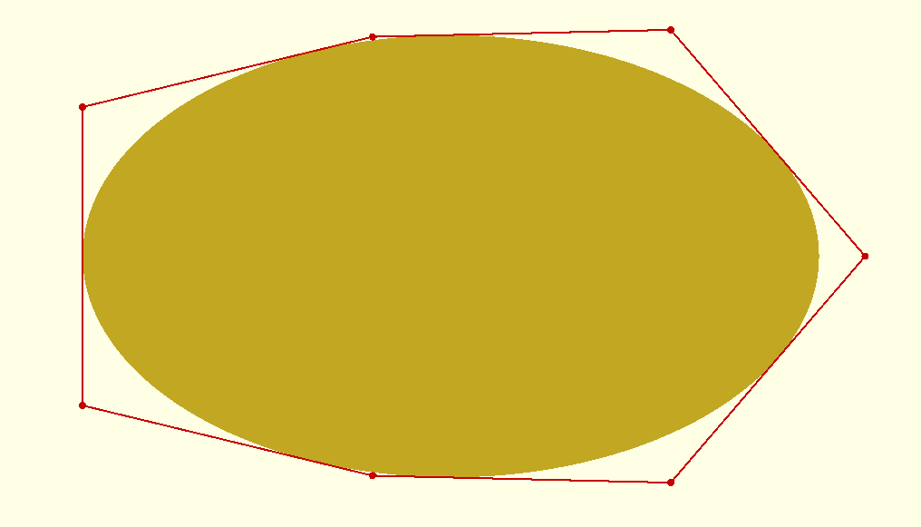

Circumscribed means tangents to points on the ellipse.  But
there are no arc lengths (equal or unequal) in this problem, nor equally
spaced angles.  The angles of each segment will be different.  But the
lengths of the segments are not the same as the arc lengths, which is why
arc length does not matter.  Here's a solution to the N=6 polygon sort of
inspired by the idea Jordan suggested, where I adjust the first segment
until the second segment has the right length.  The rest of the solution is
then obtained using symmetry, which means there is only a single unknown
that can simply be solved for.  But this doesn't generalize to higher N.
include<BOSL2/std.scad>
// ellipse semiaxes
// If a is much smaller than b it will fail
a=5;
b=2;
// Find point on ellipse at specified x coordinate
function ellipse_pt(a,b,x) = sqrt(b^2*(1-x^2/a^2));
// Find tangent line to ellipse at point (u,w)
// and determine the x value where that line has
// given y value.
function findx(a,b,u,w,y) =
let(
A = -ub^2/w/a^2,
B = w+(u
b)^2/w/a^2
(y-B)/A;
// First segment if tangent point is at x=u
function first_seg(a,b,u) =
let(
w = ellipse_pt(a,b,u),
x1 = findx(a,b,u,w,0),
x2 = findx(a,b,u,w,b)
[[x1,0],[x2,b]];
err = function (u) let(pt = first_seg(a,b,u))
2*pt[1].x - norm(pt[0]-pt[1]);
x = root_find(err,.2a,.9a);
first = first_seg(a,b,x);
top = concat(first,reverse(xflip(first)));
poly = concat(top, reverse(yflip(list_tail(top))));
stroke(ellipse([a,b]),width=.05,$fn=128,closed=true);
color("red")stroke(poly,width=.05,closed=true);
// Verify equality of segment lengths
echo(path_segment_lengths(poly,closed=true));

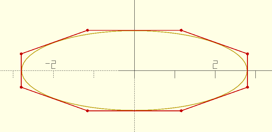

For circumscribed, it's not so hard.  You start with a
uniform-in-angle point distribution, compute the segment lengths, compare
to the mean segment length to get an error, and then compute an adjustment
based on the error.  It converges quickly.
So for example, I have segments lengths of:
ECHO: [5.57297, 5.57297, 5.57297, 5.57297, 5.57297,
5.57297, 5.57297, 5.57297]
Maybe not exactly equal, since tolerance is 1e-9, but
surely good enough.
<image.png>
The code for this is in BOSL2 in shapes2d.scad. A similar
algorithm should exist for the circumscribed case, but as I said, my
efforts to find it have failed.

Mon, Aug 8, 2022 8:40 PM
So I hate spreadsheets and it's too hard to decipher what you've done by
looking at the spread sheet.  I actually coded this up myself in OpenSCAD
And if there's a way to handle the N divisible by 4 case, I am not seeing
it.  For the N=4k+2 case you start at [b,L/2] and work your way around
clockwise and place the segments to make a quarter-ellipse polygon.
Assuming you're length estimate isn't terrible you'll place all the
segments but end up slightly above/below the X axis.  Based on how big the
vertical error is, you update the length and iterate to get a solution.
That produces a result that looks like this once you rotate and reflect to
get a full ellipse instead of just a 1/4 ellipse:
Notice how the polygon has a flat segment on top but is pointy on the
right?
If N is odd then you start at [-a,L/2] and work your way clockwise around
the ellipse, and then end with the same constraint.  In this case there is
less symmetry and you have to build a half-ellipse.
I made the ellipse fatter because otherwise the side segments appear
coplanar.  So here we have started on the left with a "flat" segment and
ended a half-ellipse on the right at a corner.
There are two other cases that arise for N divisible by 4 where we start
and end on a point or a flat.  Starting on a point is problematic because
you have an extra parameter of how far away from the ellipse to put the
point.  And ending on a flat is problematic because you have a target that
is two-dimensional, e.g. [a,L/2] and it's no longer apparent how to modify
the length to guarantee an improvement.  If you and up [.1,.1] away from
the target...what should you do?  Presumably this could be handled by
using a multi-dimensional optimization solver, but I don't have one of
those for OpenSCAD and it does seem kind of like overkill.
Here's the code:
function ellipse_tangents(a,b,pt) =
let(
r=a,
scaledpt = yscale(a/b,pt),
tangents = circle_point_tangents(r,[0,0],scaledpt)
yscale(b/a,tangents);
function ellipse_next_pt(a,b,pt,L) =
let(
tanglist = ellipse_tangents(a,b,pt),
//f=echo(pt=pt,tanglist=tanglist),
tang = tanglist[0].x>pt.x ? tanglist[0]
: len(tanglist)==2 && tanglist[1].x>pt.x ? tanglist[1]
: assert(false,"cannot find acceptable tangent")
assert(norm(tang-pt)<L,"Tangent is too far away")
L*unit(tang-pt)+pt;
function ellipse_path(a,b,L,N,path=[]) =
len(path)==0 ? ellipse_path(a,b,L,N,[[L/2,b]])
: len(path)==N ? path
: last(path).y<=0 ? path
: last(path).x>=a ? path
: ellipse_path(a,b,L,N,
[each path, ellipse_next_pt(a,b,last(path),L)]);
function ellipse_circ(a,b) = PI*(3*(a+b) - sqrt(10ab+3*(a^2+b^2)));
function cellipse(a,b,N) =
assert(N%4==2, "Must have N of form 4k+2")
let(
errfunc = function(L) let(path=(ellipse_path(a,b,L,(N+2)/4)))
-last(path).y+
((N+2)/4 - len(path)) * b ,
lengthguess = ellipse_circ(a,b)/N,
L = root_find(errfunc, 0.95lengthguess, 1.5lengthguess),
path = ellipse_path(a,b,L,(N+2)/4),
right = concat(path, yflip(list_tail(reverse(path))))
concat(right, reverse(xflip(right)));
function cellipse_odd(a,b,N) =
assert(N%2==1, "Must have N of form 2k+1")
let(
let(path=ellipse_path(a,b,L,(N+1)/2,[[-a,L/2]]))
-last(path).y+
((N+1)/2 - len(path)) * b ,
path = ellipse_path(a,b,L,(N+1)/2,[[-a,L/2]])
concat(path, list_tail(reverse(yflip(path))));
a=10;
b=6;
N = 7;
p = N%2==1 ? cellipse_odd(a,b,N)
: cellipse(a,b,N);
echo(length = len(p));
ellipse([a,b],$fn=164);
color("red")stroke([p],width=.05,dots=true,dots_width=4);

On Aug 5, 2022, at 15:38, Adrian Mariano avm4@cornell.edu
I don't have a specific need for a circumscribing elliptical
polygon with equal sides.  I was writing code to make ellipses and it
seemed like equal side approximations would be nice, so I solved the case
for inscribed, but couldn't solve the circumscribed case.  So it's an
unsolved puzzle I've got that this discussion reminded me of.
surely good enough.
<image.png>

Here's a Python version that gets the first quadrant right:
import math
major = 2
minor = 1
length = 1.03
px = length / 2
py = minor
for i in range(1, 3):
c = px / major
d = py / minor
print(f"Adjusted point off circle is ({c:.3f},{d:.3f})")
a = (2 * c + math.sqrt(4 * c * c - 4 * (d * d + c * c) * (1 - d * d)))
/ (2 * (d * d + c * c))
b = math.sqrt(1 - a * a)
print(f"Point on circle is ({a:.3f}, {b:.3f})")
ex = a * major
ey = b * minor
print(f"Point on ellipse is ({ex:.3f}, {ey:.3f})")
m = (py - ey) / (px - ex)
xhat = math.sqrt(length * length / (1 + m * m))
yhat = m * xhat
px = px + xhat
py = py + yhat
print(f"New point off circle is ({px:.3f}, {py:.3f})")
On Mon, Aug 8, 2022 at 3:41 PM Adrian Mariano avm4@cornell.edu wrote:
It's never necessary to do more than half the ellipse, which I think
makes handling the multiplicity of tangents easier.
On Mon, Aug 8, 2022 at 4:30 PM Father Horton fatherhorton@gmail.com
On Mon, Aug 8, 2022 at 3:23 PM Michael Möller private2michael@gmail.com
y and x if divisible by 4, right?
Right, which would make calculation easier since I wouldn't have to deal
with those nasty quadrant changes.
Here's a Python version that gets the first quadrant right: import math major = 2 minor = 1 length = 1.03 px = length / 2 py = minor for i in range(1, 3): c = px / major d = py / minor print(f"Adjusted point off circle is ({c:.3f},{d:.3f})") a = (2 * c + math.sqrt(4 * c * c - 4 * (d * d + c * c) * (1 - d * d))) / (2 * (d * d + c * c)) b = math.sqrt(1 - a * a) print(f"Point on circle is ({a:.3f}, {b:.3f})") ex = a * major ey = b * minor print(f"Point on ellipse is ({ex:.3f}, {ey:.3f})") m = (py - ey) / (px - ex) xhat = math.sqrt(length * length / (1 + m * m)) yhat = m * xhat px = px + xhat py = py + yhat print(f"New point off circle is ({px:.3f}, {py:.3f})") On Mon, Aug 8, 2022 at 3:41 PM Adrian Mariano <avm4@cornell.edu> wrote: > It's never necessary to do more than half the ellipse, which I think > makes handling the multiplicity of tangents easier. > > On Mon, Aug 8, 2022 at 4:30 PM Father Horton <fatherhorton@gmail.com> > wrote: > > > > > > > > On Mon, Aug 8, 2022 at 3:23 PM Michael Möller <private2michael@gmail.com> > wrote: > >> > >> y and x if divisible by 4, right? > > > > > > Right, which would make calculation easier since I wouldn't have to deal > with those nasty quadrant changes. > > _______________________________________________ > > OpenSCAD mailing list > > To unsubscribe send an email to discuss-leave@lists.openscad.org > _______________________________________________ > OpenSCAD mailing list > To unsubscribe send an email to discuss-leave@lists.openscad.org >
Mon, Aug 8, 2022 9:28 PM
So that code just works around the ellipse, making 3 steps at the
fixed length, right?  The hard part isn't doing that---it's being able
to automatically update so that you get the correct answer.  What
happens if you try to do this manual process but for an ellipse that
starts with a full segment whose endpoint is [0,b+extra] for some
extra corner offset distance?  Or one that starts the same but ends at
[b,L/2].  I haven't actually tried running these processes to see how
it behaves.
import math
major = 2
minor = 1
length = 1.03
px = length / 2
py = minor
c = px / major
d = py / minor
 ex = a * major
 ey = b * minor
 yhat = m * xhat
 px = px + xhat
 py = py + yhat

You change L until it works. I'd start with an estimate (Ramanujan's?) of
the perimeter of the ellipse and divide by N to get an estimate for L. Step
around and if L is too short, increase it by say 10%, and if it's too long,
decrease by 10%. Once you have the right distance bracketed, do a binary
search.

You change L until it works. I'd start with an estimate (Ramanujan's?) of the perimeter of the ellipse and divide by N to get an estimate for L. Step around and if L is too short, increase it by say 10%, and if it's too long, decrease by 10%. Once you have the right distance bracketed, do a binary search. On Mon, Aug 8, 2022 at 4:29 PM Adrian Mariano <avm4@cornell.edu> wrote: > So that code just works around the ellipse, making 3 steps at the > fixed length, right? The hard part isn't doing that---it's being able > to automatically update so that you get the correct answer. What > happens if you try to do this manual process but for an ellipse that > starts with a full segment whose endpoint is [0,b+extra] for some > extra corner offset distance? Or one that starts the same but ends at > [b,L/2]. I haven't actually tried running these processes to see how > it behaves. > > On Mon, Aug 8, 2022 at 4:47 PM Father Horton <fatherhorton@gmail.com> > wrote: > > > > Here's a Python version that gets the first quadrant right: > > > > import math > > > > major = 2 > > minor = 1 > > > > length = 1.03 > > > > px = length / 2 > > py = minor > > > > for i in range(1, 3): > > c = px / major > > d = py / minor > > print(f"Adjusted point off circle is ({c:.3f},{d:.3f})") > > > > > > a = (2 * c + math.sqrt(4 * c * c - 4 * (d * d + c * c) * (1 - d * > d))) / (2 * (d * d + c * c)) > > b = math.sqrt(1 - a * a) > > > > print(f"Point on circle is ({a:.3f}, {b:.3f})") > > > > ex = a * major > > ey = b * minor > > print(f"Point on ellipse is ({ex:.3f}, {ey:.3f})") > > > > m = (py - ey) / (px - ex) > > xhat = math.sqrt(length * length / (1 + m * m)) > > yhat = m * xhat > > px = px + xhat > > py = py + yhat > > > > print(f"New point off circle is ({px:.3f}, {py:.3f})") > > > > > > On Mon, Aug 8, 2022 at 3:41 PM Adrian Mariano <avm4@cornell.edu> wrote: > >> > >> It's never necessary to do more than half the ellipse, which I think > >> makes handling the multiplicity of tangents easier. > >> > >> On Mon, Aug 8, 2022 at 4:30 PM Father Horton <fatherhorton@gmail.com> > wrote: > >> > > >> > > >> > > >> > On Mon, Aug 8, 2022 at 3:23 PM Michael Möller < > private2michael@gmail.com> wrote: > >> >> > >> >> y and x if divisible by 4, right? > >> > > >> > > >> > Right, which would make calculation easier since I wouldn't have to > deal with those nasty quadrant changes. > >> > _______________________________________________ > >> > OpenSCAD mailing list > >> > To unsubscribe send an email to discuss-leave@lists.openscad.org > >> _______________________________________________ > >> OpenSCAD mailing list > >> To unsubscribe send an email to discuss-leave@lists.openscad.org > > > > _______________________________________________ > > OpenSCAD mailing list > > To unsubscribe send an email to discuss-leave@lists.openscad.org > _______________________________________________ > OpenSCAD mailing list > To unsubscribe send an email to discuss-leave@lists.openscad.org >
Mon, Aug 8, 2022 10:18 PM
Did you see my post earlier that actually implements the entire
end-to-end process, including estimating L
When starting at a point there are TWO parameters, L and "extra", the
distance of the point away from the ellipse.  If you have extra wrong
you will presumably never get a solution no matter how much you fiddle
with L.  This could be addressed by hitting with a 2d optimization
method, but as I said, that seems overcomplex and I don't have such a
code implemented in OpenSCAD.
Actually I was just thinking a bit more about the case of starting a
quadrant and ending on a flat.  That means start at [b,L/2] and end on
[a,L/2].  I tweaked the code to end with y=L/2 and it fails.  That is,
the resulting point it finds doesn't have x=b.  But there doesn't seem
to be another degree of freedom.  It would therefore appear that the
case of four flat ellipse ends is generally impossible.  Have I missed
something?
