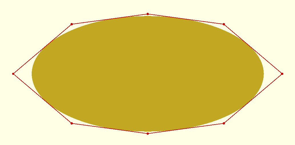

I started wondering about the case of a four-point polygon fit and
whether the problem might just be underdetermined.  So I tried running
the process starting with [0,b+extra] and found that I can indeed get
different solutions for a range of values of extra.
I attached two different polygons for the same ellipse with different
extra values.  So of course then the question is whether there's an
easy way to find the solution with minimal area.  :)
On Mon, Aug 8, 2022 at 6:18 PM Adrian Mariano avm4@cornell.edu wrote:
Did you see my post earlier that actually implements the entire
end-to-end process, including estimating L
When starting at a point there are TWO parameters, L and "extra", the
distance of the point away from the ellipse.  If you have extra wrong
you will presumably never get a solution no matter how much you fiddle
with L.  This could be addressed by hitting with a 2d optimization
method, but as I said, that seems overcomplex and I don't have such a
code implemented in OpenSCAD.
Actually I was just thinking a bit more about the case of starting a
quadrant and ending on a flat.  That means start at [b,L/2] and end on
[a,L/2].  I tweaked the code to end with y=L/2 and it fails.  That is,
the resulting point it finds doesn't have x=b.  But there doesn't seem
to be another degree of freedom.  It would therefore appear that the
case of four flat ellipse ends is generally impossible.  Have I missed
something?
On Mon, Aug 8, 2022 at 5:37 PM Father Horton fatherhorton@gmail.com wrote:
You change L until it works. I'd start with an estimate (Ramanujan's?) of the perimeter of the ellipse and divide by N to get an estimate for L. Step around and if L is too short, increase it by say 10%, and if it's too long, decrease by 10%. Once you have the right distance bracketed, do a binary search.
