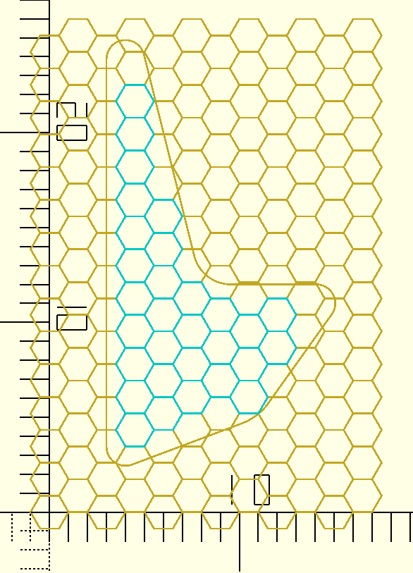

Fri, Feb 3, 2023 5:14 PM
I just wrote the function honeycomb and function to get the segments inside
any arbitrary enclosed section.
It is defined in such a way that only the segments which are completely
within the section are selected
[image: Screenshot 2023-02-03 at 10.37.14 PM.png]

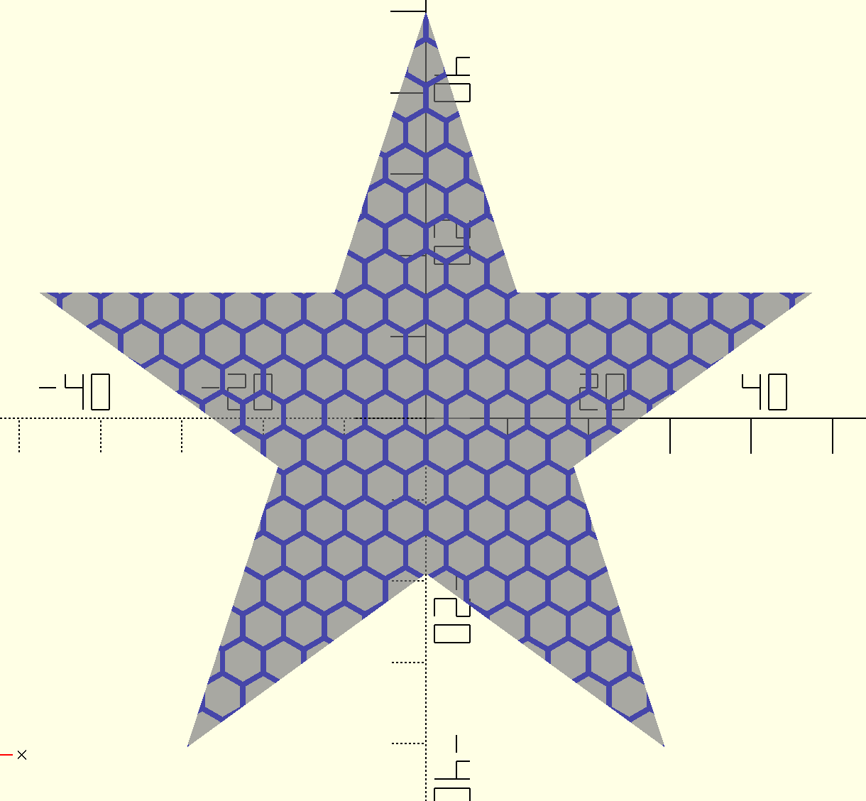

Fri, Feb 3, 2023 7:59 PM
I forgot to add parameters for hex size and cell wall thickness.  Here's updated code:
function honeycomb(shape, spacing=10, hex_wall=1) =
let(
hex = hexagon(od=spacing-hex_wall/2, spin=180/6),
bounds = pointlist_bounds(shape),
size = bounds[1] - bounds[0],
hex_rgn2 = grid_copies(spacing=spacing, size=size, stagger=true, p=hex),
center = (bounds[0] + bounds[1]) / 2,
hex_rgn = move(center, p=hex_rgn2),
ihex_rgn = intersection(hex_rgn, shape),
out_rgn = difference(shape, ihex_rgn)
) out_rgn;
module honeycomb(shape, spacing=10, hex_wall=1) {
rgn = honeycomb(shape, spacing=spacing, hex_wall=hex_wall);
region(rgn);
shape = star(n=5, step=2, d=100, spin=90/5);
%region(shape);
color("blue") honeycomb(shape, spacing=8, hex_wall=0.8);

<Screenshot 2023-02-03 at 11.49.17 AM.png>

Sat, Feb 4, 2023 12:24 AM
If you see it carefully in the example shared by me it is not intersection.
In example shared by you it is intersection which is easier.
The intent of Dan seems to be to get the complete honeycomb inside a shape
hex_rgn2 = grid_copies(spacing=5, size=size, stagger=true, p=hex),
) out_rgn;
module honeycomb(shape) {
rgn = honeycomb(shape);
region(rgn);
%region(shape);
color("blue") honeycomb(shape);
[image: Screenshot 2023-02-03 at 11.49.17 AM.png]
  • Revar
On Feb 3, 2023, at 9:14 AM, Sanjeev Prabhakar sprabhakar2006@gmail.com
inside any arbitrary enclosed section.
<Screenshot 2023-02-03 at 10.37.14 PM.png>
On Fri, 3 Feb 2023 at 08:44, Dan Perry dan.p3rry@gmail.com wrote:
I would like to fill an arbitrary convex shape with hexagons (honeycomb
pattern).
I wrote a couple modules that do this on a circle and donut, but an
arbitrary shape is more challenging, primarily because I haven't found a
straightforward way to calculate the left/right/top/bottom extremes of an
arbitrary 2D shape, so I know where to start and stop.
(I'm planning to use BOSL2 point_in_region() once I figure out the range
of coordinates.  Suggestions are welcome😊)
Thanks,
Dan
If you see it carefully in the example shared by me it is not intersection. In example shared by you it is intersection which is easier. The intent of Dan seems to be to get the complete honeycomb inside a shape On Sat, 4 Feb, 2023, 1:22 am Revar Desmera, <revarbat@gmail.com> wrote: > Using BOSL2, a lot of the work can be done for you: > > include <BOSL2/std.scad> > honeycomb(shape) = > let( > hex = hexagon(d=5, spin=180/6), > bounds = pointlist_bounds(shape), > size = bounds[1] - bounds[0], > hex_rgn2 = grid_copies(spacing=5, size=size, stagger=true, p=hex), > center = (bounds[0] + bounds[1]) / 2, > hex_rgn = move(center, p=hex_rgn2), > ihex_rgn = intersection(hex_rgn, shape), > out_rgn = difference(shape, ihex_rgn) > ) out_rgn; > > module honeycomb(shape) { > rgn = honeycomb(shape); > region(rgn); > } > > shape = star(n=5, step=2, d=100, spin=90/5); > %region(shape); > color("blue") honeycomb(shape); > > > [image: Screenshot 2023-02-03 at 11.49.17 AM.png] > > - Revar > > > > On Feb 3, 2023, at 9:14 AM, Sanjeev Prabhakar <sprabhakar2006@gmail.com> > wrote: > > I just wrote the function honeycomb and function to get the segments > inside any arbitrary enclosed section. > It is defined in such a way that only the segments which are completely > within the section are selected > <Screenshot 2023-02-03 at 10.37.14 PM.png> > > > On Fri, 3 Feb 2023 at 08:44, Dan Perry <dan.p3rry@gmail.com> wrote: > >> I would like to fill an arbitrary convex shape with hexagons (honeycomb >> pattern). >> I wrote a couple modules that do this on a circle and donut, but an >> arbitrary shape is more challenging, primarily because I haven't found a >> straightforward way to calculate the left/right/top/bottom extremes of an >> arbitrary 2D shape, so I know where to start and stop. >> (I'm planning to use BOSL2 point_in_region() once I figure out the range >> of coordinates. Suggestions are welcome😊) >> Thanks, >> Dan >> >> >> >> >> _______________________________________________ >> OpenSCAD mailing list >> To unsubscribe send an email to discuss-leave@lists.openscad.org >> > _______________________________________________ > OpenSCAD mailing list > To unsubscribe send an email to discuss-leave@lists.openscad.org > > > _______________________________________________ > OpenSCAD mailing list > To unsubscribe send an email to discuss-leave@lists.openscad.org >
