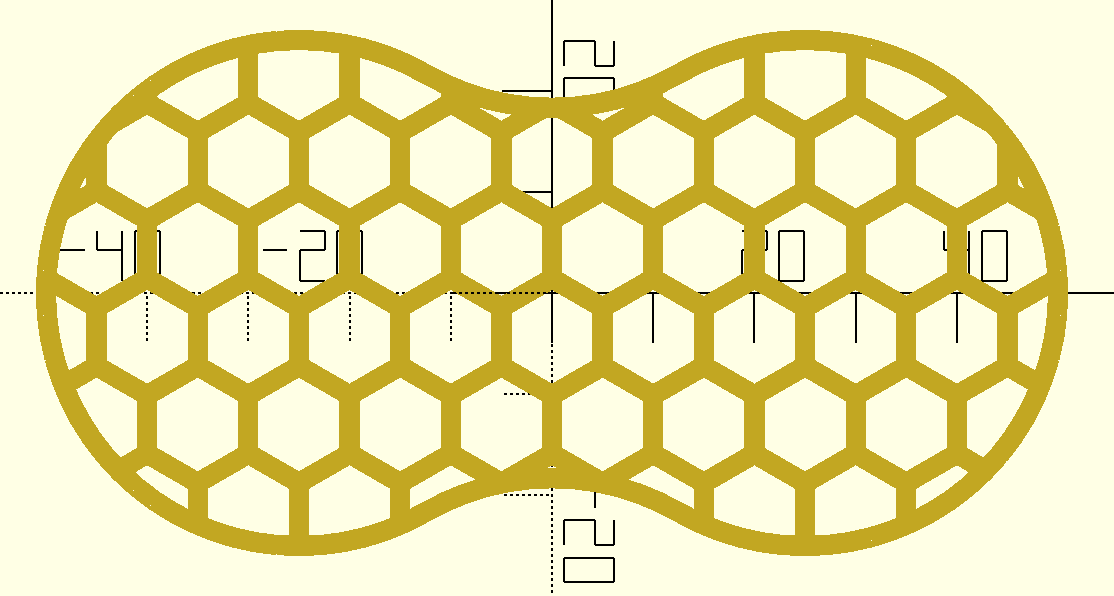

Sorry, that usage of `grid_copies()` is a recent addition to the library. Upgrade to the latest revision and it should work. - Revar > On Feb 4, 2023, at 5:07 PM, Dan Perry <dan.p3rry@gmail.com> wrote: > > Thanks, Revar. When I pasted your code into my program, I got this error from OpenSCAD. Do I need to update my copy of BOSL2, or is it something else? > Dan > > WARNING: variable p not specified as parameter in file wire_spool.scad, line 182 <> [line 182 is: hex_rgn2 = grid_copies(spacing=5, size=size, stagger=true, p=hex),] > ERROR: Assertion 'false' failed: "You called grid_copies() as a function, but it is available only as a module" in file ../../OpenSCAD/libraries/BOSL2/utility.scad, line 790 <> > > TRACE: called by 'no_function' in file ../../OpenSCAD/libraries/BOSL2/distributors.scad, line 402 <> > > TRACE: called by 'grid_copies' in file wire_spool.scad, line 182 <> > > TRACE: called by 'honeycomb' in file wire_spool.scad, line 190 <> > > TRACE: called by 'honeycomb' in file wire_spool.scad, line 196 <> > > TRACE: called by 'color' in file wire_spool.scad, line 196 <> > > > > > > > > > > > On Fri, Feb 3, 2023 at 12:00 PM Revar Desmera <revarbat@gmail.com <mailto:revarbat@gmail.com>> wrote: >> I forgot to add parameters for hex size and cell wall thickness. Here's updated code: >> >> function honeycomb(shape, spacing=10, hex_wall=1) = >> let( >> hex = hexagon(od=spacing-hex_wall/2, spin=180/6), >> bounds = pointlist_bounds(shape), >> size = bounds[1] - bounds[0], >> hex_rgn2 = grid_copies(spacing=spacing, size=size, stagger=true, p=hex), >> center = (bounds[0] + bounds[1]) / 2, >> hex_rgn = move(center, p=hex_rgn2), >> ihex_rgn = intersection(hex_rgn, shape), >> out_rgn = difference(shape, ihex_rgn) >> ) out_rgn; >> >> module honeycomb(shape, spacing=10, hex_wall=1) { >> rgn = honeycomb(shape, spacing=spacing, hex_wall=hex_wall); >> region(rgn); >> } >> >> shape = star(n=5, step=2, d=100, spin=90/5); >> %region(shape); >> color("blue") honeycomb(shape, spacing=8, hex_wall=0.8); >> >> - Revar >> >> >>> On Feb 3, 2023, at 11:51 AM, Revar Desmera <revarbat@gmail.com <mailto:revarbat@gmail.com>> wrote: >>> >>> Using BOSL2, a lot of the work can be done for you: >>> >>> include <BOSL2/std.scad> >>> honeycomb(shape) = >>> let( >>> hex = hexagon(d=5, spin=180/6), >>> bounds = pointlist_bounds(shape), >>> size = bounds[1] - bounds[0], >>> hex_rgn2 = grid_copies(spacing=5, size=size, stagger=true, p=hex), >>> center = (bounds[0] + bounds[1]) / 2, >>> hex_rgn = move(center, p=hex_rgn2), >>> ihex_rgn = intersection(hex_rgn, shape), >>> out_rgn = difference(shape, ihex_rgn) >>> ) out_rgn; >>> >>> module honeycomb(shape) { >>> rgn = honeycomb(shape); >>> region(rgn); >>> } >>> >>> shape = star(n=5, step=2, d=100, spin=90/5); >>> %region(shape); >>> color("blue") honeycomb(shape); >>> >>> <Screenshot 2023-02-03 at 11.49.17 AM.png> >>> >>> - Revar >>> >>> >>> >>>> On Feb 3, 2023, at 9:14 AM, Sanjeev Prabhakar <sprabhakar2006@gmail.com <mailto:sprabhakar2006@gmail.com>> wrote: >>>> >>>> I just wrote the function honeycomb and function to get the segments inside any arbitrary enclosed section. >>>> It is defined in such a way that only the segments which are completely within the section are selected >>>> <Screenshot 2023-02-03 at 10.37.14 PM.png> >>>> >>>> >>>> On Fri, 3 Feb 2023 at 08:44, Dan Perry <dan.p3rry@gmail.com <mailto:dan.p3rry@gmail.com>> wrote: >>>>> I would like to fill an arbitrary convex shape with hexagons (honeycomb pattern). >>>>> I wrote a couple modules that do this on a circle and donut, but an arbitrary shape is more challenging, primarily because I haven't found a straightforward way to calculate the left/right/top/bottom extremes of an arbitrary 2D shape, so I know where to start and stop. >>>>> (I'm planning to use BOSL2 point_in_region() once I figure out the range of coordinates. Suggestions are welcome😊) >>>>> Thanks, >>>>> Dan >>>>> >>>>> >>>>> >>>>> >>>>> _______________________________________________ >>>>> OpenSCAD mailing list >>>>> To unsubscribe send an email to discuss-leave@lists.openscad.org <mailto:discuss-leave@lists.openscad.org> >>>> _______________________________________________ >>>> OpenSCAD mailing list >>>> To unsubscribe send an email to discuss-leave@lists.openscad.org <mailto:discuss-leave@lists.openscad.org> >>> >> >> _______________________________________________ >> OpenSCAD mailing list >> To unsubscribe send an email to discuss-leave@lists.openscad.org <mailto:discuss-leave@lists.openscad.org> > _______________________________________________ > OpenSCAD mailing list > To unsubscribe send an email to discuss-leave@lists.openscad.org
Sun, Feb 5, 2023 2:22 AM
Found a bug in the hex_wall setting.  Updated code:
let(
hex = hexagon(id=spacing-hex_wall, spin=180/6),
) out_rgn;
region(rgn);
shape = glued_circles(d=50, spread=50, tangent=30);
wall = 2;
linear_extrude(height=10) {
honeycomb(shape, spacing=10, hex_wall=wall);
stroke(shape, width=wall, closed=true);
  • Revar

Thanks Revar, that small change has saved me almost 24 hours printing
time and nearly 80m of filament. I had designed a rectangular parts
storage box with honeycomb shaped shelves using (in part) your code, but
couldn't make the walls of the honeycomb thin enough. Your fix enabled
me to make the walls the thickness I wanted. Now I can have my oddball
storage box- happy days!

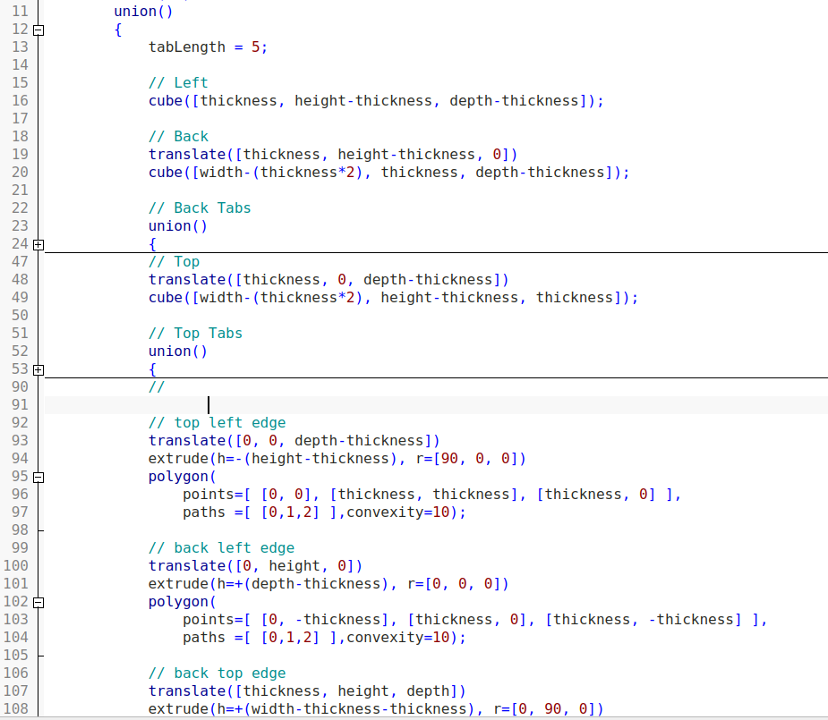

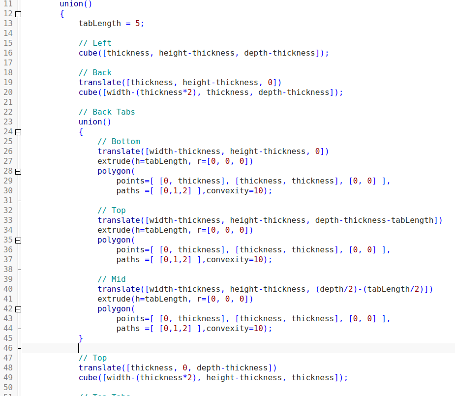

i would really like to see a way to stop the code folding from including
white-space after the closing bracket, it is really irritating as
anything outside the end closing bracket is clearly not part of the code
to be folded or it wouldn't be after the closing of the statement.
example screenshot attached line 46 has no reason to fold with line 24,
it drives me up the wall having to put // after every closing bracket
bellow screenshot line 24 serves no purpose being visible after folding
and should fold to line 23.
and line 26 is not part of the fold block yet is has been folded
line 90 has a // that stop it folding any whitespace, but this shouldent
be necessary
Microsoft visual studio does a good job of folding code properly as an
example
(great shame visual studio is written by Microsoft, it hurts to admit
Microsoft managed to do something right)
i would really like to see a way to stop the code folding from including white-space after the closing bracket, it is really irritating as anything outside the end closing bracket is clearly not part of the code to be folded or it wouldn't be after the closing of the statement. example screenshot attached line 46 has no reason to fold with line 24, it drives me up the wall having to put // after every closing bracket bellow screenshot line 24 serves no purpose being visible after folding and should fold to line 23. and line 26 is not part of the fold block yet is has been folded line 90 has a // that stop it folding any whitespace, but this shouldent be necessary Microsoft visual studio does a good job of folding code properly as an example (great shame visual studio is written by Microsoft, it hurts to admit Microsoft managed to do something right)
Mon, Feb 6, 2023 12:02 AM
Apparently, there is an OpenSCAD extension for Visual Studio:
https://marketplace.visualstudio.com/items?itemName=Antyos.openscad
be necessary
example
