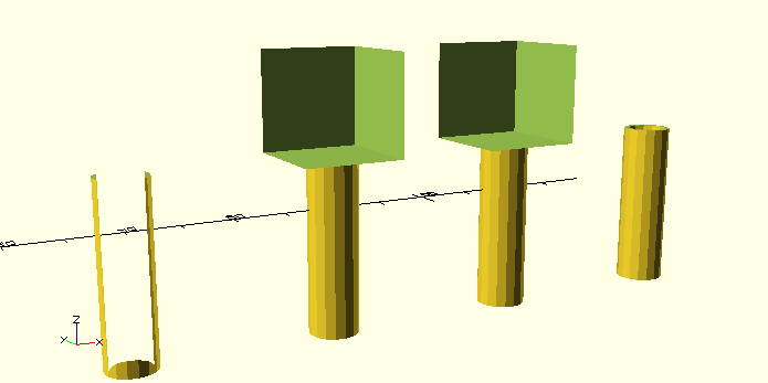

This is a distilled version of the code I was having a problem with:
for(c = [1:4])
translate([c * 40, 0])
difference () {
linear_extrude(height = 50, center = true, convexity = c)
circle(5);
circle(4);
        translate([0, 0, 20])
            cube(20, center = true);
This is how it looks on my old laptop:

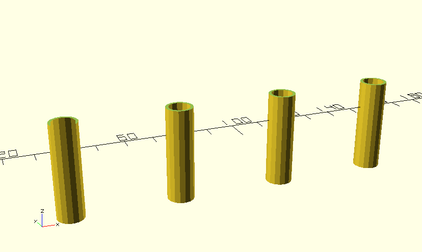

And this is how it looks on my normal desktop machine, which also has Intel
graphics but it never gives me problems. Goldfeather makes no difference.
It seems 2 is sufficient on this machine but the old machine needs 4.
The manual says "Integer number of "inward" curves, ie. expected path
crossings of an arbitrary line through the polygon." in one place and "The
convexity parameter specifies the maximum number of front sides (back
sides) a ray intersecting the object might penetrate" in another.
Neither statement is clear to me. What does " front sides (back sides)"
mean?
If it is simply the maximum number of edges a line can pass through then I
agree it should be 4 for a tube.
