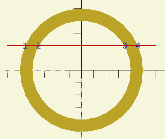

Two outer walls, plus two inner walls for the tube.
  • Revar
On Jun 13, 2019, at 11:41 PM, Troberg troberg.anders@gmail.com wrote:
RevarBat wrote
A line could possibly pass through a maximum of four walls of a tube, so
convexity should be 4.
I can't see how a straight line could pass through more than two walls. How
would it pass through four???

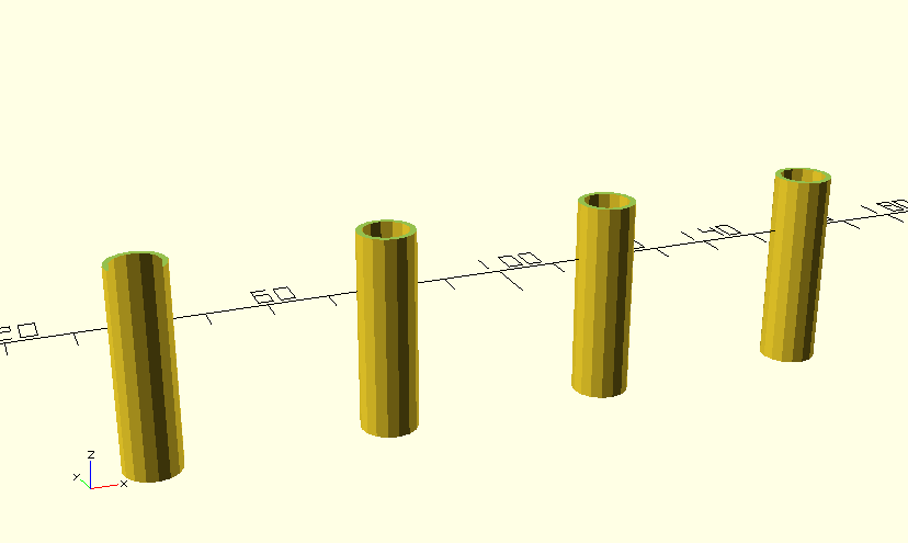

This is a distilled version of the code I was having a problem with:
for(c = [1:4])
translate([c * 40, 0])
difference () {
linear_extrude(height = 50, center = true, convexity = c)
circle(5);
circle(4);
         translate([0, 0, 20])
             cube(20, center = true);

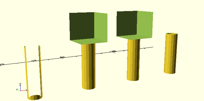

This is how it looks on my old laptop:
And this is how it looks on my normal desktop machine, which also has
Intel graphics but it never gives me problems. Goldfeather makes no
difference.
It seems 2 is sufficient on this machine but the old machine needs 4.

If it is simply the maximum number of edges a line can pass through then
I agree it should be 4 for a tube.

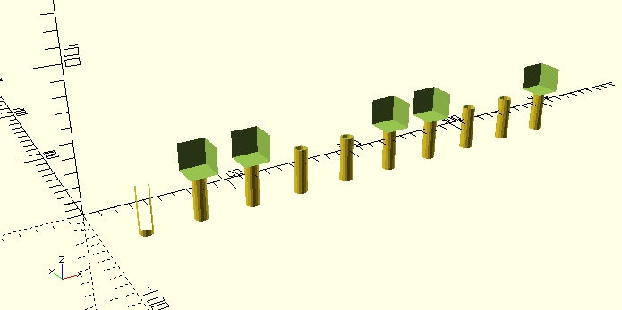

I found on my dodgy machine having convexity higher goes wrong again.
Here is it swept from 1 to 10
4, 5, 8 and 9 work.
The actual tube is correct for 2 onward, as it should be, but the back
faces of the subtrahend get displayed for some values of convexity. That
never happens on my good machine.
