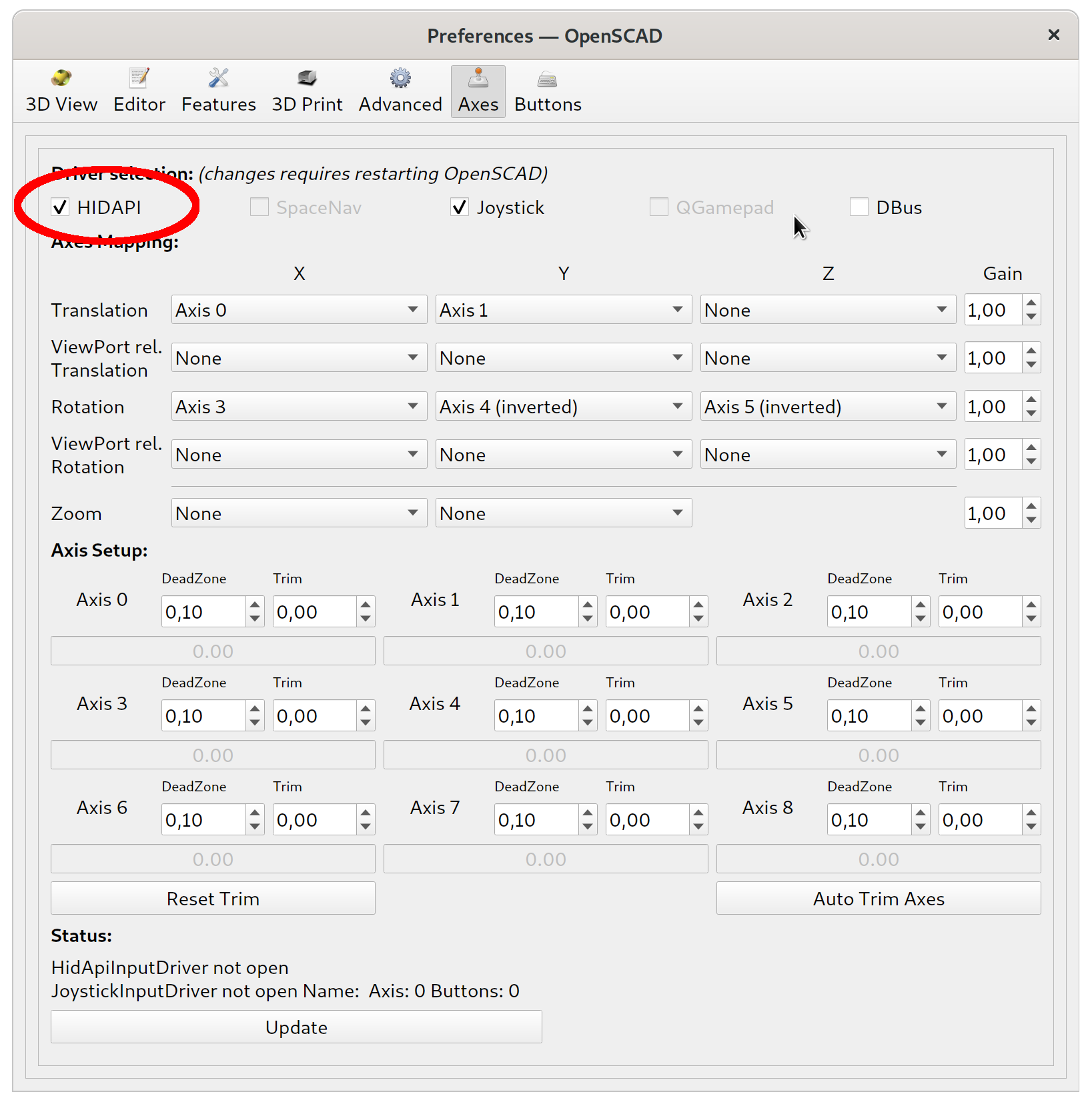

I'm playing with a SpaceNavigator.  When I go to Preferences, Axes, I
see a SpaceNav check box, but it is greyed out.  Any idea why that might be?

That means the SpaceNav driver (spacenavd, Linux only) was not
enabled at application build time.
Which platform are you on? If you don't need spacenavd for any
other program, I'd suggest trying the joystick driver first.

Right, then you need to enable the HIDAPI driver for support
of 3DConnexion Space Mouse devices (and restart OpenSCAD).
Note that the official 3DConnexion driver may or may not
interfere with OpenSCAD accessing the device. Unfortunately
it has a license I can't agree to, so I can't say much about
it, nor would it ever be possible for OpenSCAD to use it.

On 19.07.21 03:01, jon wrote:
I am confused.  Not sure how to "enable the HIDAPI driver" nor
whether I need to install special software.  I downloaded a
huge package from the manufacturer but have not yet installed
it.
See attached screenshot. This checkbox needs to be enabled.
No other driver is needed, OpenSCAD will directly use the USB
device (and so far only 3DConnexion USB devices are supported).
As Michael confirmed, the driver from 3DConnexion will grab
the device and make it impossible to use with OpenSCAD. So if
you did not need that up to now, there's no reason to install.

Mon, Jul 19, 2021 1:44 AM
Thanks!
Even with the HIDAPI box checked, and even after re-starting OpenSCAD,
the SpaceNav check box remains greyed out.

HIDAPI is the raw USB driver interface to the SpaceNav device.
The SpaceNav check-box is for Linux only. (maybe Mac?)
