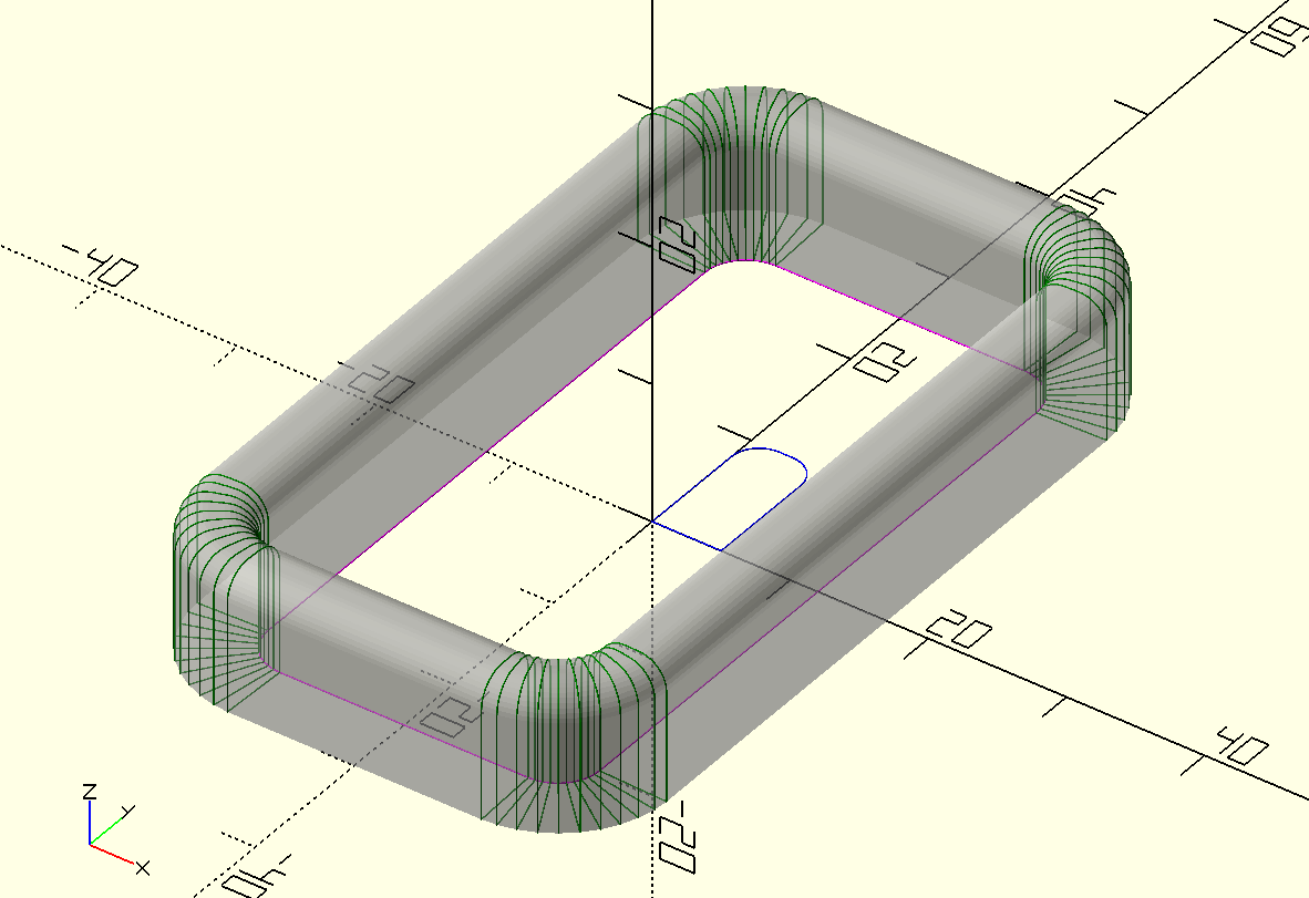

also missed to share that the skeleton of the path extrude method is
different from the offset method.
[image: Screenshot 2023-09-03 at 6.55.06 PM.png]

I think that Sanjeev has identified the two main approaches.  You can make
a rounded rectangle shape and sweep.  That would look like this:
include<BOSL2/std.scad>
$fa=1;$fs=1;
W=34;L=60;H=10;Or = 8;Ir = 3;
section = rect([Or-Ir,H], rounding=[2,2,0,0],anchor=BOT+LEFT);
path = rect([W,L],rounding=Ir);
path_sweep(section,path,closed=true);
Note that I have chosen as the sweep path the inner rounded rectangle
which avoids issues with self-intersection of the sweep.  This is probably
the best way to do this in terms of efficiency.  Note also that using
turtle() to compute a rounded rectangle is overkill.  I only use turtle()
for shapes that are somehow irregular.
Sanjeev's second approach is to use offsetting.  This is possible using
offset_sweep(), but will likely be slower than path_sweep() because
computing offset in userspace is slow.  To do this, you have to compute the
outside rounded shape and then subtract the inner rounded shape.  So it
could be done like this:
include<BOSL2/rounding.scad>
$fa=1;$fs=1;
inside = rect([W,L]-(Or-Ir)*[2,2], rounding=Ir);
outside = rect([W,L], rounding=Or);
offset_sweep(outside, h=H, top=os_circle(r=2));
down(1)offset_sweep(inside, h=H+1, top=os_circle(r=-2),extra=1);
Note that you could also compute just one of inside and outside directly
and get the other one with offset().
A third way to make a shape like this is to use rounded_prism(), again
with a difference.  However, rounded_prism doesn't make circular roundings,
so the results will be a bit different, and it will not be possible to
assure a uniform width at the corners.  (Roundovers here are continuous
curvature beziers.  The k parameter controls how gentle the transition,
with a value of .8 close to circular.  Smaller k values will give gentler
transitions, but then large joint distance may be desired.  Try changing k
to 0.5 to see the difference.)
$fa=1;$fs=1;
diff(){
rounded_prism(rect([W,L]),height=H, joint_top=2, joint_sides=8,k=.8)
up(.01)align(TOP,inside=true)rounded_prism(rect([W,L]-[5,5]),height=H+1,
joint_top=-2, joint_sides=6,k=.8);

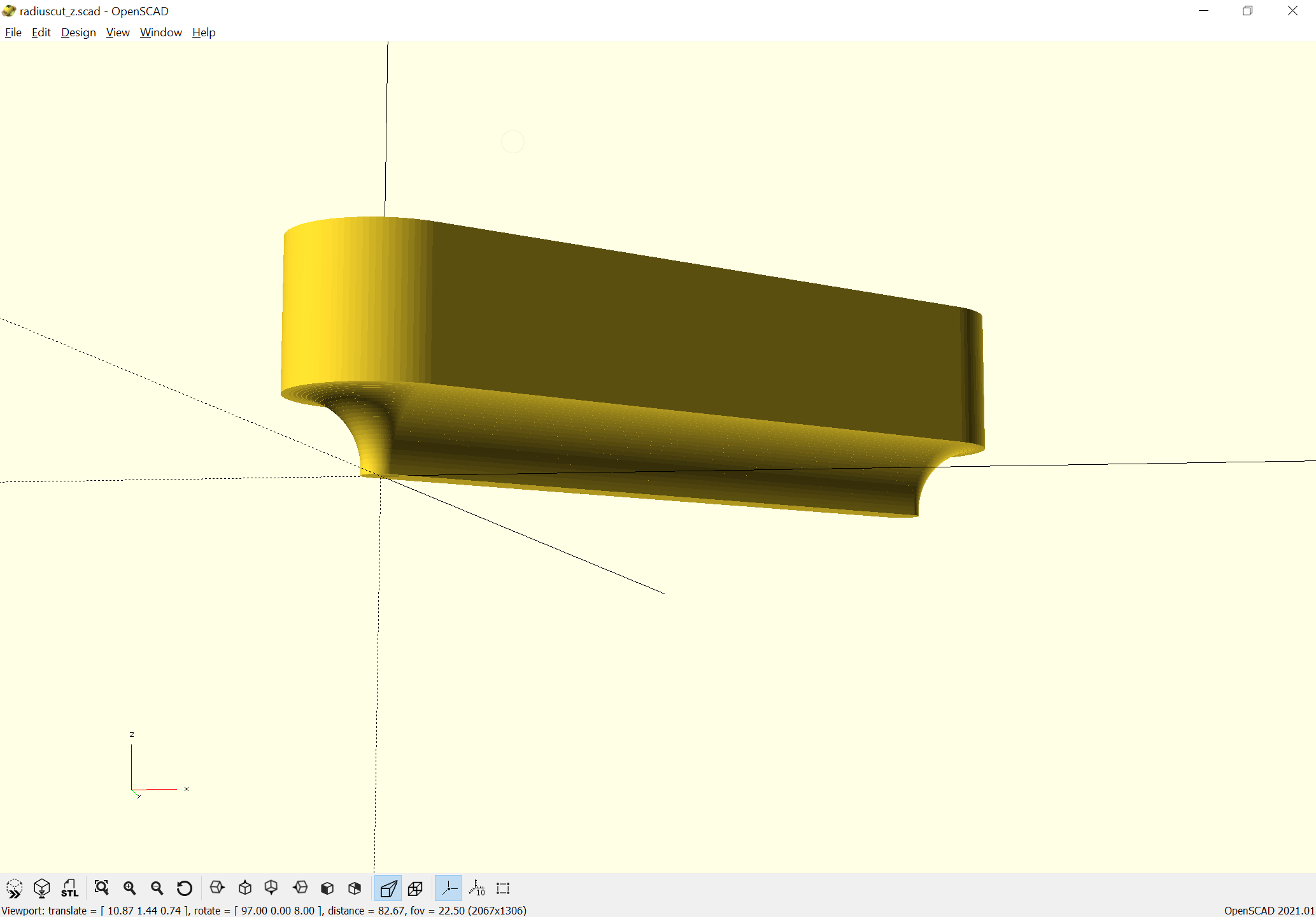

I actually managed to do this using the library I've been working on for mimicking G-code cutting on CNC machines:
Basically, you define a roundover tool:
https://community.carbide3d.com/t/using-unsupported-tooling-in-carbide-create-roundover-cove-radius-bits/43723
https://community.carbide3d.com/t/previewing-g-code-using-openscad/35153
    //!OpenSCAD
    Endmill_Diameter = 6.35;     Detail = 100;
    $fn = Detail * 1;
    tool_radius_tip = 0.79375;    tool_radius_width = 3.175;
    feedrate = 600;    plungerate = 150;    safeheight = 8;
    module radiuscut(bx, by, bz, ex, ey, ez) {    n = Detail;    step = 360/n;    endmillradius = Endmill_Diameter / 2;     hull(){    translate([bx,by,bz])    cylinder(step,tool_radius_tip,tool_radius_tip);    translate([ex,ey,ez])    cylinder(step,tool_radius_tip,tool_radius_tip);    }
    hull(){    translate([bx,by,bz+tool_radius_width]) cylinder(tool_radius_width2,tool_radius_tip+tool_radius_width,tool_radius_tip+tool_radius_width);        translate([ex,ey,ez+tool_radius_width])  cylinder(tool_radius_width2,tool_radius_tip+tool_radius_width,tool_radius_tip+tool_radius_wi dth);    }     for (i=[0:step:90]) {        angle = i;        dx = tool_radius_widthcos(angle);        dxx = tool_radius_widthcos(angle+step);        dzz = tool_radius_widthsin(angle);        dz = tool_radius_widthsin(angle+step);        dh = dz-dzz;        hull(){        translate([bx,by,bz+dz])           cylinder(dh,tool_radius_tip+tool_radius_width-dx,tool_radius_tip+tool_radius_width-dxx);        translate([ex,ey,ez+dz])           cylinder(dh,tool_radius_tip+tool_radius_width-dx,tool_radius_tip+tool_radius_width-dxx);            }    }    }
    radiuscut(0, 0, 0, 20, 20, 0);
which previews as:
https://community.carbide3d.com/uploads/default/original/3X/5/4/540b04fcd2dbfebb78c08a748ff980aa3238c8e2.png
and then you subtract that from the design which you are modeling.

Step 2, to calculate the intersection of segments is n log n via the Bentley-Ottmann (line sweep) algorithm, but it requires a priority queue and binary search tree, which is impossible in OpenSCAD. My implementation doesn't handle global intersections, but the step you write in 6 of "check if any point is inside these shapes" is also quadratic, at least when done naively. The algorithm I described vaguely above involving winding numbers is quite elegant, but I had three problems: 1. cannot work on a path with endpoints, 2. difficult to maintain association between vertices in original and offset polygon, and 3. not efficient in OpenSCAD. I implemented it and is probably more robust, but it was much slower than my existing method. Here's the paper on that algorithm: https://mcmains.me.berkeley.edu/pubs/DAC05OffsetPolygon.pdf In python I would think you could find libraries already written with efficient algorithms for this stuff. On Sun, Sep 3, 2023 at 10:14 AM Sanjeev Prabhakar <sprabhakar2006@gmail.com> wrote: > It is quadratic for sure. > > It needs a separate discussion as per me as this is a complex topic. > > If I remember correctly following are the steps > > 1. Original section is divided in to line segments. > > 2. Each line segment is offset by the amount required and intersection > between 2 adjacent segments are calculated. In case of concave segments > there would not be any intersection. > > 3. There could be global intersection of segments apart from the > intersection created in step 2. To calculate this it has to be quadratic. > > 4. All the points obtained in step 2 and step 3 to be added in simple > offset of all the original points. > > 5. create a rounded shape around each segment of the original section > such that the radius of the round is equal to offset required minus some > very small value like 0.001. > > 6. Now check if any point is inside these rounded shapes and discard it. > > Balance points needs to be ordered based on the original points . > > Now, this seems to be a complicated process, but I think this is the > simplest way to achieve a offset. > > > On Sun, 3 Sept, 2023, 7:18 pm Adrian Mariano, <avm4@cornell.edu> wrote: > >> Sanjeev, I don't know how you implemented offset, either in python or in >> OpenSCAD, but the problem I have is that checking for invalid portions of >> the path after doing the basic offset becomes a quadratic run time task in >> OpenSCAD. In other languages, it is possible to use clever data structures >> and I think do it in N log N. I saw an algorithm for offset that involves >> doing the basic offset and then keeping only the parts of the result that >> meet a criterion based on winding number, but the computation to partition >> the path into its regions and compute the winding number is very slow in >> OpenSCAD, again because without data structures, everything has at least >> quadratic run time. >> >> On Sun, Sep 3, 2023 at 9:32 AM Sanjeev Prabhakar < >> sprabhakar2006@gmail.com> wrote: >> >>> I have observed the offset function I wrote in openscad was much slower >>> than the offset function written in python. >>> >>> Maybe the numpy has a lot of support and is faster. So both the methods >>> seem to be almost equally efficient or inefficient, whatever way you want >>> to look at it. >>> >>> also missed to share that the skeleton of the path extrude method is >>> different from the offset method. >>> >>> [image: Screenshot 2023-09-03 at 6.55.06 PM.png] >>> >>> On Sun, 3 Sept 2023 at 18:29, Adrian Mariano <avm4@cornell.edu> wrote: >>> >>>> I think that Sanjeev has identified the two main approaches. You can >>>> make a rounded rectangle shape and sweep. That would look like this: >>>> >>>> include<BOSL2/std.scad> >>>> >>>> $fa=1;$fs=1; >>>> W=34;L=60;H=10;Or = 8;Ir = 3; >>>> >>>> section = rect([Or-Ir,H], rounding=[2,2,0,0],anchor=BOT+LEFT); >>>> path = rect([W,L],rounding=Ir); >>>> path_sweep(section,path,closed=true); >>>> >>>> Note that I have chosen as the sweep path the inner rounded rectangle >>>> which avoids issues with self-intersection of the sweep. This is probably >>>> the best way to do this in terms of efficiency. Note also that using >>>> turtle() to compute a rounded rectangle is overkill. I only use turtle() >>>> for shapes that are somehow irregular. >>>> >>>> Sanjeev's second approach is to use offsetting. This is possible using >>>> offset_sweep(), but will likely be slower than path_sweep() because >>>> computing offset in userspace is slow. To do this, you have to compute the >>>> outside rounded shape and then subtract the inner rounded shape. So it >>>> could be done like this: >>>> >>>> include<BOSL2/std.scad> >>>> include<BOSL2/rounding.scad> >>>> >>>> $fa=1;$fs=1; >>>> W=34;L=60;H=10;Or = 8;Ir = 3; >>>> >>>> inside = rect([W,L]-(Or-Ir)*[2,2], rounding=Ir); >>>> outside = rect([W,L], rounding=Or); >>>> >>>> difference(){ >>>> offset_sweep(outside, h=H, top=os_circle(r=2)); >>>> down(1)offset_sweep(inside, h=H+1, top=os_circle(r=-2),extra=1); >>>> } >>>> >>>> Note that you could also compute just one of inside and outside >>>> directly and get the other one with offset(). >>>> >>>> A third way to make a shape like this is to use rounded_prism(), again >>>> with a difference. However, rounded_prism doesn't make circular roundings, >>>> so the results will be a bit different, and it will not be possible to >>>> assure a uniform width at the corners. (Roundovers here are continuous >>>> curvature beziers. The k parameter controls how gentle the transition, >>>> with a value of .8 close to circular. Smaller k values will give gentler >>>> transitions, but then large joint distance may be desired. Try changing k >>>> to 0.5 to see the difference.) >>>> >>>> include<BOSL2/std.scad> >>>> include<BOSL2/rounding.scad> >>>> >>>> $fa=1;$fs=1; >>>> W=34;L=60;H=10;Or = 8;Ir = 3; >>>> >>>> diff(){ >>>> rounded_prism(rect([W,L]),height=H, joint_top=2, joint_sides=8,k=.8) >>>> >>>> up(.01)align(TOP,inside=true)rounded_prism(rect([W,L]-[5,5]),height=H+1, >>>> joint_top=-2, joint_sides=6,k=.8); >>>> } >>>> >>>> >>>> On Sun, Sep 3, 2023 at 7:18 AM Sanjeev Prabhakar < >>>> sprabhakar2006@gmail.com> wrote: >>>> >>>>> I will explain the process >>>>> I think this is important. >>>>> >>>>> There are 2 approaches. >>>>> 1. Extrude a section along a path >>>>> 2. Make a section and offset it multiple times to generate a solid. >>>>> >>>>> I am sure this explanation is not enough. Will create a visual >>>>> description and send it to you. >>>>> >>>>> For approach 2: >>>>> The key is writing a function to offset a section, which I think is >>>>> not so easy. >>>>> >>>>> >>>>> >>>>> >>>>> On Sun, 3 Sept, 2023, 4:32 pm Bob Roos, <roosbob@wybatap.com> wrote: >>>>> >>>>>> Hi Sanjeev, >>>>>> >>>>>> >>>>>> Thank you. It's beautiful, but how did you generate all those points?? >>>>>> >>>>>> >>>>>> I had to hollow out the part a bit and change the shape some so I >>>>>> would like to find a more generic way to round the edges. >>>>>> >>>>>> >>>>>> >>>>>> Bob >>>>>> >>>>>> >>>>>> >>>>>> Sunday, September 3, 2023, 6:17:54 AM, you wrote: >>>>>> >>>>>> attached file >>>>>> [image: Screenshot 2023-09-03 at 3.45.43 PM.png] >>>>>> >>>>>> >>>>>> >>>>>> On Sun, 3 Sept 2023 at 06:50, Bob Roos <roosbob@wybatap.com> wrote: >>>>>> >>>>>>> Hello OpenSCAD, >>>>>>> >>>>>>> I want the bottom to be straight and the top inside and outside >>>>>>> edges to have 2mm roundover >>>>>>> >>>>>>> Thank you. >>>>>>> >>>>>>> include <BOSL2/std.scad> //or screws or threading >>>>>>> >>>>>>> W=34; >>>>>>> L=60; >>>>>>> H=10; >>>>>>> Or = 8; >>>>>>> Ir = 3; >>>>>>> >>>>>>> rect_tube(size=[W,L], wall=5, rounding=Or, h=H,irounding=3); >>>>>>> >>>>>>> -- >>>>>>> Best regards, >>>>>>> Bob mailto:roosbob@wybatap.com >>>>>>> _______________________________________________ >>>>>>> OpenSCAD mailing list >>>>>>> To unsubscribe send an email to discuss-leave@lists.openscad.org >>>>>>> >>>>>> >>>>>> -- >>>>>> have Fun, >>>>>> Bob mailto:roosbob@wybatap.com >>>>>> <roosbob@wybatap.com> >>>>>> _______________________________________________ >>>>>> OpenSCAD mailing list >>>>>> To unsubscribe send an email to discuss-leave@lists.openscad.org >>>>>> >>>>> _______________________________________________ >>>>> OpenSCAD mailing list >>>>> To unsubscribe send an email to discuss-leave@lists.openscad.org >>>>> >>>> _______________________________________________ >>>> OpenSCAD mailing list >>>> To unsubscribe send an email to discuss-leave@lists.openscad.org >>>> >>> _______________________________________________ >>> OpenSCAD mailing list >>> To unsubscribe send an email to discuss-leave@lists.openscad.org >>> >> _______________________________________________ >> OpenSCAD mailing list >> To unsubscribe send an email to discuss-leave@lists.openscad.org >> > _______________________________________________ > OpenSCAD mailing list > To unsubscribe send an email to discuss-leave@lists.openscad.org >
Sun, Sep 3, 2023 11:44 PM
attached is the offset function calculation steps.
this works fairly well in most of the cases
$fa=1;$fs=1;
using offset_sweep(), but will likely be slower than path_sweep() because

very slow in OpenSCAD, again because without data structures, everything
has at least quadratic run time.
slower than the offset function written in python.
methods seem to be almost equally efficient or inefficient, whatever way
you want to look at it.
On Sun, 3 Sept 2023 at 18:29, Adrian Mariano avm4@cornell.edu
can make a rounded rectangle shape and sweep.  That would look like this:
$fa=1;$fs=1;
rectangle which avoids issues with self-intersection of the sweep.  This is
probably the best way to do this in terms of efficiency.  Note also that
using turtle() to compute a rounded rectangle is overkill.  I only use
turtle() for shapes that are somehow irregular.
$fa=1;$fs=1;
again with a difference.  However, rounded_prism doesn't make circular
roundings, so the results will be a bit different, and it will not be
possible to assure a uniform width at the corners.  (Roundovers here are
continuous curvature beziers.  The k parameter controls how gentle the
transition, with a value of .8 close to circular.  Smaller k values will
give gentler transitions, but then large joint distance may be desired.
Try changing k to 0.5 to see the difference.)
$fa=1;$fs=1;
$fa=1;$fs=1;
$fa=1;$fs=1;
diff(){
joint_sides=8,k=.8)
is different from the offset method.
