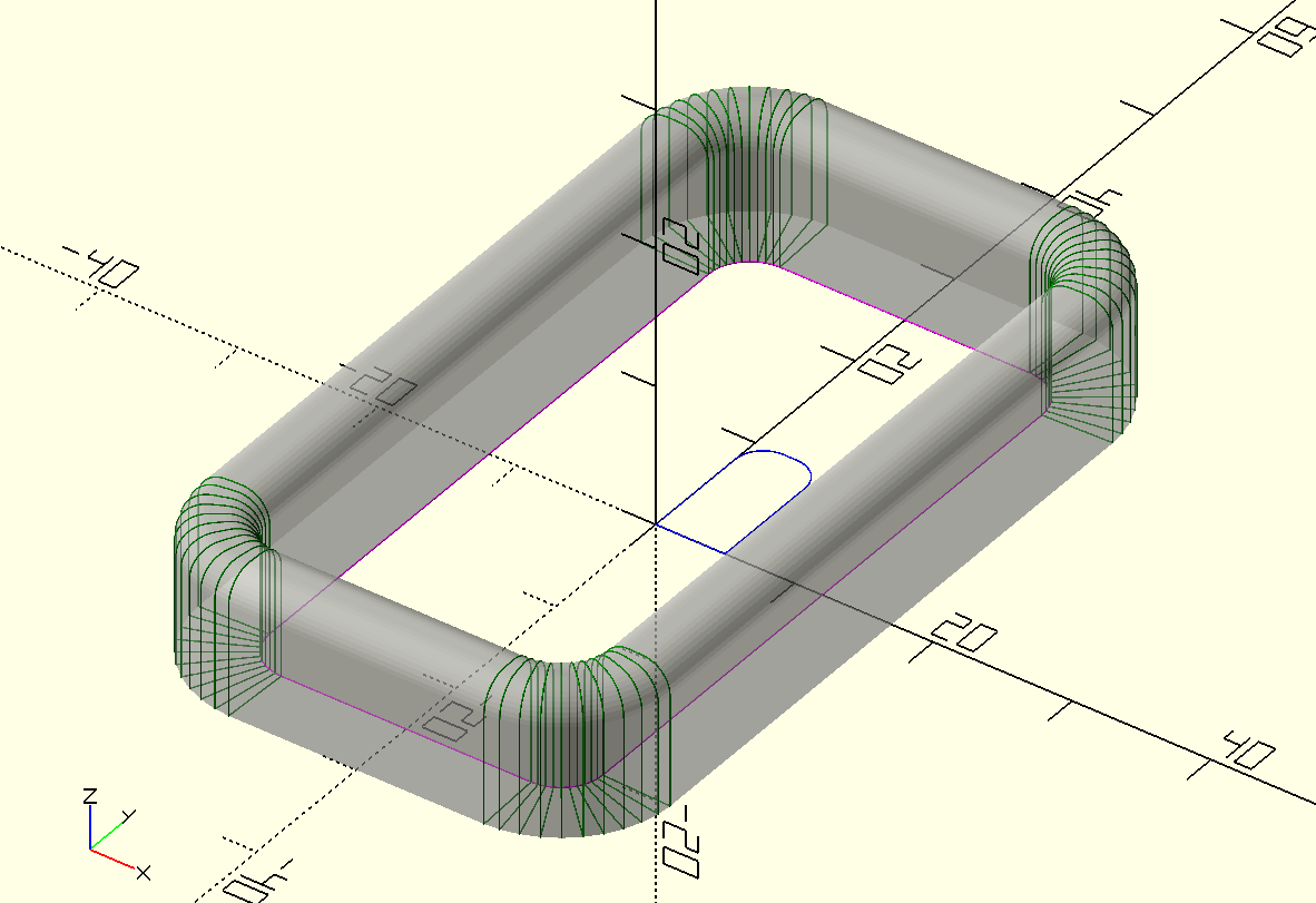

I think that Sanjeev has identified the two main approaches.  You
can make a rounded rectangle shape and sweep.  That would look like this:
include<BOSL2/std.scad>
$fa=1;$fs=1;
W=34;L=60;H=10;Or = 8;Ir = 3;
section = rect([Or-Ir,H], rounding=[2,2,0,0],anchor=BOT+LEFT);
path = rect([W,L],rounding=Ir);
path_sweep(section,path,closed=true);
Note that I have chosen as the sweep path the inner rounded
rectangle which avoids issues with self-intersection of the sweep.  This is
probably the best way to do this in terms of efficiency.  Note also that
using turtle() to compute a rounded rectangle is overkill.  I only use
turtle() for shapes that are somehow irregular.
Sanjeev's second approach is to use offsetting.  This is possible
using offset_sweep(), but will likely be slower than path_sweep() because
computing offset in userspace is slow.  To do this, you have to compute the
outside rounded shape and then subtract the inner rounded shape.  So it
could be done like this:
include<BOSL2/rounding.scad>
$fa=1;$fs=1;
inside = rect([W,L]-(Or-Ir)*[2,2], rounding=Ir);
outside = rect([W,L], rounding=Or);
offset_sweep(outside, h=H, top=os_circle(r=2));
down(1)offset_sweep(inside, h=H+1,
top=os_circle(r=-2),extra=1);
Note that you could also compute just one of inside and outside
directly and get the other one with offset().
A third way to make a shape like this is to use rounded_prism(),
again with a difference.  However, rounded_prism doesn't make circular
roundings, so the results will be a bit different, and it will not be
possible to assure a uniform width at the corners.  (Roundovers here are
continuous curvature beziers.  The k parameter controls how gentle the
transition, with a value of .8 close to circular.  Smaller k values will
give gentler transitions, but then large joint distance may be desired.
Try changing k to 0.5 to see the difference.)
$fa=1;$fs=1;
diff(){
rounded_prism(rect([W,L]),height=H, joint_top=2,
joint_sides=8,k=.8)
up(.01)align(TOP,inside=true)rounded_prism(rect([W,L]-[5,5]),height=H+1,
joint_top=-2, joint_sides=6,k=.8);

also missed to share that the skeleton of the path extrude method
is different from the offset method.
[image: Screenshot 2023-09-03 at 6.55.06 PM.png]
On Sun, 3 Sept 2023 at 18:29, Adrian Mariano avm4@cornell.edu
You can make a rounded rectangle shape and sweep.  That would look like
this:
$fa=1;$fs=1;
possible using offset_sweep(), but will likely be slower than path_sweep()
because computing offset in userspace is slow.  To do this, you have to
compute the outside rounded shape and then subtract the inner rounded
shape.  So it could be done like this:
$fa=1;$fs=1;
$fa=1;$fs=1;
diff(){
joint_sides=8,k=.8)
method is different from the offset method.
this:
$fa=1;$fs=1;
$fa=1;$fs=1;
rounded_prism(), again with a difference.  However, rounded_prism doesn't
make circular roundings, so the results will be a bit different, and it
will not be possible to assure a uniform width at the corners.  (Roundovers
here are continuous curvature beziers.  The k parameter controls how gentle
the transition, with a value of .8 close to circular.  Smaller k values
will give gentler transitions, but then large joint distance may be
desired.  Try changing k to 0.5 to see the difference.)
this:
$fa=1;$fs=1;
this:
$fa=1;$fs=1;
$fa=1;$fs=1;
outside directly and get the other one with offset().
$fa=1;$fs=1;
diff(){
joint_sides=8,k=.8)
