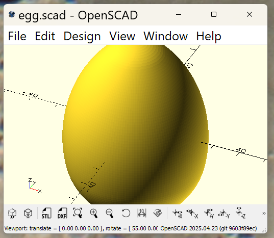

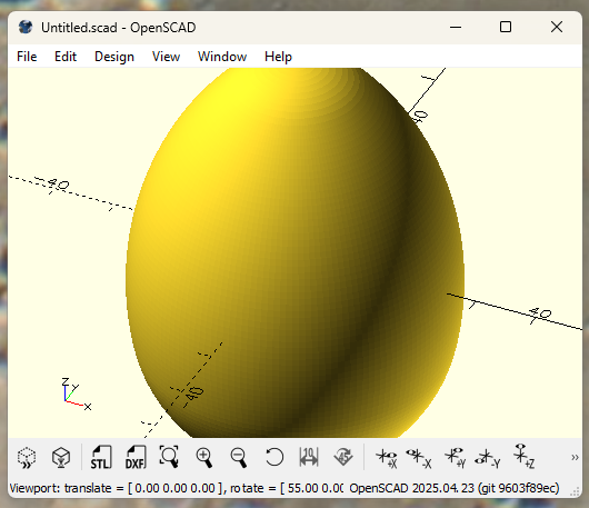

On Windows, there seem to be two different "size" settings.  One is
per-monitor, and is on Settings > System > Display > Scale, and the
other is global is on Settings > Accessibility > Text size.
With the Accessibility setting set to 100%:
With the Accessibility setting set to 200%:
Note that some of the elements changed, but others didn't.
(Hmm, looks like a bug that sometimes the window title isn't updated.)
Some applications appear to scale all of their elements, while others do
not.  Some applications respond to changes immediately (sometimes
partially!), while for some it's necessary to restart the application.

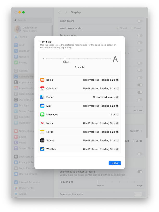

Here's a screenshot from the most recent version of macOS:
[image: Screenshot 2025-04-26 at 12.52.55 PM.png]
