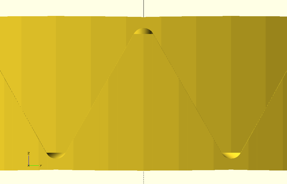

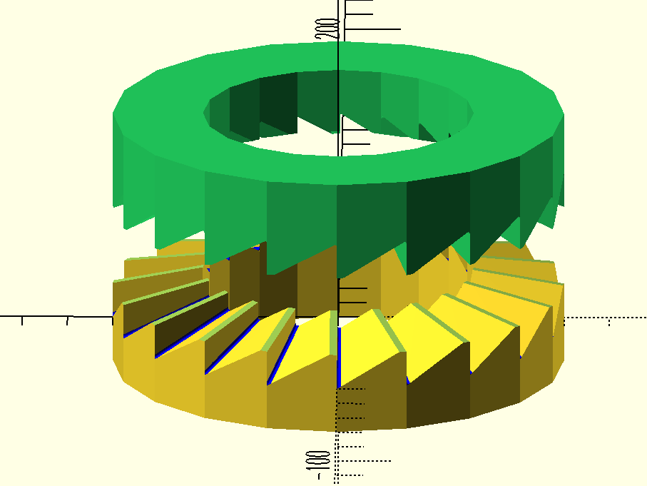

There was a little issue in the previous code i sent:
here is the corrected one:
from openscad2 import *
hirth coupling
n=20 # number of teeths
ta=60 # teeth angle
ca=10 # for straight 360/42.232 # cone angle
i_r=30 # inner radius
o_r=100 # outer radius
ch=.5 # chamfer height
l1=[[i_r,0],[o_r,0]]
l2=[ q_rot([f'z{i}'],l1)  for i in linspace(0,360,n+1)[:-1]]
l3=axis_rot_1(l1,ax1=[0,1,0],loc1=[o_r,0],theta=ca)
l3= line2length(flip(line2length(l3,(o_r-i_r)+5)),(o_r-i_r)+10)
cone1=[ q_rot([f'z{i}'],l3) for i in linspace(0,360,n)]
l2=psos(cone1,l2,[0,0,1])
l1=[l2[0][0],l2[1][0]]
d1=l_len(l1)/2/cos(d2r(ta))
l1=axis_rot_1(l1,line_as_axis(l2[0]),l2[0][0],ta)
l1=line2length(l1,d1)
l3=[l2[0][1],l2[1][1]]
d2=l_len(l3)/2/cos(d2r(ta))
l3=axis_rot_1(l3,line_as_axis(l2[0]),l2[0][1],ta)
l3=line2length(l3,d2)
l4=[l1[1],l3[1]]
a,b=l4
l4=line2length(flip(line2length(l4,(o_r-i_r)+5)),(o_r-i_r)+10)
cone2=[ q_rot([f'z{i}'],l4) for i in linspace(0,360,n)]
l3=psos(cone2,l2,[0,0,1])
l3=q_rot([f'z{360/n/2}'],l3)
s1=l_(a_([l2,l3]).transpose(1,0,2,3).reshape(n*2,2,3))
s1=s1+[s1[0]]
s1=l_(a_(s1).transpose(1,0,2))
sol1=flip(surf_base(s1,s1[0][1][2]+10))
s2=l_(a_(cone1).transpose(1,0,2))
s2=surface_offset(s2,-ch)
sol2=surf_base(s2,s1[1][0][2]-10)
sol2=sol2+[sol2[0]]
sol3=surf_base(flip(s1),s1[1][0][2]-10)
s3=q_rot(['z5'],l_(a_(cone2[:-1]).transpose(1,0,2)))
s3=surface_offset(s3,ch)
sol4=surf_base(s3,s1[0][1][2]+10)
sol4=sol4+[sol4[0]]
f.write(f'''
 translate([0,0,25])
// color([.13,.81,.37])
 difference(){{
 {swp_c(sol1)}
 {swp_c(sol2)}
difference(){{
{swp_c(sol3)}
{swp_c(sol4)}

Unfortunately, you cannot raise the cone by _conic  + _chamferHeight. The chamfer must (should?) radiate from the “origin” just like the ridge and grooves. I believe your code as written takes a constant chamfer off the teeth, but at the inner radius, that’s too much.
Indeed, I missed that subtlety. Sorry.  Your fix looks right.

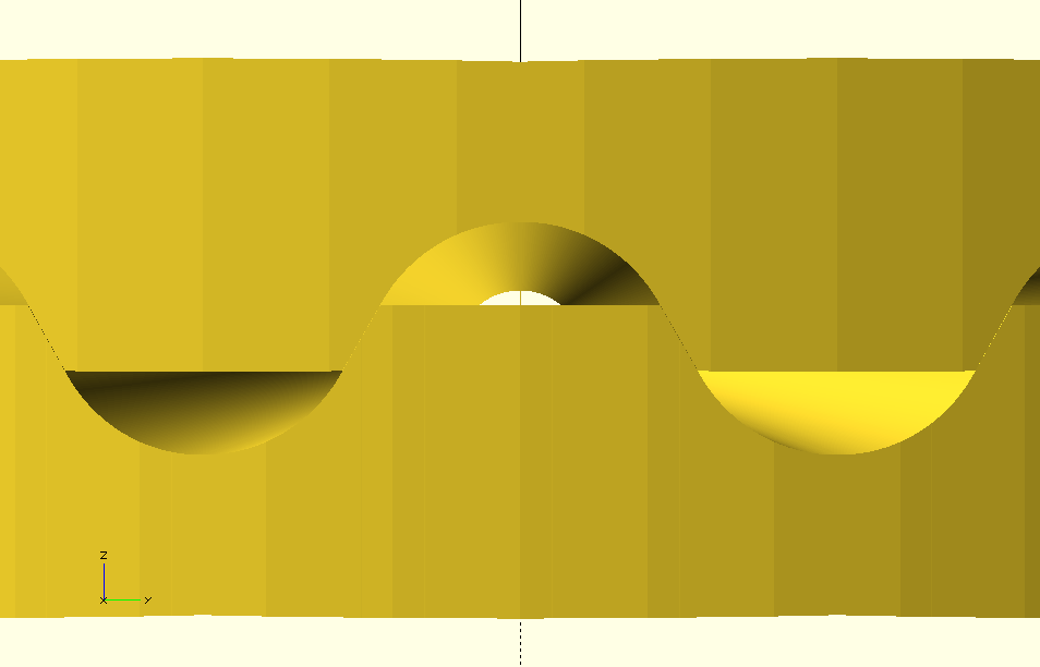

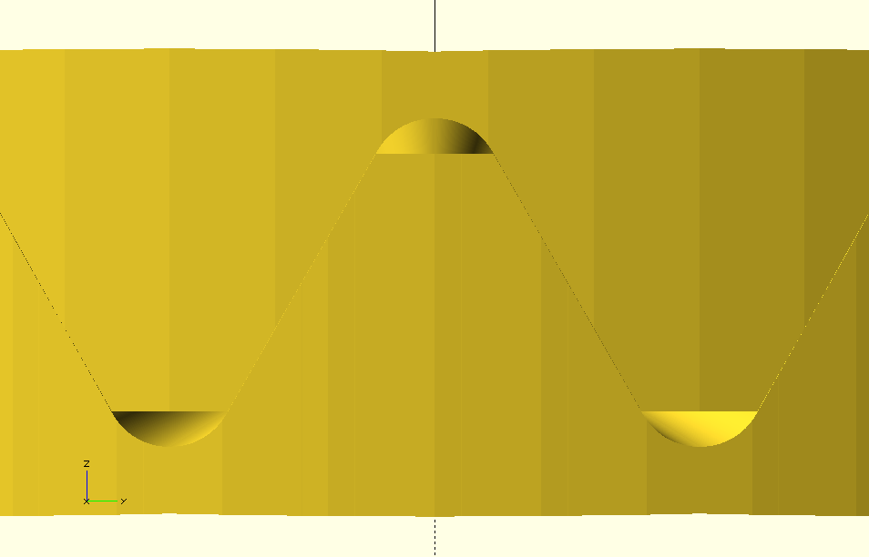

There seemed to be a negative gap between the two halves, i.e. the splines overlapped slightly.
I also noticed small gaps around the top and bottom edges where the joint halves are supposed to meet the filler-cones and realised that was because the concave side of the joint halves was not conical but polyhedral, made up of the flat undersides of n splines. So the circular cones didn’t fit the joint halves properly. So I replaced the cones with polyhedral cones for a better fit, which eliminated the gaps.
At the same time, the two halves of the joint now fit together properly with zero overlap! What does that have to do with the cones?
Talk about swatting two flies with one stroke! (Let’s not throw stones at birds)

Really wierd!
birds)
