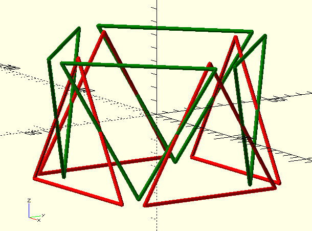

Here's a bit on the subtlety of the Hirth joint.  I thought (like many
others, I suspect) that you could just create a triangle, stand it up
vertically, center it and scale it in the direction of the origin to create
the joint.  But if you do this, you run into issues with mating between the
two halves of the joint that are quite obvious if the tooth count is low.
In order for the joints to mate, they have to touch at their half-way
points (which are on the XY plane in this construction).  That constrains
the size of the triangle based on the other joint parameters.  But if you
form the simple construction I described, you get these triangles, where
red is the bottom part and green is the top part.  They are touching at the
triangle midles, but nowhere else.  And furthermore, the triangles for one
joint don't meet at their corners!

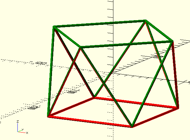

To solve this problem, you need to rotate the triangle bottoms inward until
their vertices meet.  That produces this set of triangles:
From here you can sweep the triangles toward the origin to make the joint.
But it's not in the direction of the normal to the triangle, since the
triangle bottoms were shifted inward by the rotation.    The more teeth
you add, the smaller this effect becomes.  It depends on how close to 2 you
get with the ratio of tan(180/n) to tan(90/n).  So for large numbers of
teeth it doesn't make much difference.
Note also that Sanjeev posted a case with an asymmetric tooth shape.  I
don't know how to do the general case, but if you have a right triangle
like he showed, then it appears that everything will work with
appropriately scaled vertically positioned triangles---no funny tilt
required.

Here's a bit on the subtlety of the Hirth joint. I thought (like many others, I suspect) that you could just create a triangle, stand it up vertically, center it and scale it in the direction of the origin to create the joint. But if you do this, you run into issues with mating between the two halves of the joint that are quite obvious if the tooth count is low. In order for the joints to mate, they have to touch at their half-way points (which are on the XY plane in this construction). That constrains the size of the triangle based on the other joint parameters. But if you form the simple construction I described, you get these triangles, where red is the bottom part and green is the top part. They are touching at the triangle midles, but nowhere else. And furthermore, the triangles for one joint don't meet at their corners! [image: image.png] To solve this problem, you need to rotate the triangle bottoms inward until their vertices meet. That produces this set of triangles: [image: image.png] From here you can sweep the triangles toward the origin to make the joint. But it's not in the direction of the normal to the triangle, since the triangle bottoms were shifted inward by the rotation. The more teeth you add, the smaller this effect becomes. It depends on how close to 2 you get with the ratio of tan(180/n) to tan(90/n). So for large numbers of teeth it doesn't make much difference. Note also that Sanjeev posted a case with an asymmetric tooth shape. I don't know how to do the general case, but if you have a right triangle like he showed, then it appears that everything will work with appropriately scaled vertically positioned triangles---no funny tilt required. On Sat, Nov 2, 2024 at 9:38 AM Adrian Mariano <avm4@cornell.edu> wrote: > Ray, I tried out your code and ran into numerous problems. It is super > slow to preview. You don't give a convexity argument so stuff is missing > in preview. Render fails with a bunch of errors, perhaps due to the > reversed faces. So I can't really look at the shape very well. I tried > setting the tooth count to 5 and it gets really weird. My suspicion is > that you fell into the same trap that I did in not recognizing the subtlety > of the face spline design, but I can't be certain.... Or maybe you don't > care if it fits accurately--could be that the modeling errors in question > aren't a major source of error at high tooth count. Note that EVEN the > case of two symmetric parts is rather tricky to get right. I didn't > realize this at first. A fully correct implementation will let someone > make a 5 tooth design that could be used to set a mechanism at fifth of a > circle angles, for example. > > With regards to terminology, my main reason for asking the question about > other face splines is that I'd call this module in BOSL2 face_spline(), > except that if there are 4 other kinds of face spline then that could be > confusing, in which case perhaps it should be hirth() which is more > obscure. > > On Thu, Oct 31, 2024 at 8:01 PM Raymond West via Discuss < > discuss@lists.openscad.org> wrote: > >> Hi Bob, >> >> Here's the basic code for a parametric Hirth Joint. Spring loaded often >> use as a slip clutch in torque sensitive situations, e.g screw drivers, >> tapping heads, etc. Larger scale high speed turbines for shaft >> connections, since easy to balance, no windage, etc. I've tested as >> saving as stl, and re-importing, gives no errors. Easy enough to cut out >> the centre teeth if you don't want them. >> >> // clutch.scad >> >> ind= 50; // overall diameter >> num= 20; // number of teeth >> back = 6; //thickness of back >> //////////////////////////////////////////// >> >> >> diam= ind/cos (180/num); // bigger to allow for chords >> chord = diam*sin(180/num); >> >> ridge= chord *sqrt(3)/3; // or set to whatever (denominator = 2 for 60 >> degrees.) >> >> points=[ >> [0,0,ridge/2], >> [diam/2,-chord/2,0], >> [diam/2,+chord/2,0], >> [diam/2,0,ridge] >> ]; >> faces=[ >> [0,1,2], >> [0,1,3], >> [0,2,3], >> [1,2,3] >> ]; >> >> module wedge(){ >> polyhedron(points,faces,convexity=10); >> } >> >> //rotate wedge >> >> intersection(){ >> translate([0,0,-back]) >> cylinder(d=ind,h=200,$fn=100); >> union(){ >> for (j=[0:1:+1+360/num]) >> rotate([0,0,j*360/num+0.5*360/num]) wedge(); >> cylinder(d1=diam,d2=0,h=ridge/2,$fn=num); >> translate([0,0,-back]) >> cylinder(d=diam,h=back,$fn=num); >> } >> } >> >> //save as stl, then import to check for valid stl. (remove comments >> below and run again) >> >> /* >> translate([0,0,6]) >> rotate([0,180,360/(num*2)]) >> import("P:/Docs/openscad/clutch.stl"); >> */ >> >> >> On 26/10/2024 00:44, Bob Carlson via Discuss wrote: >> > I got really intrigued by the Hirth joint and have been working a >> library entry that would generate them. I have it fully working, >> apparently, because it renders perfectly as far as I can see. However when >> I load one of the parts (a concave part) into PrusaSlicer, it reports >> thousands of errors that it supposedly fixed. The visual rendering is fine, >> but when you look at the slice it is completely screwed up. >> > >> > First some explanation. When I looked up hirth joints I only saw flat >> ones mentioned. The one I have actually encountered though is a conical >> one. There is a concave part and a convex part. They fit together >> perfectly. I had to invent some terminology since I did not find terms for >> some things I found to be important. The outer center line is the plane >> that passes through the midpoint of the teeth at the outer radius. In a >> flat hirth joint all the teeth radiate from the center of this circle, call >> it the origin. If the origin of the teeth is above the outer center line, >> then joint has a conical shape and the two parts are concave and convex. >> > >> > Each tooth at every point has the same profile, the top of the tooth >> profile is either 60 or 90 degrees. The groove angle is the angle that the >> groove forms from the origin to the outer radius. It will pass below (for a >> convex part) the outer radius. It’s critical for making hirth joints >> because it forms the tool path. The ridge angle is the angle formed by the >> corresponding ridge. >> > >> > If the joint is conical, then there is an inner center line that passes >> through the center of the teeth at the inner radius. The tooth height is >> the critical number to calculate. It is dependent on the number of teeth, >> the profile angle and the inner and out radii. Something that really >> complicates the mental gymnastics is that the tooth height is smaller at >> the inner radius. My code adds a “base” of extra material at the bottom of >> the convex part and the top of the concave part. What’s tricky is >> positioning the base of the concave part relative to the inner center line. >> The concave parts base is relatively easy to place because it depends on >> the outer radius and center line. >> > >> > I generate the raw teeth using the groove and ridge angles and >> spherical coordinates to make two 2d tooth profiles. Then I complete a >> tooth using skin(). A for loop generates the full set of N teeth. Then >> intersection or difference is used the trim the teeth at the inner and >> outer radii. I discovered something at that point, but solved it pretty >> simply. When diffing a cylinder from the N teeth, each tooth took up a >> small portion of the cylinder being diffed out. I had to raise the $fn on >> the cylinder or tube being used so that I got enough points in each tooth >> that diff or intersection was accurate. I kept raising it until the results >> stopped improving. I ended up with the 16*360 you see in the code. >> > >> > After I have the raw teeth, I generate a cone that is diffed away to >> produce the chamfer at the top of the teeth. Then I add in the base. The >> base also adds the “chamfer” at the bottom of the groove. It’s half the >> size of the top chamfer to leave a little gap when the parts are joined. >> > >> > When I comment out the everything but the raw teeth and import the STL >> into PrusaSlicer, it reports errors fixed, but appears to slice correctly >> when supports are added. >> > >> > When I add the intersection to trim the raw teeth, the number of >> reported errors goes way up. >> > >> > When I add the diff to remove the chamfer, the number goes way up again. >> > >> > When I add in the base, the number goes up again and it starts >> reporting many open edges. >> > >> > Throughout, OpenSCAD reports no errors. Using $fn at 16*360, manifold >> renders in 4+ seconds. At 32*360, it’s 53+ seconds. I did check CSG and it >> did not help. >> > >> > Maybe the biggest hint is that the convex part uses almost identical >> code, but produces no errors. Very weird. >> > >> > So, is this an OpenSCAD problem? Or something in my code? >> > >> > It’s also possible that my math is off somewhere. My formal trig >> training was 60 years ago. However I doubt a math error is responsible for >> the slicing problem and STL errors. >> > >> > -Bob >> > >> > >> > include <BOSL2/std.scad> >> > include <BOSL2/structs.scad> >> > >> > // Number of Teeth >> > _n = 36; // Number Of Teeth >> > >> > // Inner Radius >> > _ir = 30; >> > // Outer Radius >> > _or = 50; >> > // Is the coupling conical? >> > _conic = 10; >> > // Tooth Profile Angle >> > _profile = 60; // [60, 90] >> > // Percentage of tooth height >> > _chamfer = 5; // Default 5% >> > _base = 1; >> > >> > $fn = 180; >> > tiny = 1 / 1024; >> > >> > hirth_concave(); >> > >> > _irRatio = _ir / _or; >> > _toothAngle = 360/_n; >> > _toothHeight = (sin(_toothAngle/2) * _or) / tan(_profile/2); >> > _chamferHeight = _chamfer * _toothHeight / 100; >> > _grooveAngle = atan(((_toothHeight/2) + _conic) / _or); >> > _ridgeAngle = -atan(((_toothHeight/2) - _conic) / _or); >> > _innerCenterLine = (1 - _irRatio) * _conic; >> > _stackHeight = _innerCenterLine + _toothHeight + 2*_base; >> > _tubeHeight = 2*_conic + 2*_base + 2*_toothHeight; >> > >> > module hirth_concave() { >> > zrot(_toothAngle/2) >> > union() { >> > difference() { >> > intersection() { >> > union() { >> > for (i = [0 : 360/_n : 359]) >> > zrot(i) >> > _profileF(); >> > } >> > tube(ir = _ir, or = _or, anchor = CENTER, l = >> _tubeHeight, orient = UP, $fn = 16*360); >> > } >> > _chamferF(); >> > zcyl(r = _ir, h = _tubeHeight, $fn = 16*360, anchor = >> CENTER); >> > } >> > _baseF(); >> > } >> > } // hirth_concave >> > >> > module _profileF() { >> > IR = _ir * .5; >> > OR = _or * 1.5; >> > tI = [spherical_to_xyz(IR, 0, _grooveAngle + 90), >> > spherical_to_xyz(IR, _toothAngle/2, _ridgeAngle + 90), >> > spherical_to_xyz(IR, -_toothAngle/2, _ridgeAngle + 90)]; >> > >> > tO = [spherical_to_xyz(OR, 0, _grooveAngle + 90), >> > spherical_to_xyz(OR, _toothAngle/2, _ridgeAngle + 90), >> > spherical_to_xyz(OR, -_toothAngle/2, _ridgeAngle + 90)]; >> > up(_conic) >> > skin([tI, tO], slices = 0); >> > } >> > >> > >> > module _chamferF() { >> > A = -_toothHeight/2 - .1; >> > B = -_toothHeight/2 + _chamferHeight; >> > >> > pts = [[0, _conic], >> > [_or+tiny, A], >> > [_or+tiny, B]]; >> > >> > rotate_extrude(angle = 360, $fn = 16*360) >> > polygon(pts); >> > } >> > >> > module _baseF() { >> > A = _base + _irRatio*_toothHeight/2 + _innerCenterLine; >> > B = _irRatio * (_toothHeight/2 - _chamferHeight/2) + >> _innerCenterLine; >> > C = _toothHeight/2 - _chamferHeight/2; >> > pts = [ >> > [_ir, A], >> > [_ir, B], >> > [_or, C], >> > [_or, A] >> > ]; >> > >> > rotate_extrude(angle = 360, $fn = 360*16) >> > polygon(pts); >> > } >> > _______________________________________________ >> > OpenSCAD mailing list >> > To unsubscribe send an email to discuss-leave@lists.openscad.org >> _______________________________________________ >> OpenSCAD mailing list >> To unsubscribe send an email to discuss-leave@lists.openscad.org >> >

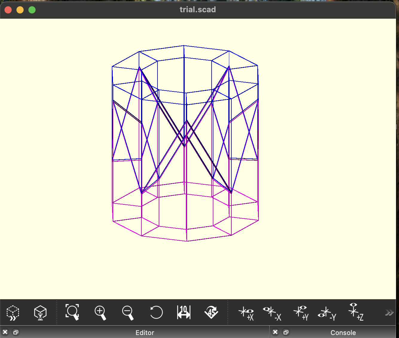

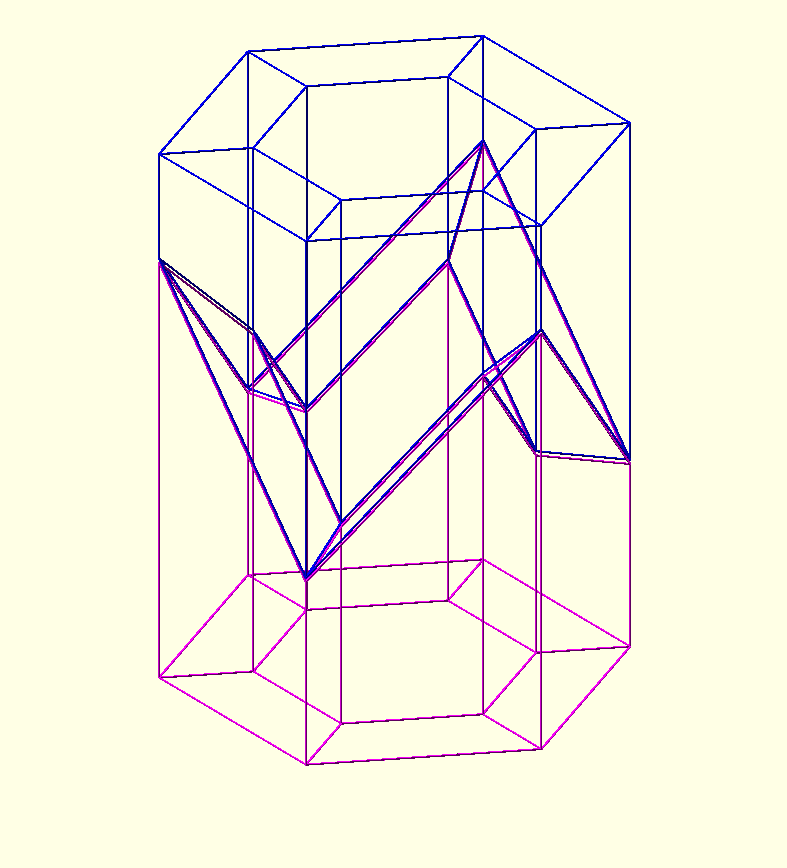

I am not sure what is the method used to model the coupling.
The method I used did not have any such issues at teeth up to 3 (a video of
the same was also posted here), below that I think it is not relevant.
attached here is the wire model for 3 , 4 and 5 teeth with just 1 mm gap
and it can be seen that the gap is consistent. Also I am not sure if these
low teeth models are of any use in real life.
The method I used needs functions to project a surface onto another, which
might be more clear from the posted video.
[image: Screenshot 2024-11-03 at 8.53.56 PM.png]
[image: Screenshot 2024-11-03 at 8.41.08 PM.png]
required.

On Sun, Nov 3, 2024 at 10:25 AM Sanjeev Prabhakar sprabhakar2006@gmail.com
of the same was also posted here), below that I think it is not relevant.
which might be more clear from the posted video.
