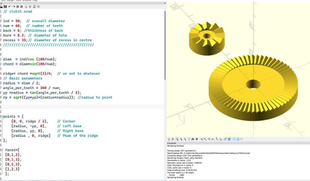

I modified my previous code, to reproduce the recess and centre hole.
These items were simple to make before the advent of cnc. If grinding, a
simple link between the traverse and spindle height and a rotary table,
with correctly profiled wheel. The crest of the ridges could be skimmed
off, so they didn't bottom out. As they are meant to be a solid joint,
although separation available, they can have simpler design requirements
compared to gear wheels.
I may print a couple, see what torque they can take, compared to say,
flat solvent welded joints.

I modified my previous code, to reproduce the recess and centre hole. These items were simple to make before the advent of cnc. If grinding, a simple link between the traverse and spindle height and a rotary table, with correctly profiled wheel. The crest of the ridges could be skimmed off, so they didn't bottom out. As they are meant to be a solid joint,  although separation available, they can have simpler design requirements compared to gear wheels. I may print a couple, see what torque they can take, compared to say, flat solvent welded joints. On 01/11/2024 18:59, John David via Discuss wrote: > Ummmm... Hirth Joint <https://en.wikipedia.org/wiki/Hirth_joint> That > said, maybe because you used "joints" threw it as they are singular.  > Hope this helps. > > On Fri, Nov 1, 2024 at 12:20 AM Sanjeev Prabhakar via Discuss > <discuss@lists.openscad.org> wrote: > > There was a little issue in the previous code i sent: > here is the corrected one: > > from openscad2 import * > > # hirth coupling > n=20 # number of teeths > ta=60 # teeth angle > ca=10 # for straight 360/42.232 # cone angle > i_r=30 # inner radius > o_r=100 # outer radius > ch=.5 # chamfer height > l1=[[i_r,0],[o_r,0]] > l2=[ q_rot([f'z{i}'],l1)  for i in linspace(0,360,n+1)[:-1]] > > l3=axis_rot_1(l1,ax1=[0,1,0],loc1=[o_r,0],theta=ca) > l3= line2length(flip(line2length(l3,(o_r-i_r)+5)),(o_r-i_r)+10) > cone1=[ q_rot([f'z{i}'],l3) for i in linspace(0,360,n)] > l2=psos(cone1,l2,[0,0,1]) > l1=[l2[0][0],l2[1][0]] > d1=l_len(l1)/2/cos(d2r(ta)) > l1=axis_rot_1(l1,line_as_axis(l2[0]),l2[0][0],ta) > l1=line2length(l1,d1) > l3=[l2[0][1],l2[1][1]] > d2=l_len(l3)/2/cos(d2r(ta)) > l3=axis_rot_1(l3,line_as_axis(l2[0]),l2[0][1],ta) > l3=line2length(l3,d2) > l4=[l1[1],l3[1]] > # a,b=l4 > l4=line2length(flip(line2length(l4,(o_r-i_r)+5)),(o_r-i_r)+10) > cone2=[ q_rot([f'z{i}'],l4) for i in linspace(0,360,n)] > l3=psos(cone2,l2,[0,0,1]) > l3=q_rot([f'z{360/n/2}'],l3) > s1=l_(a_([l2,l3]).transpose(1,0,2,3).reshape(n*2,2,3)) > s1=s1+[s1[0]] > s1=l_(a_(s1).transpose(1,0,2)) > sol1=flip(surf_base(s1,s1[0][1][2]+10)) > s2=l_(a_(cone1).transpose(1,0,2)) > s2=surface_offset(s2,-ch) > sol2=surf_base(s2,s1[1][0][2]-10) > sol2=sol2+[sol2[0]] > sol3=surf_base(flip(s1),s1[1][0][2]-10) > s3=q_rot(['z5'],l_(a_(cone2[:-1]).transpose(1,0,2))) > s3=surface_offset(s3,ch) > sol4=surf_base(s3,s1[0][1][2]+10) > sol4=sol4+[sol4[0]] > with open('trial.scad','w+') as f: >     f.write(f''' > >     translate([0,0,25]) >    // color([.13,.81,.37]) >     difference(){{ >     {swp_c(sol1)} >     {swp_c(sol2)} >     }} > difference(){{ >    {swp_c(sol3)} >    {swp_c(sol4)} >    }} > >     ''') > > On Fri, 1 Nov 2024 at 09:12, Jordan Brown via Discuss > <discuss@lists.openscad.org> wrote: > > > > > Unfortunately, you cannot raise the cone by _conic + > _chamferHeight. The chamfer must (should?) radiate from the > “origin” just like the ridge and grooves. I believe your code > as written takes a constant chamfer off the teeth, but at the > inner radius, that’s too much. > > Indeed, I missed that subtlety. Sorry.  Your fix looks right. > _______________________________________________ > OpenSCAD mailing list > To unsubscribe send an email to discuss-leave@lists.openscad.org > > _______________________________________________ > OpenSCAD mailing list > To unsubscribe send an email to discuss-leave@lists.openscad.org > > > _______________________________________________ > OpenSCAD mailing list > To unsubscribe send an email todiscuss-leave@lists.openscad.org

I'm not sure what you are suggesting with the "ummm" and the reference to a
remarkably short and unhelpful wikipedia entry, that gives absolutely no
information on how you might design one, doesn't mention the conical
version, doesn't talk about the basic parameters of the joint.  Basically
useless.
In ongoing fiddling with my code I've found that this is remarkably tricky
to get right.  My version looked OK with lots of teeth but at low teeth
count, the errors became apparent.  Bob's version works even at low teeth
count, at least in terms of producing a proper mesh between the parts.
