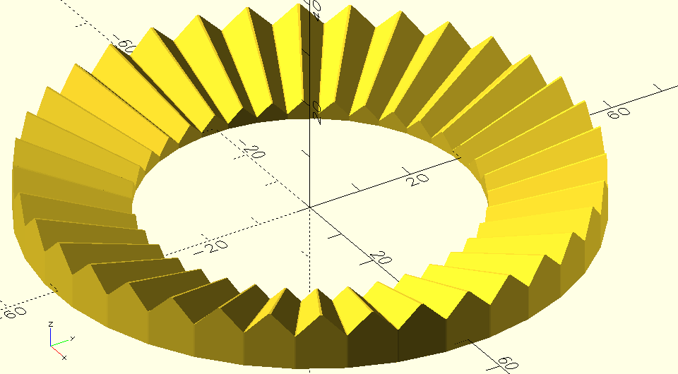

So Bob, you have said you don't care about speed, which is your choice,
obviously.  But for me this code is intolerably slow.  Preview is useless
even after I remove the chamfering and intersection to make it have
cylindrical edges.  And render takes 20s with manifold.  Because the
original code was unpreviewable I couldn't easily assess how well my
rewrite matched, but it previews instantly and renders in 0.1s.  (Note: a
reason I care about preview is that I can color things that I overlay to
see for example if two things match.)

The second is that I think your code measures tooth angle relative to the
vertical instead of relative to the tooth ridge.  This is not the normal
way that tooth angle would be measured, e.g. on a gear.  It means that
actual angle is never what you specify.
A third observation is that you should be chamfering the valleys just like
the peaks.  Internal corners are stress concentration points on an object
and will weaken it.  So my version can apply varying chamfers in both
places.
I personally find the rewritten code simpler than the original, as well as
much faster, and there's probably room to clean it up more.  (Could
probably compute inner shape from outer with a scale() computation for
example.)  It does produce a polygonal result and could be intersected
with a tube like the original to fix that if you think it's necessary.  I
imagine that one intersection wouldn't be a major drag on the speed.  I
agree that trying to compute the profile on a circular arc would be a
pain.
// Number of Teeth
_n = 36;          // Number Of Teeth
// Inner Radius
_ir = 30;
// Outer Radius
_or = 50;
// Is the coupling conical?
_conic = 15;
// Tooth Profile Angle
_profile = 90; // [60, 90]
// Percentage of tooth height
_chamfer = 5; // Default 5%
_base = 1;
function basic_profile(angle,chamfer_top, chamfer_bot) =
let(
width = tan(angle/2),
pts = [
[0,(-1+chamfer_bot)width,chamfer_bot],
[0,-chamfer_top
width,1-chamfer_top]
concat(pts, reverse(yflip(pts)));
profwidth = tan(_profile/2);
outside = _ortan(180/_n);
inside = _ir
tan(180/_n);
prof_out = right(_or,scale(outside/profwidth,basic_profile(_profile,
_chamfer/100, _chamfer/200)));
prof_in = right(_ir,scale(inside/profwidth,basic_profile(_profile,
offset = (_or-_ir) * tan(_conic);
outfull = up(offset,[for(i=lerpn(0,360,_n,endpoint=false))
each zrot(i,prof_out)]);
infull = [for(i=lerpn(0,360,_n,endpoint=false))
each zrot(i,prof_in)];
inbot = [for(val=infull) [val.x,val.y,-_base]];
outbot = [for(val=outfull) [val.x,val.y,-_base]];
vnf_polyhedron(vnf_vertex_array([outfull, infull, inbot, outbot],
reverse=true, col_wrap=true, row_wrap=true));

<image.png>
The current code renders 1 part in about 0.25 s, so I doubt you would have much problem with the current performance. As it happens, I switched to using _name's in the code because I will be offering it for inclusion in BOSL2. It’s also good for use in my own library if that’s where it stays. I have full attachability working now and the output looks very good. The valleys are chamfered too, at 50% of the ridge chamfer size so a proper gap is left when the parts are together. If you look closely you can see it in the demo code too. There are 3 angles I calculate. Tooth Angle is the angle between teeth radially. It’s simple, 360/N. The other two are the groove angle and ridge angle. These are calculated relative to horizontal. In a flat hirth joint, they are plus and minus the same number. In a conical joint, it’s different, but still measured relative to the XY plane. When I use them in the code I believe it’s always in a call to a spherical transform. In those calls 0 degrees is vertical, so I have to add 90. Adding the “bases” and getting the chamfers right in the conical cases was REALLY tricky. It’s the conical parts that cause all the problems. You should see the finished code in an enhancement request to BOSL2 in a few days. -Bob > On Oct 28, 2024, at 21:35, Adrian Mariano <avm4@cornell.edu> wrote: > > So Bob, you have said you don't care about speed, which is your choice, obviously. But for me this code is intolerably slow. Preview is useless even after I remove the chamfering and intersection to make it have cylindrical edges. And render takes 20s with manifold. Because the original code was unpreviewable I couldn't easily assess how well my rewrite matched, but it previews instantly and renders in 0.1s. (Note: a reason I care about preview is that I can color things that I overlay to see for example if two things match.) > > Another few things. In BOSL2, global variables that start with underscore are reserved for BOSL2 internal use, so you shouldn't be using those. You could clobber an internal definition. (Not sure why anyone would use variables that start with underscore as a choice---I find them very annoying.) > > The second is that I think your code measures tooth angle relative to the vertical instead of relative to the tooth ridge. This is not the normal way that tooth angle would be measured, e.g. on a gear. It means that actual angle is never what you specify. > > A third observation is that you should be chamfering the valleys just like the peaks. Internal corners are stress concentration points on an object and will weaken it. So my version can apply varying chamfers in both places. > > I personally find the rewritten code simpler than the original, as well as much faster, and there's probably room to clean it up more. (Could probably compute inner shape from outer with a scale() computation for example.) It does produce a polygonal result and could be intersected with a tube like the original to fix that if you think it's necessary. I imagine that one intersection wouldn't be a major drag on the speed. I agree that trying to compute the profile on a circular arc would be a pain. > > include <BOSL2/std.scad> > > // Number of Teeth > _n = 36; // Number Of Teeth > > // Inner Radius > _ir = 30; > // Outer Radius > _or = 50; > // Is the coupling conical? > _conic = 15; > // Tooth Profile Angle > _profile = 90; // [60, 90] > // Percentage of tooth height > _chamfer = 5; // Default 5% > _base = 1; > > function basic_profile(angle,chamfer_top, chamfer_bot) = > let( > width = tan(angle/2), > pts = [ > [0,(-1+chamfer_bot)*width,chamfer_bot], > [0,-chamfer_top*width,1-chamfer_top] > ], > ) > concat(pts, reverse(yflip(pts))); > > profwidth = tan(_profile/2); > outside = _or*tan(180/_n); > inside = _ir*tan(180/_n); > > prof_out = right(_or,scale(outside/profwidth,basic_profile(_profile, _chamfer/100, _chamfer/200))); > prof_in = right(_ir,scale(inside/profwidth,basic_profile(_profile, _chamfer/100, _chamfer/200))); > > offset = (_or-_ir) * tan(_conic); > > outfull = up(offset,[for(i=lerpn(0,360,_n,endpoint=false)) > each zrot(i,prof_out)]); > infull = [for(i=lerpn(0,360,_n,endpoint=false)) > each zrot(i,prof_in)]; > > inbot = [for(val=infull) [val.x,val.y,-_base]]; > outbot = [for(val=outfull) [val.x,val.y,-_base]]; > > vnf_polyhedron(vnf_vertex_array([outfull, infull, inbot, outbot], reverse=true, col_wrap=true, row_wrap=true)); > > <image.png> > > > > >

-Bob
very annoying.)
both places.

The only angles that really are needed to make this are the angle of the teeth and one additional angle, the angle of the ridge line or the tooth base (including any conical angle). I'm not sure how that angle is best defined. Maybe it's different for the two halves of the joint? Computing a bunch of other angles does not appear to be necessary, though maybe for figuring out how to adjust the tooth angle you need an extra computation. I think the tooth angle *should* be defined relative to the top line of the teeth (ridge line?), but your code defines it relative to absolute vertical, so as you change the conical angle the tooth angle changes. And if the conical angle is zero the tooth angle is not the specified angle. At least that appeared to be the case with the version you posted. When you organize the computation the way I did in my posted example the chamfers are trivial regardless of the angle of anything, though if you want to get the tooth angle relative to the ridge line some care is required. Did you look at how I did it? Using roundings instead of chamfers might be nice too, especially for joints at larger scale. I guess another question is whether chamfers should be absolute values rather than proportional to tooth size. In BOSL2 the undercores are used only for private globals, and all the global variables you have should actually be parameters in a library implementation. I mean, there's no harm in using underscores internally; I just find them annoying and hard to read. One reason to use them for internals is that nobody in their right mind would CHOOSE to prefix their variables with them. :) How fast does your existing code preview? Because the preview performance of the code I tried made preview unusable, even when I removed the chamfers and intersection with the tube. I assumed this was the result of having 36 objects unioned together, though even so it seemed oddly sluggish. I also noticed that intersecting with a tube produces a potential issue: the $fn for the tube needs to be a multiple of the tooth count, or the result looks funny. The Hirth joint looks interesting and useful so I think we'll get it into BOSL2 one way or another. Do you use this joint by gluing at the joint? Or by holding parts captive somehow so that shafts are locked at the joint? On Wed, Oct 30, 2024 at 9:52 PM Bob Carlson <bob@rjcarlson.com> wrote: > The current code renders 1 part in about 0.25 s, so I doubt you would have > much problem with the current performance. > > As it happens, I switched to using _name's in the code because I will be > offering it for inclusion in BOSL2. It’s also good for use in my own > library if that’s where it stays. I have full attachability working now and > the output looks very good. > > The valleys are chamfered too, at 50% of the ridge chamfer size so a > proper gap is left when the parts are together. If you look closely you can > see it in the demo code too. > > There are 3 angles I calculate. Tooth Angle is the angle between teeth > radially. It’s simple, 360/N. The other two are the groove angle and ridge > angle. These are calculated relative to horizontal. In a flat hirth joint, > they are plus and minus the same number. In a conical joint, it’s > different, but still measured relative to the XY plane. When I use them in > the code I believe it’s always in a call to a spherical transform. In those > calls 0 degrees is vertical, so I have to add 90. > > Adding the “bases” and getting the chamfers right in the conical cases was > REALLY tricky. It’s the conical parts that cause all the problems. > > You should see the finished code in an enhancement request to BOSL2 in a > few days. > > -Bob > > > On Oct 28, 2024, at 21:35, Adrian Mariano <avm4@cornell.edu> wrote: > > > > So Bob, you have said you don't care about speed, which is your choice, > obviously. But for me this code is intolerably slow. Preview is useless > even after I remove the chamfering and intersection to make it have > cylindrical edges. And render takes 20s with manifold. Because the > original code was unpreviewable I couldn't easily assess how well my > rewrite matched, but it previews instantly and renders in 0.1s. (Note: a > reason I care about preview is that I can color things that I overlay to > see for example if two things match.) > > > > Another few things. In BOSL2, global variables that start with > underscore are reserved for BOSL2 internal use, so you shouldn't be using > those. You could clobber an internal definition. (Not sure why anyone > would use variables that start with underscore as a choice---I find them > very annoying.) > > > > The second is that I think your code measures tooth angle relative to > the vertical instead of relative to the tooth ridge. This is not the > normal way that tooth angle would be measured, e.g. on a gear. It means > that actual angle is never what you specify. > > > > A third observation is that you should be chamfering the valleys just > like the peaks. Internal corners are stress concentration points on an > object and will weaken it. So my version can apply varying chamfers in > both places. > > > > I personally find the rewritten code simpler than the original, as well > as much faster, and there's probably room to clean it up more. (Could > probably compute inner shape from outer with a scale() computation for > example.) It does produce a polygonal result and could be intersected > with a tube like the original to fix that if you think it's necessary. I > imagine that one intersection wouldn't be a major drag on the speed. I > agree that trying to compute the profile on a circular arc would be a pain. > > > > include <BOSL2/std.scad> > > > > // Number of Teeth > > _n = 36; // Number Of Teeth > > > > // Inner Radius > > _ir = 30; > > // Outer Radius > > _or = 50; > > // Is the coupling conical? > > _conic = 15; > > // Tooth Profile Angle > > _profile = 90; // [60, 90] > > // Percentage of tooth height > > _chamfer = 5; // Default 5% > > _base = 1; > > > > function basic_profile(angle,chamfer_top, chamfer_bot) = > > let( > > width = tan(angle/2), > > pts = [ > > [0,(-1+chamfer_bot)*width,chamfer_bot], > > [0,-chamfer_top*width,1-chamfer_top] > > ], > > ) > > concat(pts, reverse(yflip(pts))); > > > > profwidth = tan(_profile/2); > > outside = _or*tan(180/_n); > > inside = _ir*tan(180/_n); > > > > prof_out = right(_or,scale(outside/profwidth,basic_profile(_profile, > _chamfer/100, _chamfer/200))); > > prof_in = right(_ir,scale(inside/profwidth,basic_profile(_profile, > _chamfer/100, _chamfer/200))); > > > > offset = (_or-_ir) * tan(_conic); > > > > outfull = up(offset,[for(i=lerpn(0,360,_n,endpoint=false)) > > each zrot(i,prof_out)]); > > infull = [for(i=lerpn(0,360,_n,endpoint=false)) > > each zrot(i,prof_in)]; > > > > inbot = [for(val=infull) [val.x,val.y,-_base]]; > > outbot = [for(val=outfull) [val.x,val.y,-_base]]; > > > > vnf_polyhedron(vnf_vertex_array([outfull, infull, inbot, outbot], > reverse=true, col_wrap=true, row_wrap=true)); > > > > <image.png> > > > > > > > > > > > >
mikeonenine (at) web.de
Thu, Oct 31, 2024 4:02 AM
Adrian Mariano wrote:
I think the tooth angle should be defined relative to the top line
specified
posted.
different, but

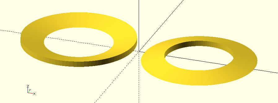

An anticone needs rotate_extrude?
$fn=100;
//Cone:
translate([-110, 0, 0])
rotate_extrude()
polygon([
[60, 0],
[60, 10],
[100, 0],
[100, 0],
//Anticone:
translate([110, 0, 0])
rotate_extrude()
polygon([
[60, 0],
[60, 0],
[100, 10],
[100, 0],
Jordan Brown wrote: > On 10/30/2024 6:33 PM, Bob Carlson wrote: > > > > On Oct 26, 2024, at 16:21, Jordan Brown > > > [openscad@jordan.maileater.net](mailto:openscad@jordan.maileater.net) wrote: > > > > > > Also, a tidbit:  _chamferF() generates a conical figure that might as > > > well be a cone.   > > >     up(_conic + _chamferHeight) scale(1.5) zcyl(h = _toothHeight/2 + _conic, r1 = _or, r2 = 0, anchor=TOP); > > > Since it's anchored at the top, I didn't have to fiddle with making > > > sure that it was slightly larger than the thing it's cutting from and > > > could just scale it up a bit. > > > > When I tried switching to a cone rather than rotate_extrude, the > > rendering time went up by about 50% (roughly a quarter second to .4 > > seconds). So, I’ve kept the current code. > > My gut reaction was that they should be almost identical, but then I > realized that I don't know how rotate_extrude decides how many sides to > put on an object.  Without looking at the sources, it looks like it > probably looks at the maximum X value to determine the radius and then > uses $fa/$fs/$fn as usual.  I would look at how many sides each is > ending up with, and why. > > But a rotate_extrude of a triangle with one side on the Y axis produces > a cone, and if you put the top point of the triangle at \[0,0\] then > you'll get the same effect I wanted - scaling it up leaves the top part > all the same. An anticone needs rotate_extrude? `$fn=100;` `//Cone:` `translate([-110, 0, 0])` `rotate_extrude()` `polygon([` `[60, 0],` `[60, 10],` `[100, 0],` `[100, 0],` `]);` `//Anticone:` `translate([110, 0, 0])` `rotate_extrude()` `polygon([` `[60, 0],` `[60, 0],` `[100, 10],` `[100, 0],` `]);`
Thu, Oct 31, 2024 6:58 AM
I wouldn't call either of those shapes cones; I would call the first a
cylinder from which a point-down cone has been subtracted, and the
second a point-up cone from which a cylinder has been subtracted.
You could build either of them with rotate_extrude(), as you have, or
you could build them as the differences above.  Which is "best" probably
depends on whether what you have convenient is the coordinates of the
inner edge, or the coordinates of the point of the cone.
I'd give you difference-between-cone-and-cylinder examples, but I don't
have the coordinates of the point of the cone handy.  I'd have to
extrapolate from the upper side of the triangles.  That's not hard, but
it's midnight and I don't wanna :-)
