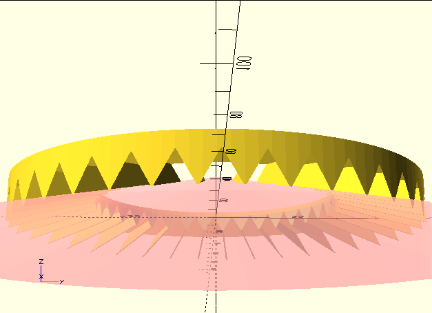

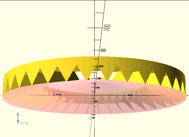

Jordan Brown wrote:
On 10/30/2024 10:32 PM, Caddiy via Discuss wrote:
An anticone needs rotate_extrude?
You could build either of them with rotate_extrude(), as you have, or
you could build them as the differences above.  Which is "best" probably
depends on whether what you have convenient is the coordinates of the
inner edge, or the coordinates of the point of the cone.
What you have is the height by which you have raised or lowered the spline polygon (+10 for example here), an inside radius (60) and an outside radius (100). The angle would be arctan 10 / (100-60) if that was of interest, but I think it would be easier to deal with linear measurements. To get the anticone from the cone, just swap the coordinates around a bit.
In the code above, two of the coordinates are the same, giving 4 coordinates for a triangle, which is one more than is required to define a triangle, as I originally had in mind to extend the base, but changed my mind and forgot to remove the extra coordinate. To cut a long story short, a polygon can give you the filler-cone plus a bit more in one piece, which a primitive cone can’t.
See, and be amazed:

On 10/31/2024 4:22 AM, nop head via Discuss wrote:
I think cylinder already does that. If you specify two radii you get a
frustum. I can't remember if zero is allowed for a cone.
Yes, and yes.
Sort of.  It depends on what your requirements are for the "plus a bit
more".
If your cone is anchored at the top, scaling it up will expand it at the
base without changing the shape of the top.
This is easy to demonstrate with BOSL2, because you can natively anchor
at the top:
s = 1;
scale(s) zcyl(r1=10, r2=0, h=10, anchor=TOP);
as you change s, observe that the top portion of the cone stays the same.
It's a tiny bit more complex in base OpenSCAD because base OpenSCAD
cylinders are anchored at their bottoms or centers.
s = 1;
h = 10;
scale(s) translate([0,0,-h]) cylinder(r1=10, r2=0, h=h);
(Though you can demonstrate it with an upside-down cone without needing
a translate().)
It even retains the same number of sides as it grows, because cylinder()
decides on the number of sides when it creates the object, and scale()
doesn't affect that choice.
In the particular case that this came from, the user was already using
BOSL2, and it happened that the top of the cone was easy to know, and
that since it was cutting away past the bottom of the object the shape
of the "extra" didn't matter.  Net, that negative object could be a
straightforward cone anchored at its top.

On 10/31/2024 12:36 PM, Caddiy via Discuss wrote:
A conical face spline joint will need two different cones as fillers
to get a flat face at the back of each piece. One piece, with luck or
by design, may already have a flat face, or it may even be conical,
requiring a negative/hollow cone, that I’m calling an anticone, to get
a flat face. But neither a primitive cone nor a BOSL2 cone can handle
a negative “h”.
I don't know beans about a conical face spline joint, and am having a
hard time following your description.
I just know that the OP's model had teeth with bottoms that touched a
cone, that needed to have the bottom little bit differenced off.  The OP
did this using a rotate-extruded triangle, when a plain old cone would
work fine and be simpler.
OP's solution:

    pts = [[0, _conic],
           [_or+tiny, A],
           [_or+tiny, B]];
    #rotate_extrude(angle = 360)
    polygon(pts);
Note:  that's a "hollow" cone.
Simpler solution:
module _chamferF() {
#up(_conic + _chamferHeight)
scale(1.5)
zcyl(h = _toothHeight/2 + _conic, r1 = _or, r2 = 0, anchor=TOP);
Sort of.  It depends on what your requirements are for the "plus a bit more".
If your cone is anchored at the top, scaling it up will expand it at the base without changing the shape of the top.
This is easy to demonstrate with BOSL2, because you can natively anchor at the top:
s = 1;
It's a tiny bit more complex in base OpenSCAD because base OpenSCAD cylinders are anchored at their bottoms or centers.
s = 1;
h = 10;
(Though you can demonstrate it with an upside-down cone without needing a translate().)
It even retains the same number of sides as it grows, because cylinder() decides on the number of sides when it creates the object, and scale() doesn't affect that choice.
In the particular case that this came from, the user was already using BOSL2, and it happened that the top of the cone was easy to know, and that since it was cutting away past the bottom of the object the shape of the "extra" didn't matter.  Net, that negative object could be a straightforward cone anchored at its top.
A conical face spline joint will need two different cones as fillers to get a flat face at the back of each piece. One piece, with luck or by design, may already have a flat face, or it may even be conical, requiring a negative/hollow cone, that I’m calling an anticone, to get a flat face. But neither a primitive cone nor a BOSL2 cone can handle a negative “h”.
A polygon can. (The polygon is then rotate-extruded to form the desired anticone.)
more".
the top:
s = 1;
s = 1;
h = 10;
translate().)
anticone.)
