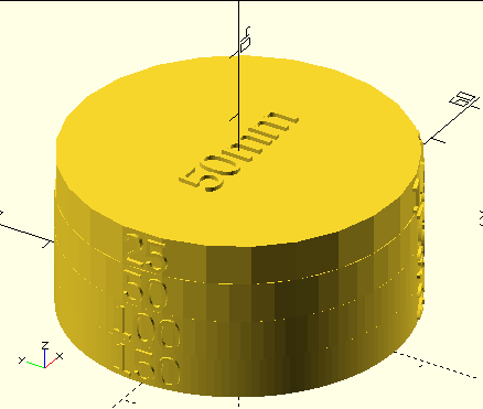

On 10/27/2024 5:36 PM, Bob Carlson wrote:
What you can see on the screen is very different from what you can see in plastic.  Try some test prints.
Of course, I still like it to look nice and performance isn’t an issue.
Indeed, with Manifold performance is less of an issue than it once was.
But remember that spheres have a complexity that is the square of the
number of sides, so it can get unreasonable pretty fast.
I took my own advice, and did some test prints.  I'd done some in the
past, but not very systematically.
I made three cylinders, each with several vertical sections with
different numbers of sides.  One disk is 100mm in diameter, one 50mm,
and one 25mm. The two smaller ones have 25, 50, 100, and 150 sides; the
larger one has 50, 100, 150, and 300 sides.  (I've enclosed the program
below, for those who might want to duplicate the experiment.)

I've color-coded them red for obvious artifacts, yellow for subtle
artifacts, and green for no visible or feel-able artifacts.  Of course,
that's subjective, but it might give you an idea.
(For those who for whatever reason can't see the colors:  for the 25mm
cylinder the 25 is red and the rest are green. For the 50mm cylinder the
25 is red, 50 is yellow, and larger are green.  For the 100mm cylinder,
50 is red and the others are green.)
I should probably do additional samples for larger and smaller
cylinders, but this is still interesting.
I was interested to see that the 50-gon was OK at a smaller size, but
increasingly bad as the size increased.  My intuition was that past some
size more sides doesn't help, because the angle between the sides is
what you'd perceive, but I don't seem to have found that size yet.
100mm isn't the largest circle I can print, and of course I can print
arcs that are arbitrarily large diameter, but this suggests that $fa=3
or so is good enough for most things, and that $fs doesn't need to be
less than about 1.  $fa might need to be smaller for still-larger
circles, and $fs might need to be smaller for smaller circles.
Here's what the test cylinders look like:
Here's the test program:
cylinder the 25 is red and the rest are green. For the 50mm cylinder the 25
is red, 50 is yellow, and larger are green.  For the 100mm cylinder, 50 is
I should probably do additional samples for larger and smaller cylinders,
size more sides doesn't help, because the angle between the sides is what
100mm isn't the largest circle I can print, and of course I can print arcs
that are arbitrarily large diameter, but this suggests that $fa=3 or so is
good enough for most things, and that $fs doesn't need to be less than
about 1.  $fa might need to be smaller for still-larger circles, and $fs
// For the text
$fa = 2;
$fs = 1;
sides = [ 150, 100, 50, 25 ];
layerT = 6;        // Thickness of each layer
d = 50;            // Diameter
textT = 0.4;        // Thickness of text on the side
topTextT = 0.6;    // Thickness of text on the top
topTextSize = 6;    // Size of text on the top
// Draw a label wrapped around the cylinder
module clabel(text) {
path = up(layerT/2, path3d(reverse(circle(d=d))));
path_text(path, text, size=layerT0.8, textmetrics=true, valign="center", h=textT2+2, offset=-1, center=true);
for (i=[0:len(sides)-1]) translate([0,0,ilayerT]) {
fn = sides[i];
zcyl(d=d, h=layerT, anchor=BOTTOM, $fn=fn);
rotate(0) clabel(str(fn));
rotate(120) clabel(str(round(360/fn
10)/10, "°"));
rotate(-120) clabel(str(round(PId/fn10)/10, "mm"));
up(len(sides)*layerT) text3d(str(d, "mm"), atype="ycenter", anchor=BOTTOM, h=topTextT, size=topTextSize);
