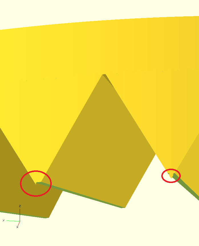

I notice that your _profileF() ends up generating an inside-out
polyhedron.  When viewed with View/Thrown Together, it's purple.  That
can cause problems for rendering.  (I'm a little surprised that it
didn't cause fatal problems.)  It looks like you can fix it by swapping
the second and third points in both tI and tO.
Another thing attracted my attention immediately.
Mostly, just don't use $fn except to create regular polygons.  Use $fs
and $fa; they are much less likely to lead you into silly settings.
You have $fn=16*360 = 5760.  Assuming that the units are millimeters,
the model is about 100mm in diameter, so its circumference is 314mm.
That means that each side is 0.05mm.  Those tiny sides, and the even
tinier artifacts that they might cause, might well be a key part of your
geometry problems.  My bet is that you could use fewer than 100 sides
and still be unable to see or feel the individual sides when you print
it.  And if you can see them, bump it up to 300 or 500, and you've still
got 10x fewer sides than your version does.
Preview is (at least for me) horribly laggy when you try to move it, and
it has what look like convexity artifacts.
Removing all of the settings for $fn and adding in a single global
setting for $fa=1 and $fs=1, and it previews fast and fixes the
Also, a tidbit:  _chamferF() generates a conical figure that might as
well be a cone.
    up(_conic + _chamferHeight) scale(1.5) zcyl(h = _toothHeight/2 + _conic, r1 = _or, r2 = 0, anchor=TOP);
Since it's anchored at the top, I didn't have to fiddle with making sure
that it was slightly larger than the thing it's cutting from and could
just scale it up a bit.
I think your technique is responsible for generating micro flaws at the
outside edges.
Note:  I first tried this mod while I happened to be running an OpenSCAD
from January.  With my changes, rendering failed with manifold errors.
When I switched to a recent build, it was OK again.  So if you're having
manifold problems, upgrade.
polyhedron.  When viewed with View/Thrown Together, it's purple.  That can
cause problems for rendering.  (I'm a little surprised that it didn't cause
fatal problems.)  It looks like you can fix it by swapping the second and
the model is about 100mm in diameter, so its circumference is 314mm.  That
means that each side is 0.05mm.  Those tiny sides, and the even tinier
artifacts that they might cause, might well be a key part of your geometry
problems.  My bet is that you could use fewer than 100 sides and still be
unable to see or feel the individual sides when you print it.  And if you
can see them, bump it up to 300 or 500, and you've still got 10x fewer
and it has what look like convexity artifacts.
setting for $fa=1 and $fs=1, and it previews fast and fixes the convexity
artifacts.
well be a cone.
sure that it was slightly larger than the thing it's cutting from and could
outside edges.
<YWbsxKvQ36n0OH8f.png>
OpenSCAD from January.  With my changes, rendering failed with manifold
errors.  When I switched to a recent build, it was OK again.  So if you're
having manifold problems, upgrade.

Excellent! Thanks! That fixed the problem! I still consider it a bug that OpenSCAD does not detect the problem. I’ll note that in the issue.
I’ll experiment with $fa and $fs. I tend to learn things when I have need for them. This just hadn’t come up before. And it’s why I’m on this email list.
