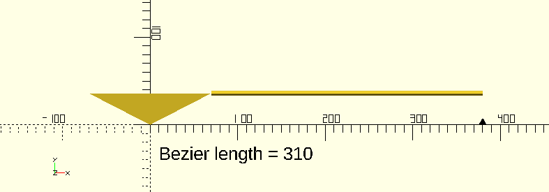

One end of the bezier is rigidly fixed to the triangle that rocks from side to side (x-direction), the other to a piston or plunger (not shown) that can slide back and forth in a cylinder.
But the fact that it's intuitively simple doesn't necessarily mean that
it's mathematically simple...
The outer end of the bezier has a sinusoidal correction, not mathematically perfect, but close as dammit.
Next I need to consider the rocking motion of the triangle in the z-direction, then combine the two.

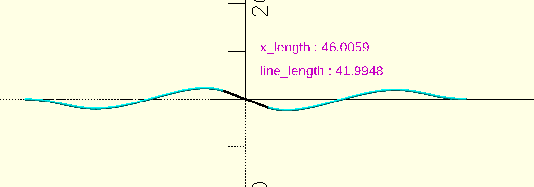

Maybe this comes closer[image: Screenshot 2026-04-20 at 8.18.59 AM.png]

Maybe this comes closer[image: Screenshot 2026-04-20 at 8.18.59 AM.png] On Mon, 20 Apr 2026 at 04:51, Caddiy via Discuss <discuss@lists.openscad.org> wrote: > Jordan Brown wrote: > > Thinking of it in physical reality... > > Have a long piece of (bendable) PVC pipe, connected at both ends to > (unbendable) iron pipe. Put the iron pipes in a track that allows them to > slide lengthwise, but not turn. Grab the PVC pipe in the middle, and twist > it, bending the PVC pipe into an S curve. > > The length of the PVC pipe stays the same, but the iron pipes get pulled > toward the center. > > That comes closest. > > One end of the bezier is rigidly fixed to the triangle that rocks from > side to side (x-direction), the other to a piston or plunger (not shown) > that can slide back and forth in a cylinder. > > But the fact that it's intuitively simple doesn't necessarily mean that > it's mathematically simple... > > The outer end of the bezier has a sinusoidal correction, not > mathematically perfect, but close as dammit. > > Next I need to consider the rocking motion of the triangle in the > z-direction, then combine the two. > > > _______________________________________________ > OpenSCAD mailing list > To unsubscribe send an email to discuss-leave@lists.openscad.org
mikeonenine (at) web.de
Mon, Apr 20, 2026 5:07 AM
How do you get all those numbers? Could be useful for complex 3D surfaces.
Nice constant-length bezier, but the code is beyond me!
It would be nice to be able to get the difference between the actual length of the bezier, and what it should be, and feed that as a correction back into the bezier. But I think it would make the computer go round and round in ever-decreasing circles.
However, it could be done with two identical beziers, a “real” one and a “dummy”.  The dummy calculates the correction and that is fed not back into the dummy but into the real bezier, using a function or whatever. I’m just wondering whether both beziers can be obtained from a single module, or whether the dummy would have to be cut and pasted from the real one. Is that mathematically permissible?
I’ll try it out tomorrow.

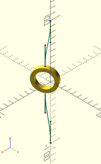

NVH is very close. I want to simulate the bending of a piston rod caused
by the (unintended) precession of the triangle in the animation. The
triangle represents one half of a type of crank. The precession can of
course be broken down into rocking motions along two axes. I have done
that, and beziers seem to provide an accurate representation of the
bending. Try it with a hacksaw blade! The problem here and now is that,
while the length of a hacksaw blade (or piston rod etc.) doesn’t change
when you bend it, beziers do - they get longer. In OpenSCAD this means that
parts can overlap or gaps can open and close. This should not be, and here
I am looking for a correction for it.
