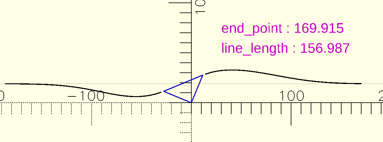

I calculate beziers of a specific length or minimum z value to model cable
strips for a 3D printer. The code is here:
https://github.com/nophead/NopSCADlib/blob/master/utils/bezier.scad.
The code is specific for U shaped curves but the technique could probably
be adapted for other shapes.
To get the length I just evaluate 100 points and sum the distances between
them.
To change the length I move the inner two control points up or down using
Newton Raphson.

revised one
Change in the length is negligible.
[image: Screenshot 2026-04-21 at 10.26.54 PM.png]
But it's not an openscad code. Hard coded openscad file attached
python code:
from openscad4 import *
a=arc(30,20,70)
b=rot2d(90,a)
center cam driving the piston rods, there are 21 positions defined
s1=[ [a[i],b[i],[0,0]] for i in range(len(a))]
defining control points for bezier "cp2" are control points and "cp3" is
bezier
cp1=[mirror_line(c23([a[i],b[i]]),c23(line_as_axis([a[i],b[i]])),a[i]+[0])
for i in range(len(s1))]
cp2=[p+[[100,19,0],[120,19,0],[200,19,0]] for p in cp1]
cp3=[ bezier(p,20) for p in cp2]
center line of cylinder
l1=[[-200,19],[200,19]]
length of the piston rod 157 (starts at 3 and ends at 160) with 51 points
l2=m_points1_o([[0,3],[0,160]],50)
super-imposing the line l2 over beziers
cp4=[ wrap_around(l2,p) for p in cp3]
same is repeated for the left side
cp5=[mirror_line(c23([b[i],a[i]]),c23(line_as_axis([a[i],b[i]])),b[i]+[0])
cp6=[p+[[-100,19,0],[-120,19,0],[-200,19,0]] for p in cp5]
cp7=[ bezier(p,20) for p in cp6]
cp8=[ wrap_around(l2,p) for p in cp7]
calculation for length and end point position
lx=[l_lenv_o(p) for p in cp4] # length of the rod
xv=[ p[-1][0] for p in cp4] # end point of the rod for 51 different
positions

Sanjeev Prabhakar wrote:
Maybe this comes closer[image: Screenshot 2026-04-20 at 8.18.59 AM.png]
How do you get all those numbers? Could be useful for complex 3D surfaces.
Nice constant-length bezier, but the code is beyond me!
It would be nice to be able to get the difference between the actual
length of the bezier, and what it should be, and feed that as a correction
back into the bezier. But I think it would make the computer go round and
round in ever-decreasing circles.
However, it could be done with two identical beziers, a “real” one and a
“dummy”. The dummy calculates the correction and that is fed not back into
the dummy but into the real bezier, using a function or whatever. I’m just
wondering whether both beziers can be obtained from a single module, or
whether the dummy would have to be cut and pasted from the real one. Is
that mathematically permissible?
I’ll try it out tomorrow.
