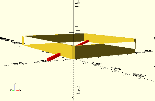

Why are the 2 F5 renderings so different?  This one show up with a solid object with no "holes" and the previous version has "holes" depending on how it is oriented.
Also the interior is green but on the first it is all yellow.

  1. As for the "holes" that show up in the preview, I do not know.  It may
    have something to do with the way that Raymond created his cut outs.  Try
    View -> Thrown Together to see all of the shapes used to create the cut
    outs.
  2. As for the color, Raymond's box is all yellow since he created it with a
    single linear_extrude.  Mine shows green since my box is created by
    subtracting one box from another bigger box.
There are many people here on the list who are much smarter than me and who
can probably explain these things better.  :-)

Wed, Jun 22, 2022 9:48 PM
Classic convexity artifacts.
  linear_extrude(height, convexity=2){
fixes it, though I usually set it to 10 or so to be safe.  (There's
basically no cost for a model this simple.  You have to have a very
complex model before there starts to be a real cost.)
Spaces on the sides of a subtracted-away object default to green.

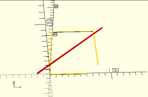

Wed, Jun 22, 2022 10:05 PM
https://en.wikibooks.org/wiki/OpenSCAD_User_Manual/Using_the_2D_Subsystem#Extrude_parameters_for_all_extrusion_modes
(Also applies to import, polyhedron, and a few others.)
Consider this simplified version of the key part of the model:
length = 80;
width = 110;
thick = 1.8;
gap = 20; //gap at corner
    offset(thick)
        square([length,width]);
    translate([length-gap,-2*thick])
        square(gap+(2*thick));
color("red")  translate([-20,0,0]) rotate(45)cube([170,2,2]);
Note that the red line crosses the figure twice.
If we linear extrude that figure without specifying convexity, and
difference away a little bit, we get this artifact-y view:
Basically, any sight line where the number of crossings is greater than
the specified convexity gets displayed wrong.

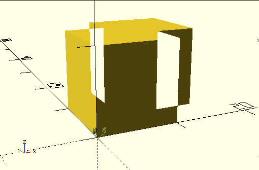

Here's another simple example to play with.
linear_extrude(height=10) {
square(10);
translate([5,5]) square(10);
cube(1);
(Also shows classic Z-fighting artifacts around the 1x1x1 cube
subtracted at the origin.)
