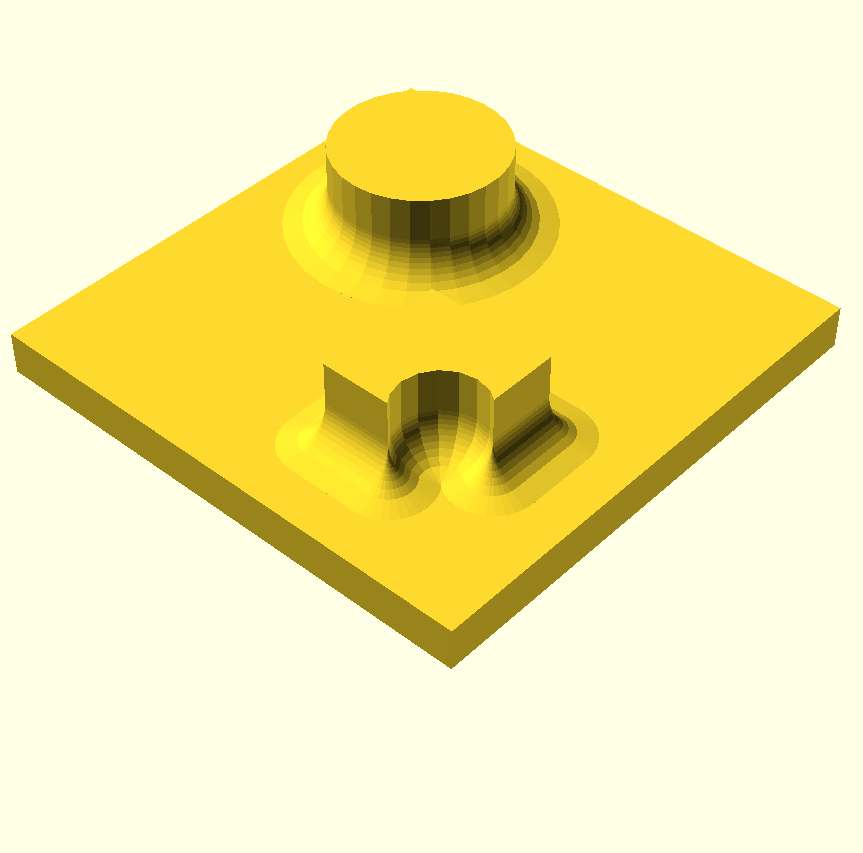

Hi All,
I'm trying to create an instruction to use an arbitrary 2D polygon to create
a fillet. It works fairly well when there are no internal angles, but I do
need it to handle internal angles.
If you take a look at the following, it should give an idea what I'm trying
to do and how:
STPS = 10;      //Number of steps to do the fillet over
RADS = 5;      //Radius of the fillet
translate([-30,-30,0])
cube([60,60,5]);
//This works fine
translate([12,12,5]) {
    ninteyDegFillet(RADS,STPS)
        circle(10);
    translate([0,0,RADS])
        linear_extrude(5)
            circle(10);
//This doesn't work quite like I hope (when I have hull turned on in the
fillet module)
translate([-20,-20,5]){
a_profile();
linear_extrude(5)
a_profile();
module a_profile(){
square(15);
translate([3,3,0])
circle(5);
module ninteyDegFillet(r,n) {
r - fllet radius
n - number of steps
s = r/n;                    //step size
for(i = [0:s:r]) {
//hull() {
translate([0,0,i-s])
linear_extrude(height = s)
offset(r = r-sqrt(pow(r,2) - pow((i-r),2)))
children(0);
translate([0,0,i])
offset(r = r-sqrt(pow(r,2) - pow((i+s-r),2)))
children(0);
translate([0,0,-s])
offset(r = r-sqrt(pow(r,2) - pow((-r),2)))
children(0);
I wanted to use the hull() to smooth things out, but perhaps there's a
better way to do this.
The parameters I would like to be able to do this within is by specifying a
2D profile and a radius.
on another note, is there a way to define 2, 2D profiles offset in some
direction and have them create a top and bottom to a 3D polygon?
Cheers,
Marno

Wed, Apr 27, 2016 7:45 AM
I think this does what you want but is very slow.
r - fllet radius
n - number of steps
function rad(x) = r - sqrt(pow(r,2) - pow(x - r, 2));
eps = 0.001;        // a little overlap between slices
for(i = [0 : s : r - s]) {
translate([0, 0, i])
minkowski() {
linear_extrude(height = eps)
cylinder(r1 = rad(i), r2 = rad(i + s), h = s, $fn = 32);
I think interpolating between two 2D shapes to make a 3D shape is known as
loft. It would be nice to have one in OpenScad.

marno11
Wed, Apr 27, 2016 1:37 PM
Thanks Nophead,
Very cool; so you are using minkowski to run a truncated cone around a
sliver of each 'profile step'.
I did want to try do this without using minkowski - but unless I or someone
can think of an alternative way (that works well) this is how I'll do it.
-Marno
